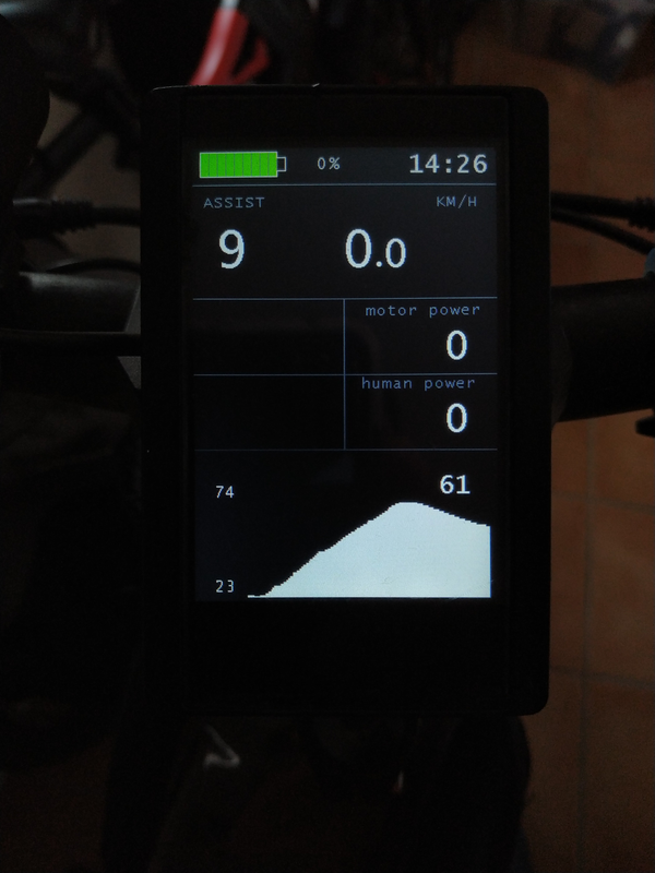

...but, here in Poland we are experiencing a heatwave and BOY DID IT GET HOT. Yes, I was riding it like I stole it, but after 10km the external black case was too hot to touch!
(40C at asphalt surface, coupled with all the heat coming from the inside, of course)
luckily, after 6hrs cooldown, all is good. but, I want to try my hand at cooling this beast down. My idea is to adapt a triple-fan waterblock from PC (corsair h150i) to go in direct contact with the internal motor shell (silver-looking one). for this, we would need to CNC a copper replacement for the stock, flat, copper rectangle supplied with the Corsair cooler.

The first time I did show the motor temperature graph on 850C LCD. It started at ambient temperature 23 degrees, it went to max of 74 degrees in about 7 minutes of motor power of 500 watts (graph time was set to 15 minutes). Then we can see the cool down (I stopped pedaling at at 70 degrees):

Post by LevelsAndMaps » Jun 26 2019 5:26am
thanks!
sensors on their way, looking forward to install them + upgrade to Brass gear.
after almost 100km on the bike, I find the throttle completely useless (for me)
this is by far, the best electrification option under 1000$.
is the 850C color display officially supported now?
