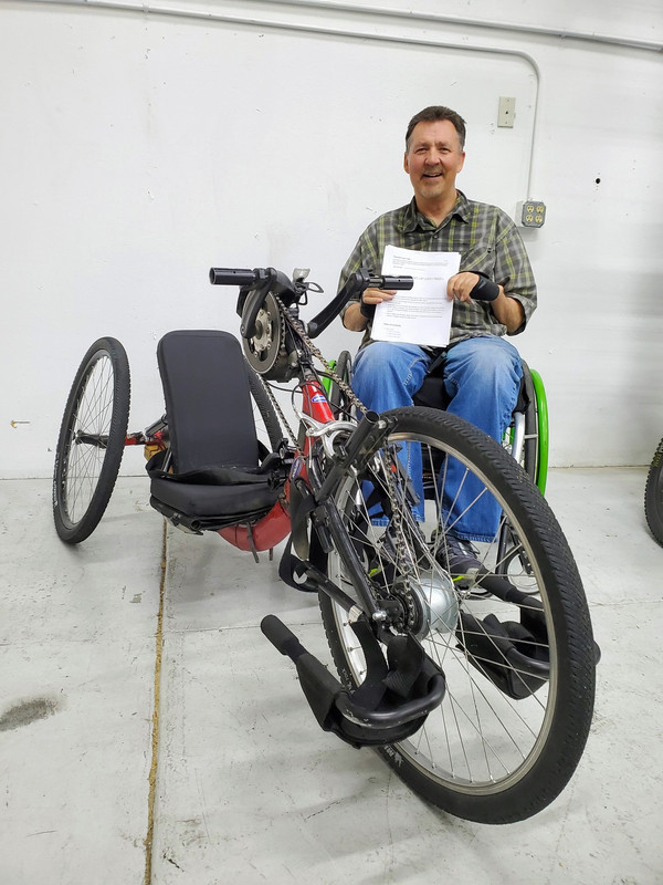

I am just sharing here because this is a very important break through:
quote=Rydon post_id=1487352 time=1565328969 user_id=50225
buba wrote:
Aug 08 2019 2:19pm
Alpha 3 is live!
Indeed it is! We just installed v0.20.0 alpha 3 on a friends coaster brake handcycle and it works!!! This is truly a turning point for powered handcycles. After celebratory yells and high fives, I took this picture of Jeff with the handcycle we installed it on. It's his bike.
We only tested it with 5 levels of power assist with the multiplier being simply 1 to 5. EMTB mode was set to 5. We will tweak it later but the initial test ride was awesome. We have yet to set up the advanced cadence sensor mode so there was a very slight delay for the motor to stop that was only noticeable in the higher levels. It was overall very smooth and responsive.
Thanks to Buba for a truly awesome release and to Casainho for providing the foundation. You guys are helping more people than you realize that will be able to once again do what they love. Also, a special thanks to Buba for supporting the coaster brake. Jeff can only ride a coaster brake since he is a quadriplegic with only partial use of his harms and no use of his hands. He pedals, steers and brakes with his arms all at the same time. He is super excited to ride this in an 80 mile mountain race in Park City, Utah next week.
/quote
