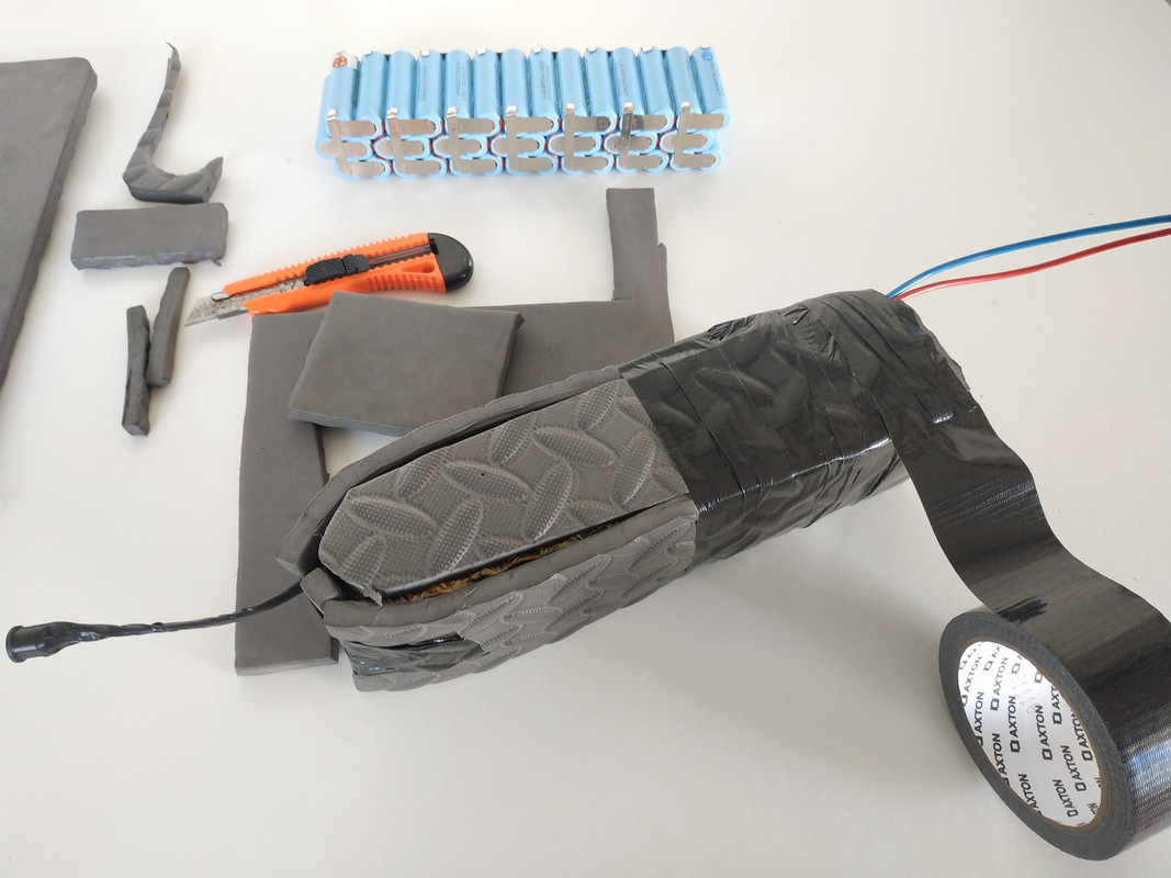

With TSDZ2 and our OpenSource knowledge and firmware, you have real numbers and not marketing BS.
Since you already drive an ebike, should be easy for you to compare and do your own math, here some numbers of TSDZ2:
- TSDZ2 should be run continuously pulling about 10 amps from the battery and if you decide to install the temperature sensor, then our firmware will automatically optimize and protect the motor and then you can pull any higher value from the 10 to 18 amps for shorts periods of time like 15 minutes that can be enough for a step hill or busy road where you want to go at max speed possible (I do like 45 km/h)
- our firmware does not limit the max speed, TSDZ2 can pull me over 55km/h on descends, where I am using 52T at front and 11T at rear on a MTB bicycle
- light MTB is really great with a TSDZ2, and you are light, my weight for instance if 105kgs. I love my light full suspension MTB running our OpenSource firmware, configured for fast response and with the torque sensor full calibrated, where it can measure linearly any weight value on the pedals from 1kg up to the 105 kgs of my weight :-)
See that TSDZ2 weight is about 3.6kgs and you can have battery pack of 500Wh with 2.4kg (14S3P of 3600mAh cells, the same I am using on my MTB), so, total of 6kg for TSDZ2 + 500Wh battery.
- TSDZ2 OpenSource firmware

Thanks Casainho.
What you achieved with the OSF is amazing, I will be happy to test it.
Where did you get that battery?
I can't find anything that small on ebay or aliexpress. And even for larger batteries equipped with 3600mAh cells, I am not sure if the sellers are reliable.
Perhaps you build it yourself, I remember having read someone building custom batteries, maybe it was you?

Yes, I had to pay for a local shop to build it.
The true is that on Ebay you will only find BIG and heavy battery packs. At the local shop, they build with the best cells on the market and let me choose them and the battery can have any shape I desire. I think is the only way to get a light bicycle.
Original message with pictures:
I am sharing pictures of the battery pack I built for using with TSDZ2.
I am using the most power density cells available on the market, the LG INR18650-M36 3600mAh - 10A.
Using this cells, my pack as 14S3P (14 cells in series and 3 cells in parallel) of 42 cells in total.
This pack has about 525 Wh and weighs only about 2.5 kgs (including the weight of BMS, connectors, etc). My girlfriend wants a light bicycle so I decided to use this cells/battery on his bicycle. Next I will do another for my bicycle and I will keep my older big packs (that use the same cells) to use when we do long rides like near or over 100 kms in a day.
I am using for the first time the chinese popular BMS with Bluetooth, the "Smart BMS with Bluetooth", that we can find in many online shops. This BMS would be very easy to develop firmware for if we want (used Arduino AVR microcontroller and popular battery management IC) but there is a lot of information about it, including the communication protocol.
I think I will need to limit on LCD3 the battery current to be 10 Amps, other way this cells may heat to much and damage quick but I will configure the BMS temperature sensors protection and I will keep a loop at the temperature to find the "max" average current for this cells in 3P.

That is a very nice build, this bike must be flying!
Unfortunately I don't think I can find a local shop that can make this kind of batteries.
Since the small batteries (e.g. bottle types) are 36V I may buy a 36V motor but I am still unclear about the supposed advantages of a 48V TSDZ2 over a 36V.
From what I read, the 48V has a bit more torque, heats less and is quieter.
That may be true with the stock firmware but it looks like that with the OSF there are not much differences at the end.
Also a lot people on the internet recommend using 48V motors in general but that may not apply to the TSDZ2.
Am I missing something that makes the 48V really better?
