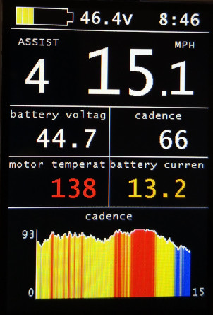

I am preparing a new version of firmware for 850C display. We can see the yellow and red zones on the graph as also the variables shown numerically on the 4 fields at the center, change the color from fading from regular white color to yellow and then to red.
For instance, the motor stops assisting at around cadence of 92 RPM, so on graph we can see that as also on the numeric field:
The motor temperature, on the yellow zone the motor power output is being limited and stops once it hits the red zone:
- TSDZ2 OpenSource firmware
