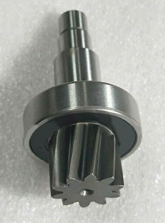

Retrorockit wrote:
Dec 09 2019 1:27pm
I doubt that the splined joint is what's slipping.
You are right, at the pictures I took from mine, the spline is perfect otherwise it would be easy seen.
Retrorockit wrote:
Dec 09 2019 1:27pm
IF the "bearing" is spinning in it's bore then that's a metal to metal seam, and bearing mount would fix it. But only if you pressed the bearing out of the splined sleeve and left the sleeve in the plastic gear. Then the Loctite would be going into a metal to metal situation. It's possible that the lubricant is getting too thick at low temperatures to allow the roller clutch to function properly. With a metal gear you would have a better choice of lubicants to use there.
So there is a clutch on this bearing? So this is a second clutch on a bearing on the TSDZ2... and I guess this one is for not making the motor rotating freely when we disable the motor, otherwise maybe it would rotate freely a bit more because the mass of the main gear??
I would like to know how this bearing/gear fixes/attaches to the pinion gear shaft... could the slipping be there and not on the bearing internals?
By the way, this issue happens to me with 15 degrees Celsius and even when the TSDZ2 has high temperature like 40 degrees inside. I am not sure this is a temperature related issue.
So, until it is clear what is really slipping, I updated the wiki with this solutions:
- exchange for a new blue gear
- exchange the roller clutch by gently removing the old one: this is possible if you can recycle a good one from an old blue gear
- TSDZ2 OpenSource firmware
Developer of OpenSource knowledge and technology for ebikes: Wireless Ebike boar ANT+ and Bluetooth, Flexible OpenSource firmware for EBikes: TSDZ2 mid drive motor, KT motor controllers and displays: Bafang 850C color, SW102 Bluetooth and KT-LCD3.
If you like my work, please consider making a donation to help my developments: paypal.me/jorgecasa
NexusG   100 mW
Posts: 46
Joined: Aug 06 2019 7:36am
Location: France
Post by NexusG » Dec 10 2019 4:41am
I don't think changing the entire blue gear is a good solution because the issue is likely to reappear
Note that I had the same problem with a metal gear and during a hot summer in Spain. It dissapear suddenly for a mysterious reason
If the slipping is between the sleeve and the clutch, I think glue (which one) is the only solution

Post by casainho » Dec 10 2019 5:06am
NexusG wrote:
Dec 10 2019 4:41am
I would like to understand what is the sleeve... I tried the translator but still I can understand.
There are only 2 parts here, the blue gear and the pinion gear (each of them costs about 16 euros on Aliexpress), and the problem seems to be in one of them. In my case, I exchanged the blue gear to a new one and the problem is solved (at least for now).
But yes, I would like to understand where is the slipping...
1. the blue gear
2. the pinion gear

Post by NexusG » Dec 10 2019 6:42am
From what I understood, the sleeve is the splined metallic part on the blue gear
The slipping issue is between this part and the hf1216 itself (exactly where the red arrow is pointing)
casainho   10 GW
Posts: 4700
Joined: Feb 14 2011 2:43pm
Post by casainho » Dec 10 2019 7:26am
NexusG wrote:
Dec 10 2019 6:42am
Then,
NexusG wrote:
Dec 10 2019 4:41am
I think it is a good idea to use a solution to keep the splined metallic part fixed to the bearing, just like it should be as original.
Also, changing for a new blue gear is a solution (up to when we still don't know). We don't know what triggers this issue, it can be something that suddenly blocked the chain wheel like what I think did happened in my case, and if so, changing for a new blue gear is a solution and also the glue, we still don't know for how long the glue will hold.
Well, I will keep the old blue gear with me, I may need it in future and I can buy easily locally flue to repair it. Buying for 15 euros the blue gear is nice but it can take up to 3 or 4 weeks to arrive to my home...

casainho wrote:
Dec 10 2019 5:06am
NexusG wrote:
Dec 10 2019 4:41am
1. the blue gear
There are 3 parts there. The plastic gear, and the splined ( toothed) metal sleeve which should remain part of it when taken a part. The HF1216 has an arrow on it to show which way it should drive or lock up. The arrow is right next to the red arrow. The roller clutch is a very cheap solution. It uses the shaft as an inner race. When the gear tries to turn against the arrow the rollers are wedged inwards against the shaft by ramps in the shell of the bearing. Failure could be either the rollers slipping on the shaft, the whole roller clutch turning in the gear ( less likely unless the machining is wrong), or the rollers staying in the free position when they shouldn't ( cold grease could do this). This clutch is there so the motor won't turn when you pedal with the power off. The one in the pedals is there so the pedals won't speed up when you use just the throttle. A roller sprag clutch would be the proper device there but it's bigger and more expensive. Instead of rollers it has clutches with a figure 8 profile and a spring that allows them to release one way , but gently pushes them to engage the other. Other sprags have ratcheting pawls than lock into notches but they're noisy. Ratchet wrenches use those. You can hear them in some MTB rear hubs. They never slip. You have to actually break something on those.
Retrorockit   100 W
Posts: 169
Joined: Feb 08 2019 12:07pm
Post by Retrorockit » Dec 10 2019 9:52pm
casainho wrote:
Dec 10 2019 5:06am
NexusG wrote:
Dec 10 2019 4:41am
1. the blue gear
There are 3 parts there. The plastic gear, and the splined ( toothed) metal sleeve which should remain part of it when taken a part. The HF1216 has an arrow on it to show which way it should drive or lock up. The arrow is right next to the red arrow. The roller clutch is a very cheap solution. It uses the shaft as an inner race. When the gear tries to turn against the arrow the rollers are wedged inwards against the shaft by ramps in the shell of the bearing. Failure could be either the rollers slipping on the shaft (perhaps the grease is too thick to move out of the way), the whole roller clutch turning in the gear ( less likely unless the machining is wrong), or the rollers staying in the free position when they shouldn't ( cold grease could do this). This clutch is there so the motor won't turn when you pedal with the power off. The one in the pedals is there so the pedals won't speed up when you use just the throttle. A roller sprag clutch would be the proper device there but it's bigger and more expensive. Instead of rollers it has clutches with a figure 8 profile and a spring that allows them to release one way , but gently pushes them to engage the other. They're used in automatic transmissions with very thin oil and almost never cause problems. Other sprags have ratcheting pawls than lock into notches but they're noisy. Ratchet wrenches use those. You can hear them in some MTB rear hubs. They never slip. You have to actually break something on those.
This is the sort of thing one would expect when you have a 350W motor making 750W.

casainho   10 GW
Posts: 4700
Post by casainho » Dec 11 2019 4:49am
Retrorockit wrote:
Dec 10 2019 9:31pm
You mean the shaft of pinion gear??
Retrorockit wrote:
Dec 10 2019 9:31pm
Good to know. Thanks.

NexusG   100 mW
Posts: 46
Location: France
Post by NexusG » Dec 11 2019 6:31am
Retrorockit wrote:
Dec 10 2019 9:52pm
casainho wrote:
Dec 10 2019 5:06am
NexusG wrote:
Dec 10 2019 4:41am
1. the blue gear
That's some interesting infos !
So there should not be any grease between the hf1216 and the shaft
And the hf1216 itself could possibly be an issue
What would you consider to be the best long term solution ?
