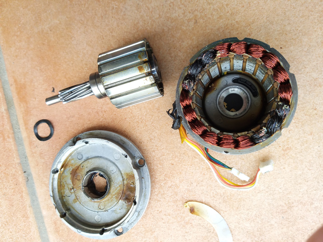

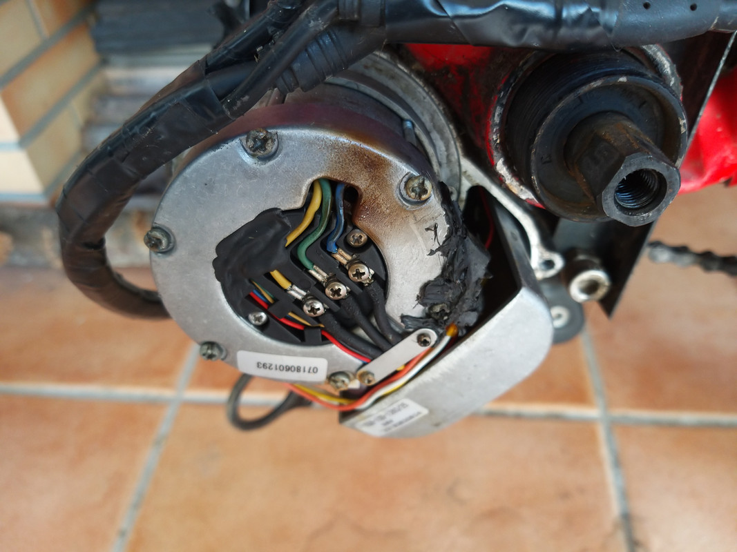

Post by Gyuri89 » Dec 18 2019 6:13am
Hi Everyone
I'm new on the forum, however the tsdz2 is not new to me. I work as a bike messenger, so using my bike is pretty essential for me.
I also go with the opensource firmware. I love it. It had changed everything, a big thank you to Casainho! :wink: :D :D
I've met many issues emerging due to excess usage, I literally broke the torque sensor, I killed the sprag clutch back when I was using the original firmware etc..
Now I have a new issue that I can't identify. It happened yesterday when just all of a sudden the motor started having a noise like it'd be a four stroke one cylinder engine, obviously not that loud. The noise occurs only if the motor is engaged. I don't notice any loss of power. Under one pedal revolution I can hear so many hammering-like noise and it can be felt physically as well as it resonates through the crank, especially on the right side. I wanted to detect if it was one of the bearing so I tried to count the number of strokes under one revolution. Would've been nice to have a clue which part of the gearing it comes from but I couldn't count it, it is just too frequent. I took the motor apart to check the bearings and the gearing but I couldn't find any obvious sign of any abrasion or anything. I'm using the blue gear, it is still perfect as I'm rather careful with the acceleration, have no start boost neither. I've gone further and opened the motor but no visible wear found inside. The bearings are fine, the magnets are where they should be. In shorter/slower gear ratio it produces louder noise and vibration, also if I go uphill it is much loader, obviously I use lower gear then. On the other hand, when using longer/faster gear ratio it's even hard to notice anything, I guess the cadence is roughly the same.
...feels like one of the phases does not energize. I guess if it was the case the motor wouldn't run at all, but I'm not into electronics that much. No error code pops up.
Unfortunately have no throttle so I can't do tests on a bike stand.
I tried to find some info on the forum but haven't found any similar.
Could any of you help me? Have you ever met or heard a problem like this?
Thanks in advance.

Maybe you can set the motor to cadence only. In that mode, it ignores the torque sensor and can be tested with the real wheel lifted if you rotate the pedals. Another option is walk assist to get it running without torque and cadence.

Post by casainho » Dec 18 2019 8:40am
Gyuri89 wrote:
Dec 18 2019 6:13am
Recently I had some issues hard to debug, one of them was hall sensors failing I think and while debugging I even did burn a motor:
Then I added an option on display 850C and firmware and we will be able to see the hall sensors state so when we slowly rotate the bicycle backwards, the motor rotates and we can see the hall sensors state changing and spot if there is a missing value meaning a problem. The latest 850C display firmware already supports this but the motor controller firmware was not released yet to support this, I hope to have a new version in 1 week or so.
In my case, I had to replace the motor as also the motor controller. I think the issue was on the motor controller because even after replacing for a new motor and checking and cleaning the hall sensors connectors, I kept having the same issue.
And yes, I tested using walk assist.
But maybe your issue is instead the Blue gear roller clutch slipping, see here on the wiki more information and the solution: https://github.com/OpenSource-EBike-fir ... h_slipping

Post by Gyuri89 » Dec 19 2019 12:11pm
casainho wrote:
Dec 18 2019 8:40am
Gyuri89 wrote:
Dec 18 2019 6:13am
Thanks for the suggestions! :)
So I tested it in walk assist mode as well as in cruising mode. I found that in walk assist mode there is no sign of the problem, the motor runs very smoothly, but if I sit on the bike in cruising mode I can feel/hear the strokes. Also noticed if I push the bike backwards it gets stuck periodically. I switched the power off I took of the chain and tried to turn the chain wheel back by hands, it stops always at the same spot (9times/a turn). When it stops it's very difficult to move it out of that position. It's not meant to work like that basically. Based on these facts I assume the problem is rather mechanical. It could be a sneaky invisible mechanical one as I didn't see anything when I opened the motor. :shock:
I found on the forum some of you had the same problem and replacing the blue gear solved it.
Somehow I don't experience slipping as you discussed it on the previous pages.
If it is the blue gear, one cause I can imagine is that the blue gear is out of its centre due to the damaged one way bearing.
Now retrieved the moment when I started to experience it. I was in a rush and wanted to reach a green light so it shifted up to higher assist level, I sped up and suddenly realised I had to stop after passing the lights. I braked hardly earlier than I would've stopped pedalling. So I only slowed down the rear wheel (not skidding it) and I was also triggering the motor as pedalling in a fairly high assist level. (This is a stupid thing I had as I also ride a fixed gear bike where you do something similar in order to slow the bike but doing it to the other direction, I got confused by the adrenaline..anyway, long story short..) I guess if I had skidded it to stop the turning of the crank totally, the controller would've cut the motor of. That could've been a better scenario. I have no break sensor neither to save me :?
I ordered the bearing to the blue gear, we'll see if it helps or not. Also thinking of ordering a new blue gear.
