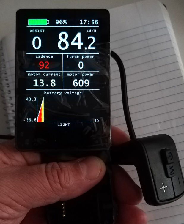

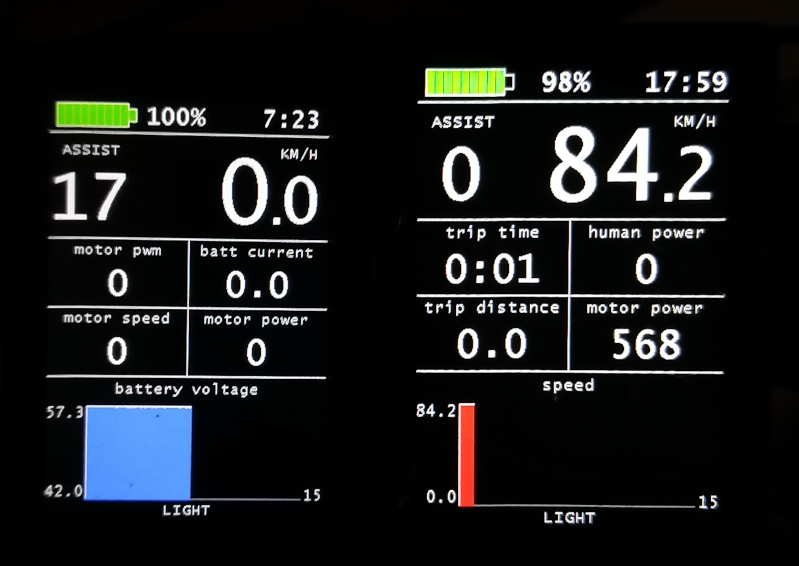

860C display is now working on our OpenSource firmware
Finally I got it working and would not be possible without the help of Electrify Bike and Eco Cycles shops.
The 860C is clearly an important improvement over 850C, you can see here the comparison table I wrote: https://github.com/OpenSource-EBike-fir ... comparison
Both side by side at dark, it is hard to see on the photo the differences, at least the higher screen size can be seen:

New firmware release, 860C display now works!!
Changelog:
- Ebike 860C display now works!! (note that there may be some bugs)
- Corrected issue where current battery Wh was not correctly being shown
- Corrected graph auto max and min and added the semi automatic option
- Removed configuration for battery cells number as it was not really relevant
Get it here: https://github.com/OpenSource-EBike-fir ... 102_v0.6.9
