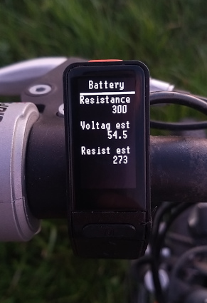

New feature: battery pack resistance
One important technical characteristic of the batteries is not only the capacity in watt hours (WH) but also his internal resistance - the lower, the better.
The next firmware version will automatically calculate for you this value, you just need to pedal / run the motor for some seconds at a high battery current value like 10 amps. Then, you need to insert this value on the battery resistance configuration field - you should maybe increase a bit the value to be conservative.
Q: Why is it important and how it is used by the firmware?
A: It is used to calculate with a very good accuracy the state of charge of the battery (SOC) as also in future to calculate the energy watt hours per kilometer (will be shown on a graph on 860C/850C display) and estimate the available range in kms.
Here an example of calculation of power loss inside the battery due to his internal resistance:
Assuming the TSDZ2 is pulling 16 amps from the battery, and that my battery of 350 Wh (watt / hour) has an internal resistance of 275 milliohms, the power loss inside the battery is: P = R * I * I = 0.275 * 16 * 16 = 70.4 watts. As we can see, this power loss is equal to 20% of my battery capacity!!
I know there are battery cells on the market with half of the resistance, so, by using them I would have an extra 10% of my battery capacity on the previous usage example.
Real example of my battery and measure on SW102 - Resistance est is the value automatically calculate and Resistance the value I decided to configure:
Note that I validated this automatic measurement with 2 different battery packs, both with the same cells but one is a 14S2P and other 14S3P. The 275 milliohms was measured on the 14S2P and 195 milliohms on the 14S3P, which for me makes sense comparing the theoretical values.
- TSDZ2 OpenSource firmware

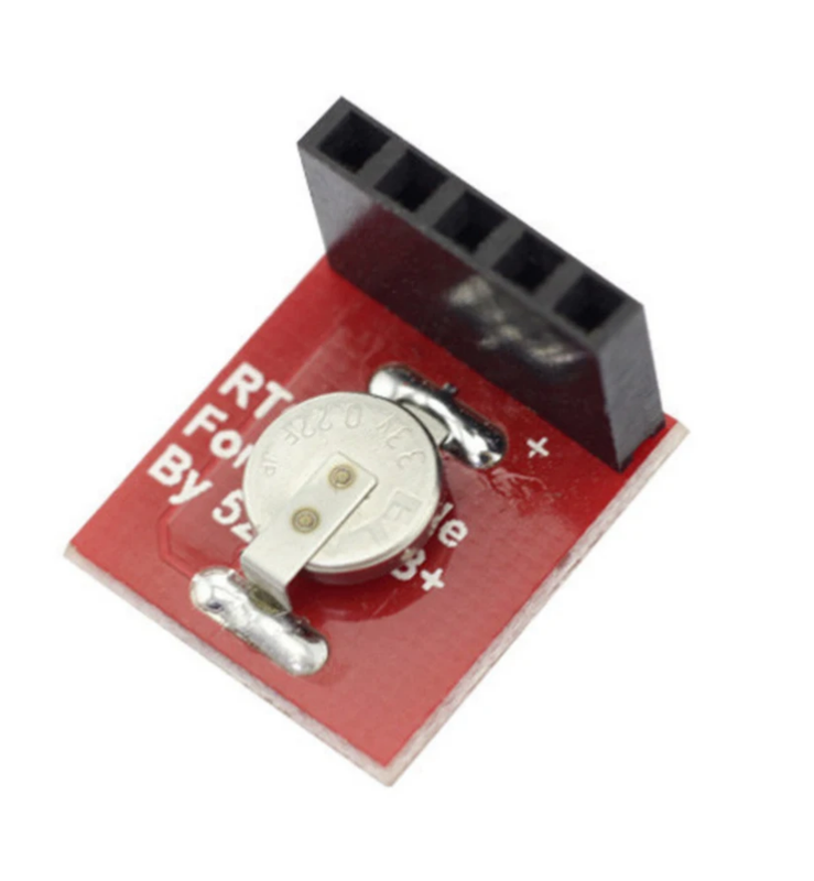

Huguenot wrote:
Mar 28 2020 10:05am
First, the clock looses time. This seem to be a mfg flaw and perhaps the display should be replaced? Not critical but annoying. I have a Luna 750c on another bike which does the same thing. Is the 860 display any better in this regard?
Today I tested a new 860C display and after about 36h the time drifted. On the other side, the one installed on my bicycle is keeping the time correct but I am using it every day.
Since there are supercapacitors on this type of RTC circuits, I now assume it is an supercapacitor and not a battery and so that is the reason why it holds correctly the time only for about one day and half.
Here an example of RTC circuit with a supercapacitor: https://wiki.52pi.com/index.php/Raspber ... C(English)
Retrorockit   100 W
Posts: 140
Joined: Feb 08 2019 12:07pm
Post by Retrorockit » Mar 30 2020 10:16am
casainho wrote:
Mar 30 2020 10:04am
Huguenot wrote:
Mar 28 2020 10:05am
Could the supercapcitor be replaced by a coin cell battery that motherboards use for that function?
