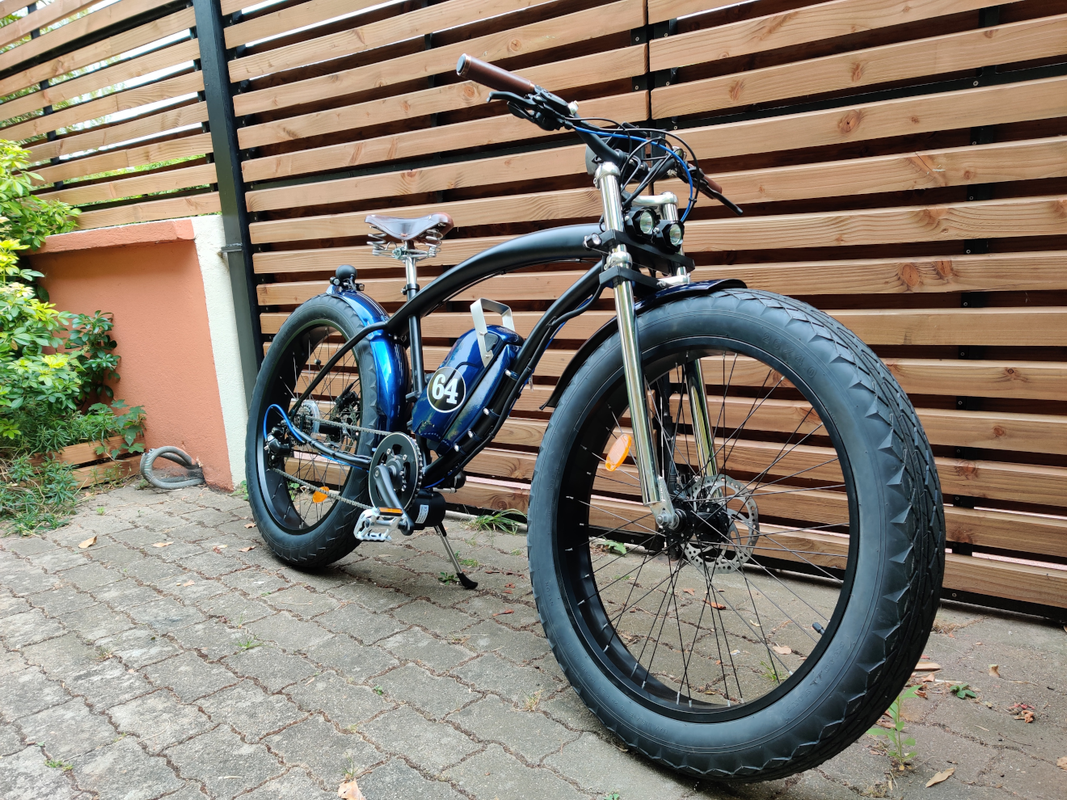

I would like to share a picture of a beautiful build of a fat bike with TSDZ2, that was posted on github issues by user eraue:
Built an e-bike with a tsdz2 and 860c display that I use to commute 40 minutes to work every day.

That looks great :thumb:
