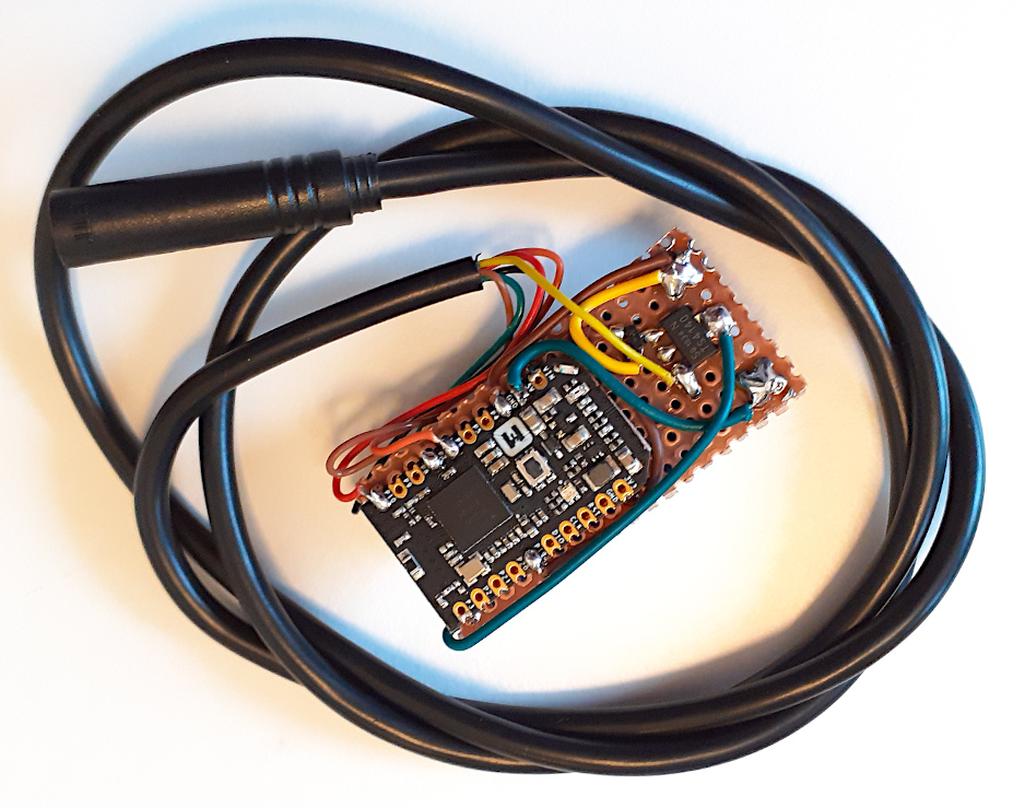

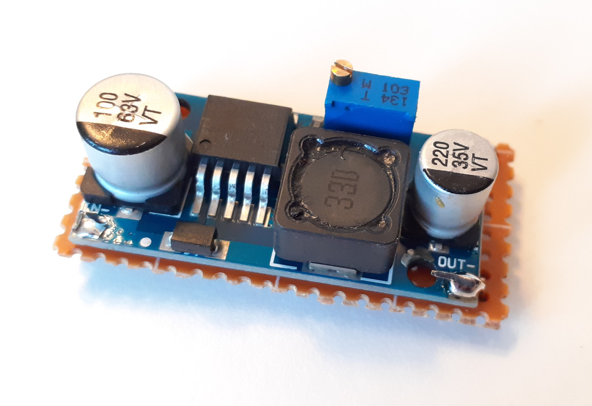

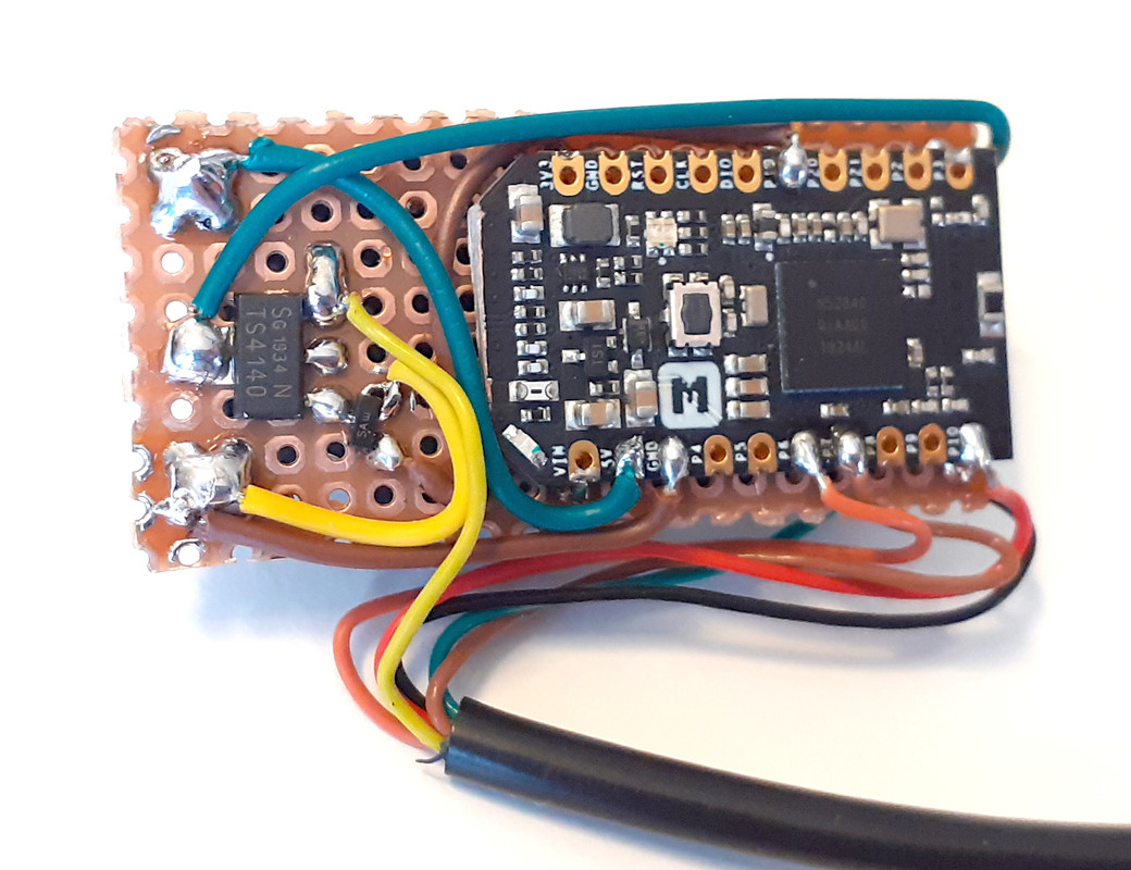

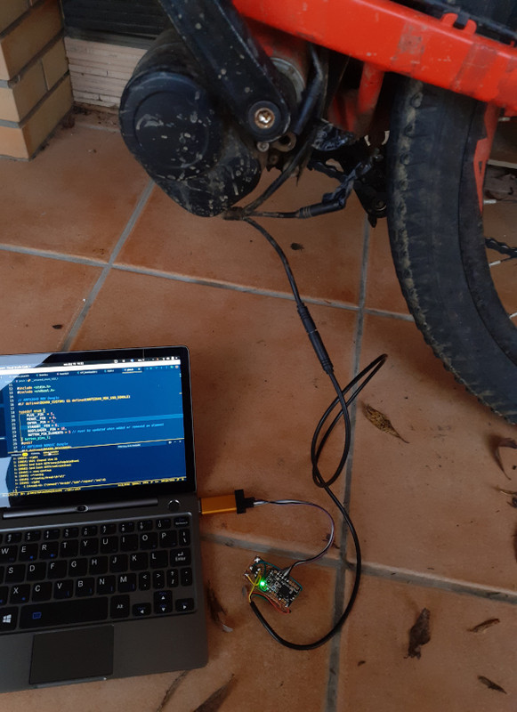

Some news about the TSDZ2 wireless board:
I assembled a TSDZ2 wireless board and took pictures for future documentation. As you can see, the board is very small, easy to DIY and cheap (about 25€).
I put the wireless board under the DC-DC converter board. I used a perfboard to hold one board in one side and other on the other side and giving enough space to solder the only 2 extra components (mosfets).
DC-DC converter boar (60V battery -> 5V for the wireless board):
Wireless board with all the needed wires soldered:
The board is quite small, here the final cable to connect to TSDZ2 display connector:
Finally I soldered the wires for STLinkV2 and connected to my PC, so I could flash the Bluetooth bootloader and finally the firmware using the bootloader:
And finally testing by connecting the mobile app as also the Garmin GPS display:
