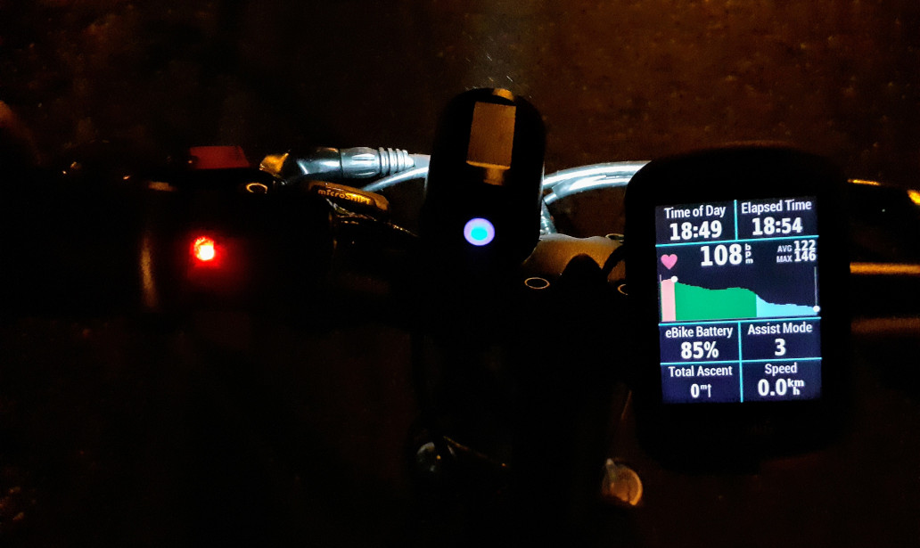

Yesterday I did the very first ride using a wireless remote and a wireless display!! The advantage is that I can have a clean EBike if I decide to not use the remote and/or the display as they are optional, there are no cables to connect. I can always keep my handle bar clean and use my mobile phone instead of the remote and the display, as I always carry it my pocket.
I also do not install the wheel speed sensor as the EBike speed can be seen on the GPS display because it uses the GPS for calculating the speed.
I am using the 860C display remote buttons but I could also use the VLCD5 remote buttons - and they are connected to the wireless remote box, that blinks that green light when I change the assist level - this is a prototype, so it is not clean as I want on my final installation.
Note that I am also using the Garmin Edge GPS wireless display and I value a lot to see the graph of my heart rate while I am ridding as also the EBike battery charge level as also the assist level.

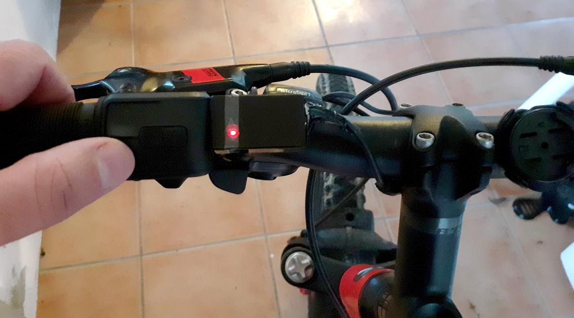

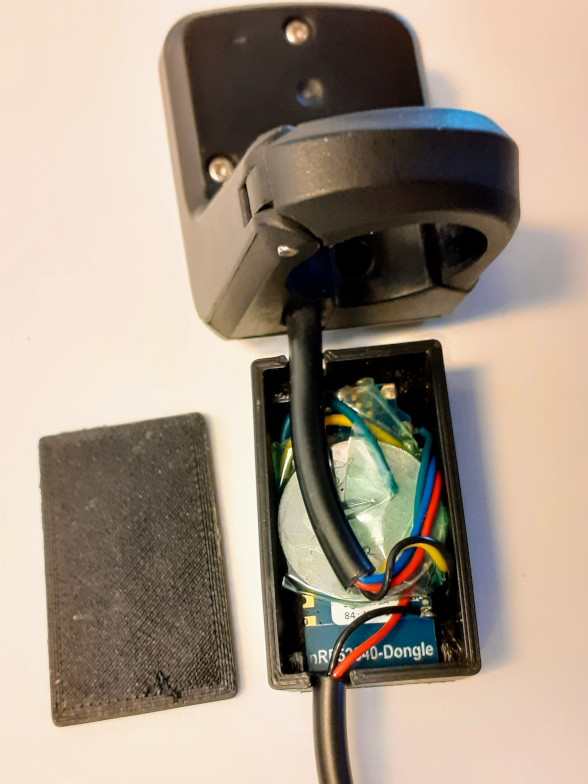

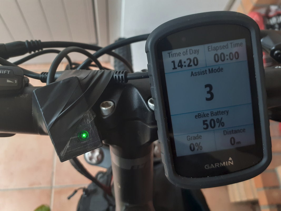

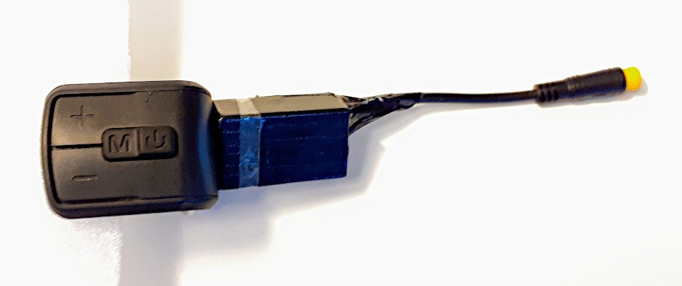

I would like to show my TSDZ2 fully wireless and the best wireless display for TSDZ2
I build my own wireless remote and I decided to use a 860C display keypad. As seen on the picture, one cable is the keypad and the other is for the brake sensors (yes, the brake sensors are also wireless!!).
Also note the CR2032 coin cell that gives the power to the wireless remote for about 2.5 years.
And some tape to make it water prof and the water prof Higo connector to connect to the magnetic brake sensors that are installed on the brake levers:
And the remote LED with red light showing that I am using the brakes:
And the GPS wireless display showing the TSDZ2 EBike battery level as also the current assist level number. Also note my heart rate graph, where it is being measured on my pulse by my watch and sent wireless to the GPS wireless display:
If you want to have a clean EBike and/or cheap EBike, the Garmin GPS wireless display and the wireless remote are optional as you can use you mobile phone to see the EBike data and control everything on the TSDZ2.
The cost of materials to make TSDZ2 fully wireless is about 25€ only!! See how to build it for free on the project page: https://opensourceebike.github.io/

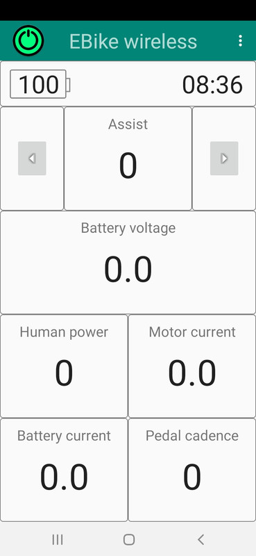

The mobile app:
