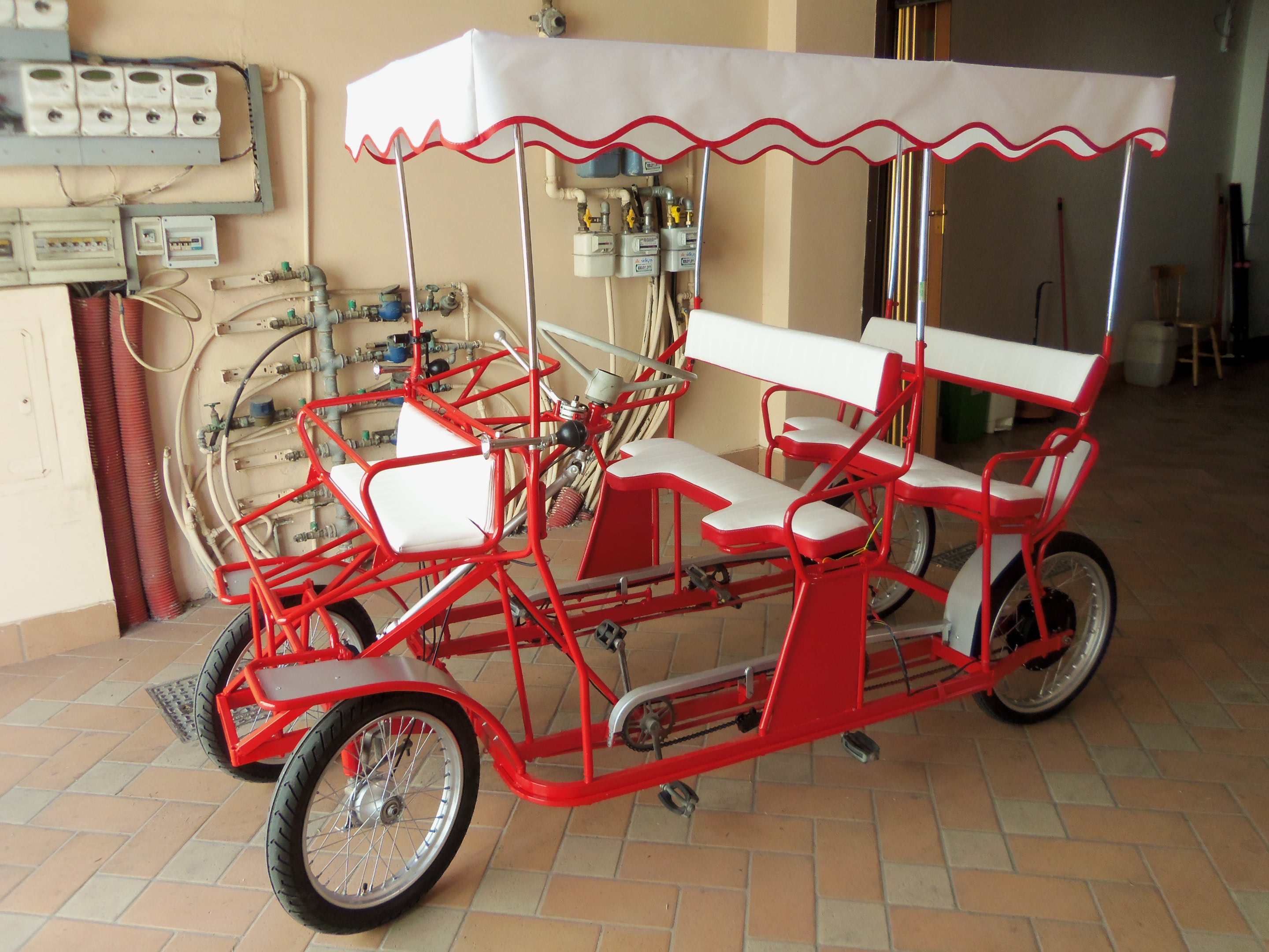

here to report a very special mod and electric conversion of an old 4wheeled cycle with two cranckset and seatposts, made in the '70 to be used on seaside towns here in Italy; a pair of friends found it lost somewhere....
Image Image
It has been stretched,
everything over the Bottom bracket's plane has been cut out, only the LH crankset is maintained, and a steering mech form a Piaggio Porter is used from the steering wheel to the front wheels with an old 90° mandrel, so that it passes under the platform the flat quargo is actually covered with, because the rider position is moved back and results far from the front wheels.....
