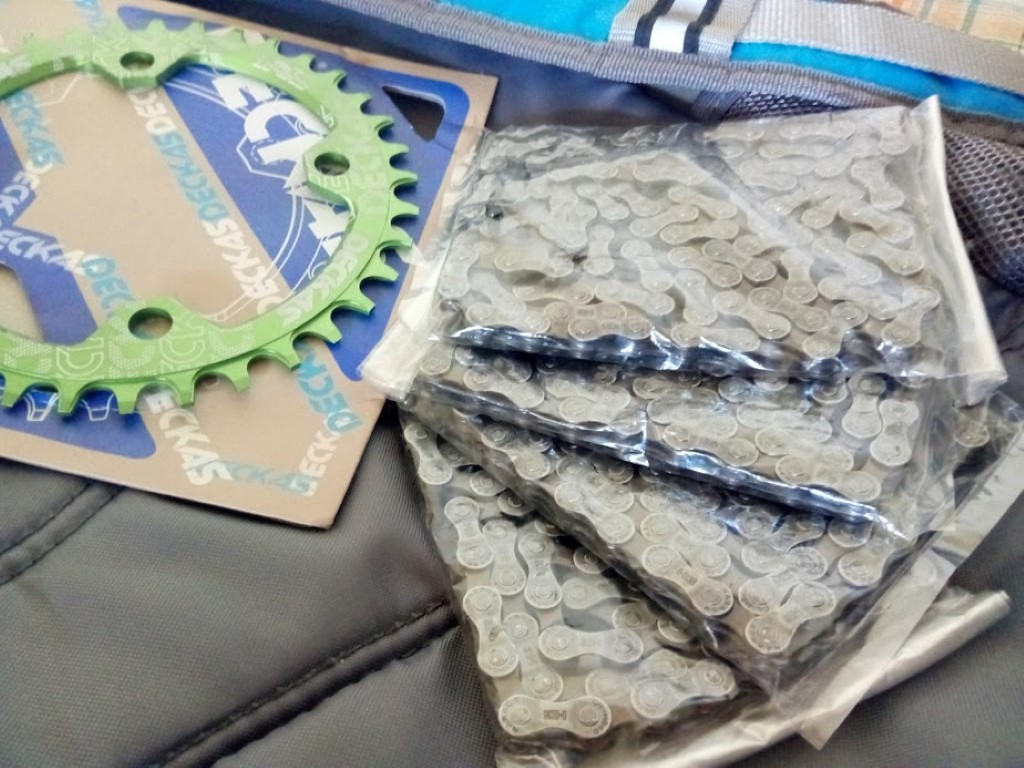

yes in fact i have a 1x9 pedal bike that uses 10spd cn-hg54 for better chain retention w/ the NW chainring. but for my mid-drive bikes those chains are too expensive since electric wears chains quickly, so i use cn-hg40, costs P220 or about US$4 at the LBS. cheap 8) so i buy 4 or 5 at a time and rotate them every 2 weeks or so prolong my drivetrain

don't worry too much about it. a simple FD/chainguide solves all your problems especially since you say you have a perfect chainline i.e. lines up w/ center cog
