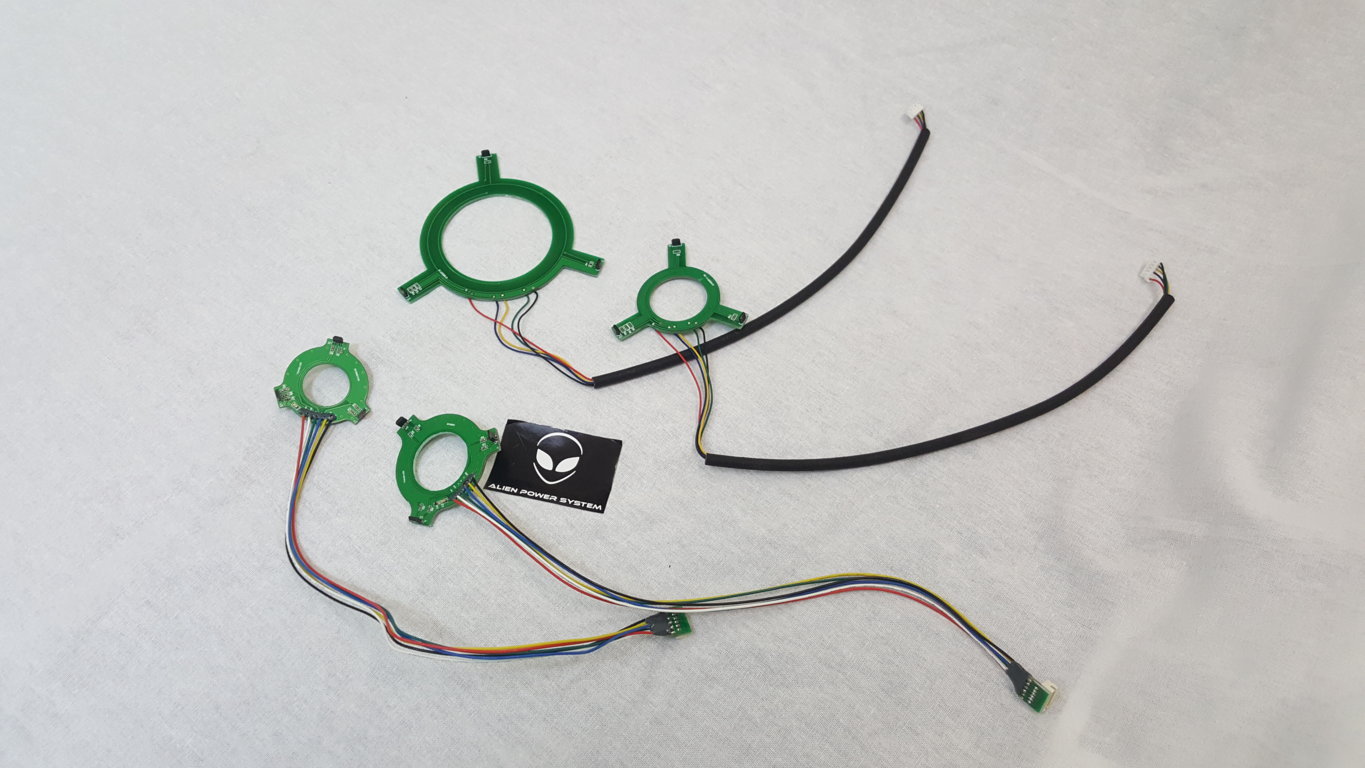

• Sensored using an external hall board from e0designs.com

Anyway, I'm still trying to figure out how to find the optimal hall sensor position. As mentioned above somewhere, I set this up for the lowest possible no load current draw with the wheel spinning in the air. There is an occasional stutter at really high load and low RPM which I think is the hall signal being washed out by the field strength from the high current or just bad positioning.
So I brainstormed a testing solution and I'd like somebody to tell me its either a good or bad idea.
I have an extra 9c hubmotor laying around. Its a crazy low kv motor that goes 25mph on 80v in a 26" wheel. The regen from it is pretty stiff. So my thought is to mount the 9c in my frame with my rear 94 tooth sprocket on it. Then I would use a second controller to control the regen from the 9c to create some load for this 80100 drive. I have 2 cycle analysts so I can monitor everything while I tune the hall position of the 80100 setup all on my repair stand. Like a poor mans dyno. Such a poor mans dyno that I can even use the same battery pack and just send the energy on a useless trip through 2 motors. Its like a perpetual motion machine, humanity is saved!!! :wink:
I would like to directly compare the hall position behavior and efficiency of the mid-drive at no load, max load and everywhere in between. I suspect the lowest no load current draw is not the magic spot. What's been weird is that the further I move the halls the faster the motor seems to go. I even machined more adjustment into the bracket and once the motor is spinning I can just keep getting more rpm out of the wheel until I hit the physical limit of the hall bracket. I would have liked to see it pass a point and begin slowing back down so I could be confident I was passed the point of highest efficiency. Im thinking with a bit of load the point of diminishing returns would become very obvious.

Dan,
In my experience, my best overall setting for hall timing was between 3 & 5 degree's advanced from lowest amp draw unloaded.
you will get some stutters at the extream load (starting from a dead stop) but this should wake the motor up from 1/3 speed to the top.
Idealy these motors are producing their best power @7500 rpms. Gear accordingly.
(in all my trials, I could never load these to 6kw for any reasonable time....they allways showed some heating issues.)

Great. I'll try that first. You mean physically 3-5 deg around the full 360 of the can or 3-5deg electrical timing?
Does it matter which stator teeth the halls are positioned relative to? For example the windings on each 2 teeth are the same phase. So if a hall was in between two teeth of the same phase would that act differently than if it were between two different phases?
Seems like it wouldnt matter since the magnets are a regular patern about the whole can.

yes, physically (into the direction your spinning the rotor).
Easyest done with external hall set up.
For internal placement, I started using "between the phase prs" for positioning & payed attention to rotation to have the advance going in the correct/desired direction. (if my math was right, this equates to about 15ish deg of advance or retard depending on rotation)

Seems like a big difference in position 15 vs 3-5deg.
Id like to see your math on that. I really dont understand hall timing and positioning.

I looked at the motors from Alien. I like the internal sensor boards but I was worried they would block airflow through the motor. I like the ease of adjustment of the external sensor. This was my first RC motor experience so I wasn't sure how easy it would be to take apart to adjust the internal sensor board. Turns out these motors are pretty easy to mess with. I love how easy they are to fan cool. What a huge difference that makes for a motor!
An encoder puts me in an entirely new price bracket with controller options. I'll figure that out when I have the money to do a full on motorcycle conversion some day. Affording a Sevcon for $750 using an encoder doesn't sound too bad compared to a box of burned up Castle HV160s.
If I did it again I would buy an 8072 from alien already sensored.

Are there any USA based retailers offering internal hall sensor boards for these motors? I would like to try one but the shipping from Alien in the UK brings me to over $50 for just the tiny hall board.
