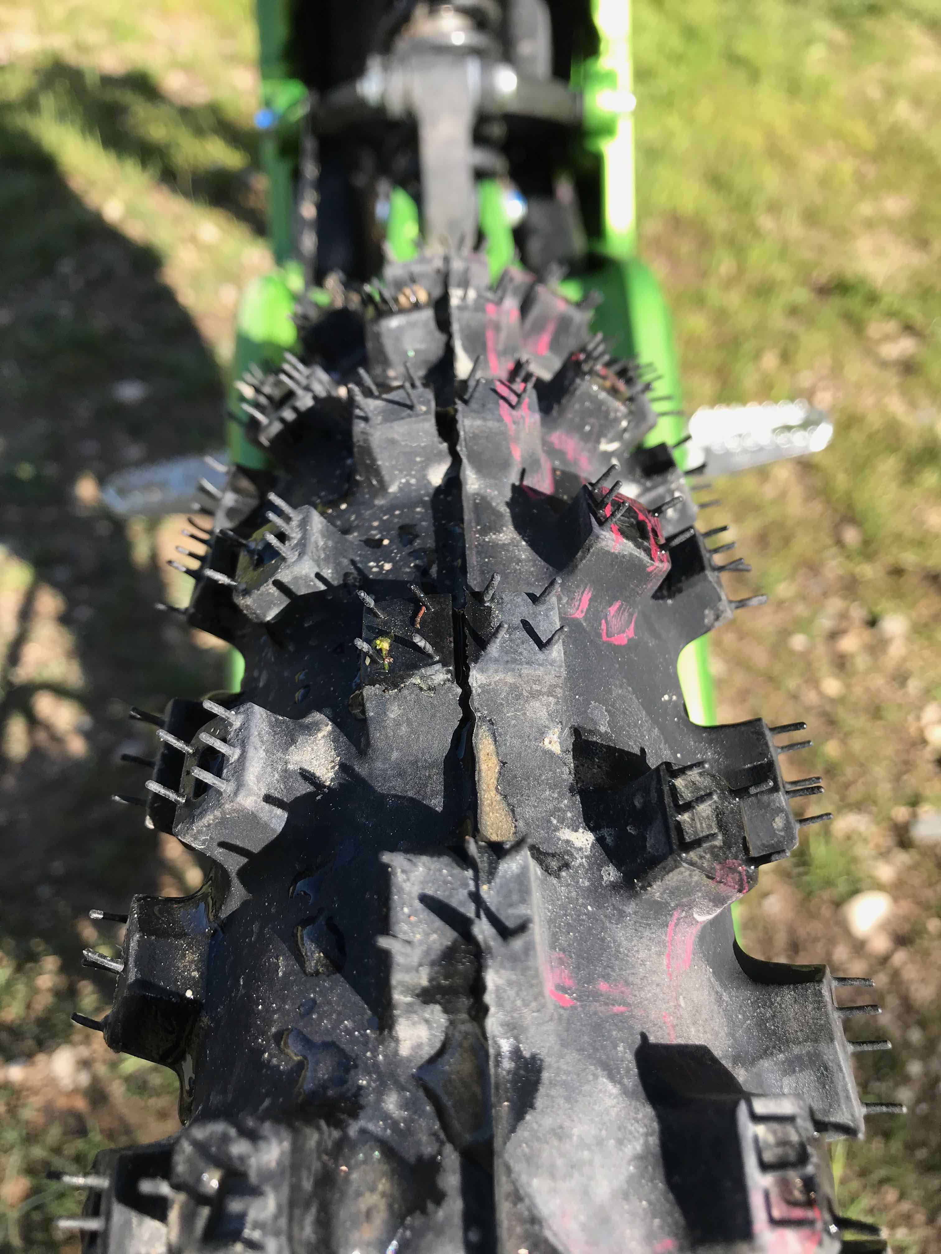

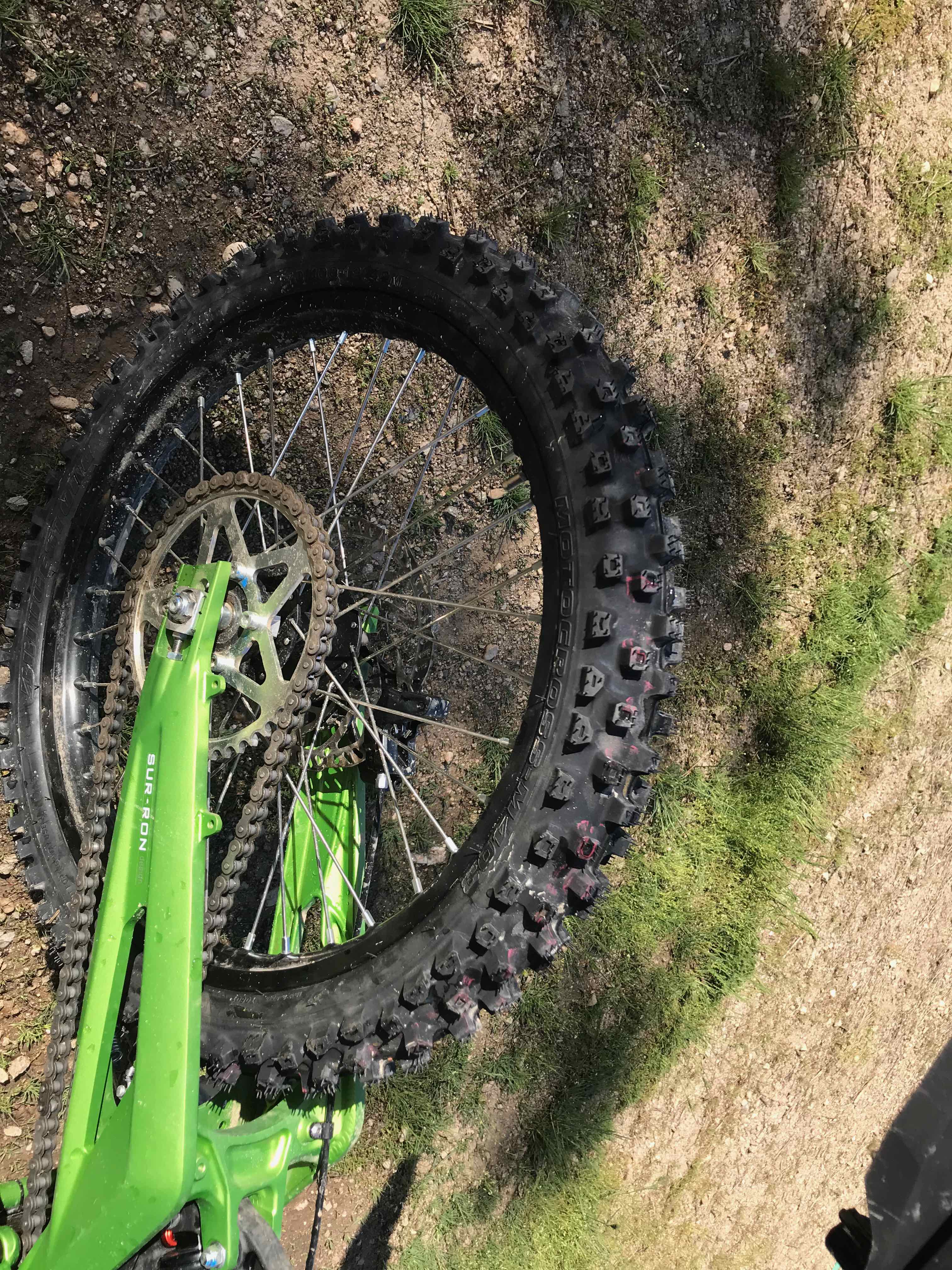

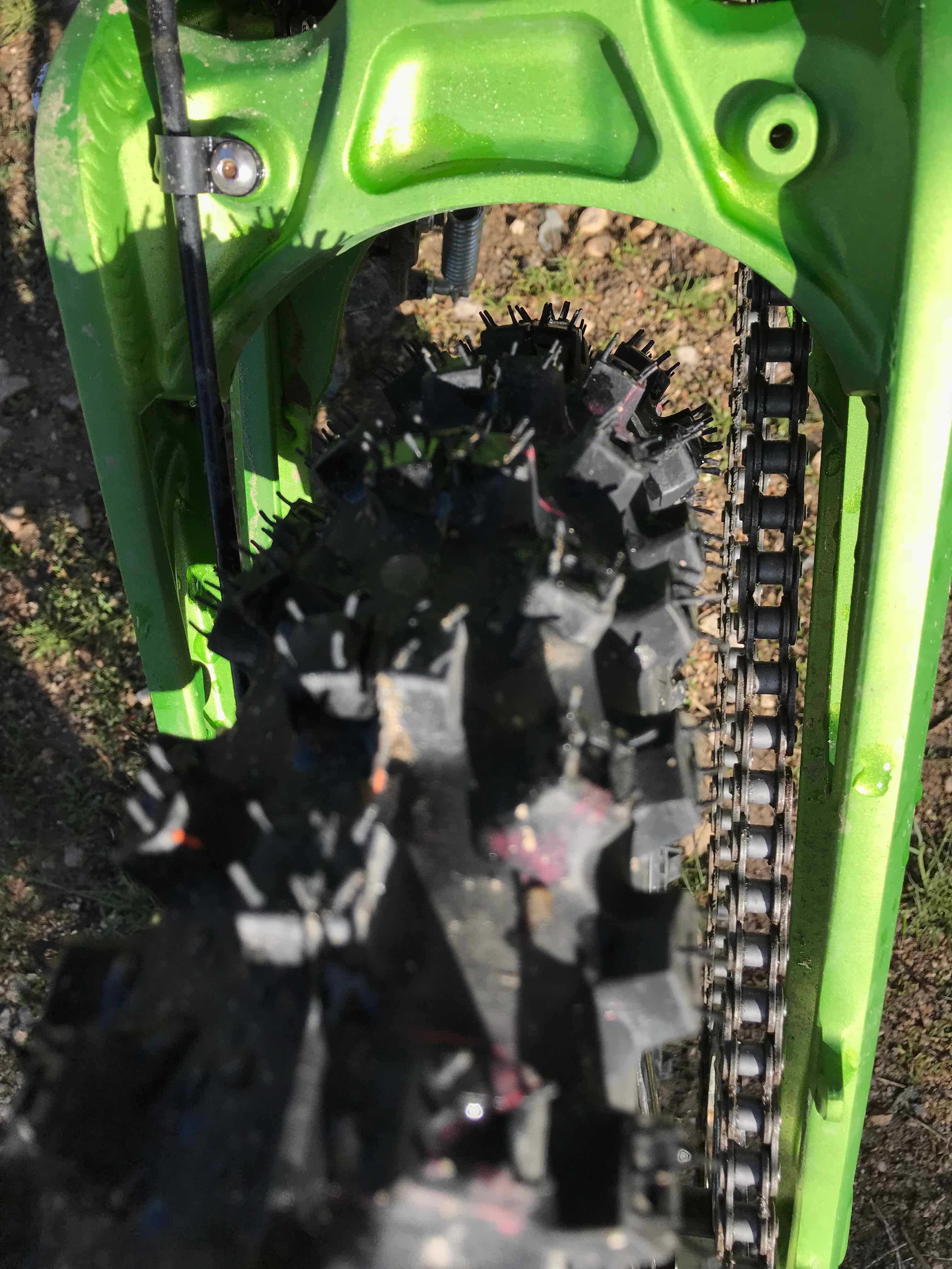

Post by 3DTOPO » Apr 26 2018 6:57pm

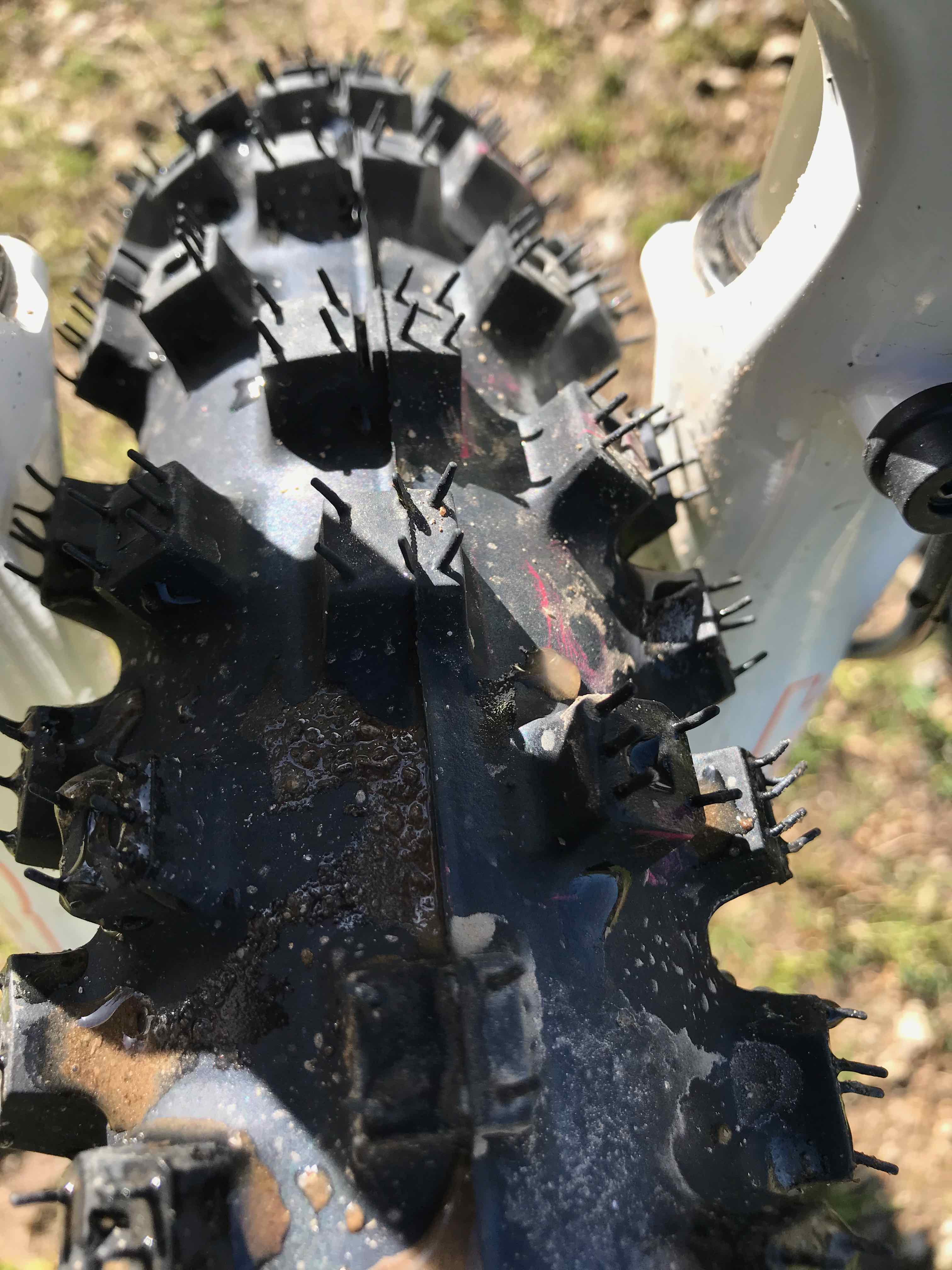

Rix wrote:
Apr 21 2018 10:33pm
Aebrennan wrote:
Apr 21 2018 6:41pm
I have fitted 100/70 in 19inch, they are a front tyre suited for a big wheel 85.
Probably 3 times heavier than the CST factory fitted tyre, but 3 times the rubber.
I just ordered 2 Bridgestone M403 70/100-19 tires for mine. They weigh about 5.5 pounds each. I don't know how much the stock CST tires weigh, but I bet they are heavier than Duro's 24x3.00 Razorbacks which come in at just over 3 pounds. That said, it shouldn't be much of a weight gain, maybe 3 pounds overall.
I couldn't find the Dunlop MX71Fs anywhere in the states, so I went with the Bridgestone M403s. Installation was pretty painless (I had never changed motorcycle tires before so wasn't sure what to expect). Here is a link for amazon shoppers:
https://amzn.to/2r4yAgP
I weighed the CSTs and M403s with the M403s coming in just under a pound heavier. I think that weight went to the nubs - they look about twice as deep - rad!
They look way meaner than the stock ones! :twisted:
You're right about the front just fitting. The back might take 110's but I think that would be iffy!
Definitely no wider will fit in the front (without cutting the side nubs off at least):
Glad I got them, thanks for the recommendation Rix!
:D
Ironically I ran this tire on my Bomber and loved it for off road. Off road wise, its the best tire I have ever ran on an ebike, but the Shinko SR241 2.75-19 is king for all around pavement and dirt performance. Anyway, thanks for posting the pics, looks awesome on your Sur-Ron. I don't thing a 110 would fit the rear, not because of the swing arm width, its ample, but look how close your chain line is to the M403. I think a 110 would be hitting the chain line. When you get a ride in, let us know how you like the M403. I am betting they hook up way better and stick way better in the corners than the stock CST.

Those Bridgestone M403s look great. The extra knob depth will really give some traction.

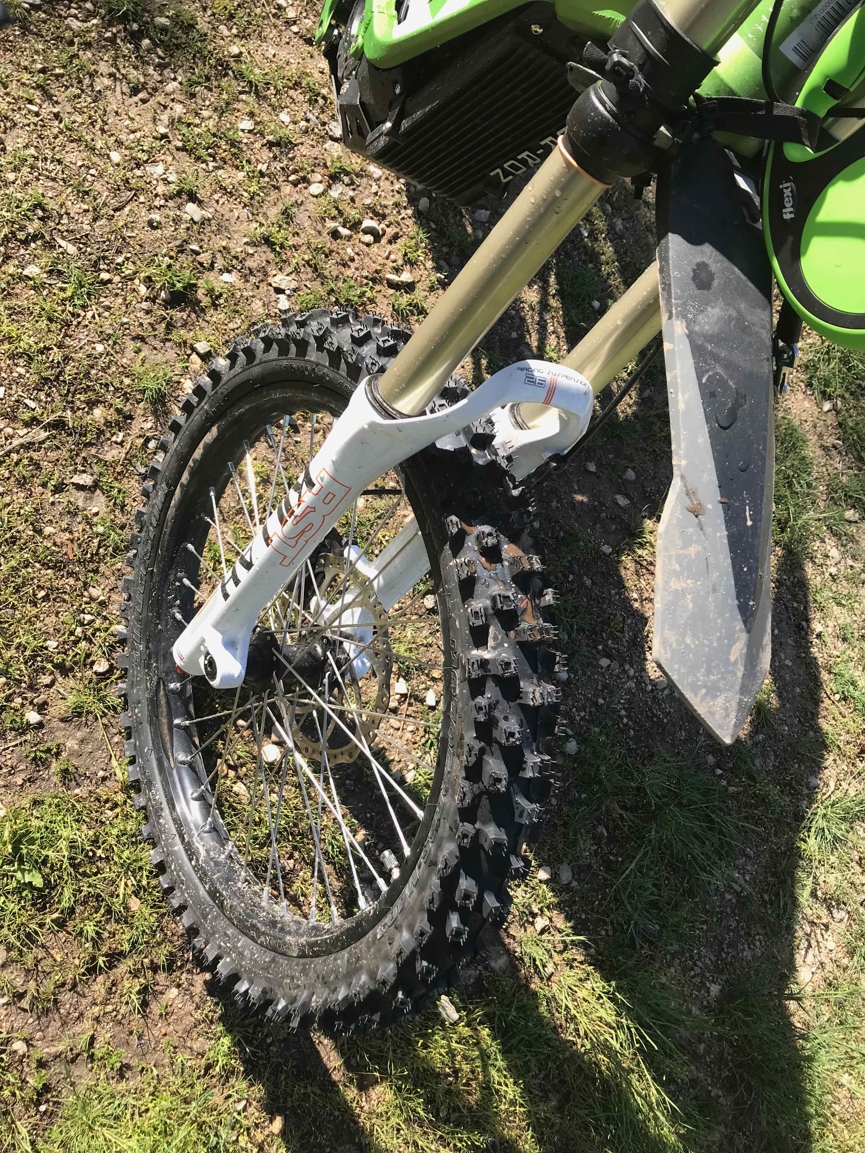

I have both the Fast ace and the RST. The RST forks are amazing but look like a mountain bike fork and have a larger turning
radius. My Fast Ace forks work crappy and both legs leak oil and the air side leaks the air from one chamber to another which
means the fork gets shorter and shorter and I drain the negative chamber and the fork pops up but then the air pressure gets
less and less in the main chamber. I love the sharper turning radius of these forks though.
I wish there was a kit you could buy to make the Fast Ace forks work good and converted them to a coil spring set up.

Rix wrote:
Apr 26 2018 10:03pm
Thanks!
Oh yeah indeed its the chain that I thought was the limiting factor. However, I think its actually the kickstand that is limiting the width. With these new tires on and going over real rough terrain I occasionally feel a pang on the left foot peg. I think the kickstand spring peg is either making contact with the side nubs or a rock is getting in-between the tread and the kickstand spring peg. Trying to figure out exactly what is causing it. Not a show stopper, but its a bit concerning.
I only had 50 miles on the first set of tires so its hard for me to have a full understanding of the benefits of the M403s, but I think it definitely corners much better and feels more grabby.
I was charging up the mountain hard yesterday with nearly a full battery, and the power started to cut out on me. I shot a video but it was my first time out with the chest mounted gimbal so the angle is not ideal and my darn GPS hogs the view - but I can post a clip it anyone wants to see it. Anyhow, I turned off sports mode for a few minutes and it was fine, then switched back to sports mode.

3DTOPO wrote:
Apr 29 2018 3:30pm
Correction: I just got back from a ride, and I suspect yesterday when it got hairy I had my hands on the break maybe barely being squeezed (as I am used to doing in dicy conditions). So I don't think I overloaded it. Think I am going to remove the break wire connection.
As for the panging I am feeling on the left side I am sure it is happening when the suspension takes a hit and not a rock. Going to see what I can do to get a little more clearance for the rear tire.

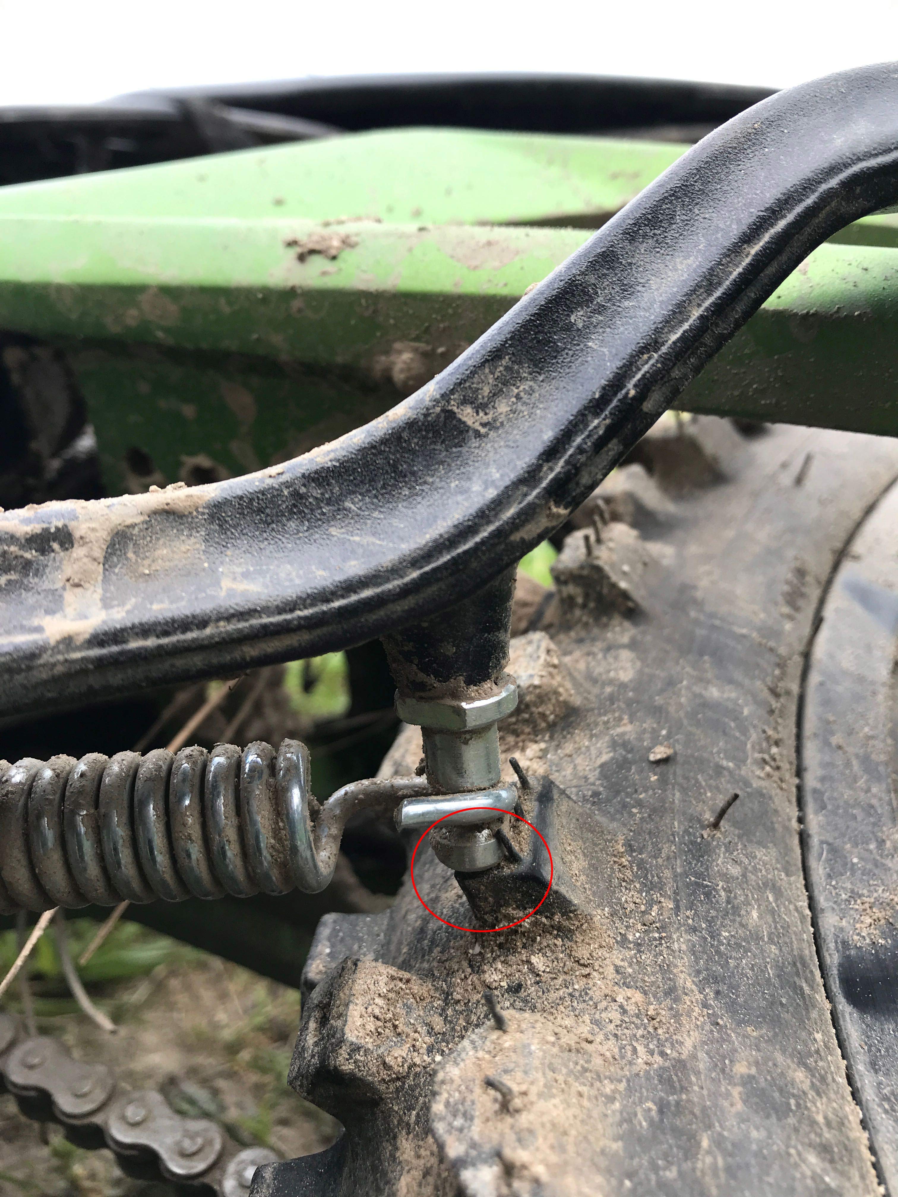

3DTOPO wrote:
Apr 29 2018 9:14pm
OK so the tire is definitely limited to width by the kickstand spring stand as you can see:
I think the most elegant solution would be to fabricate a couple slightly shorter stands (there is some clearance for the spring), but I think the quickest and easiest way to get a bit more clearance is to bring the stand mount out with a few washers (or combine the two techniques for more clearance).
So I am just going to add a couple washers here:
I bet more pressure in the tire would help too. I am not sure what they should be - I have them at 35PSI now. The label said don't exceed the maximum pressure indicated on the sidewall, but I don't see it anywhere on it.
artisanstone   10 W
Posts: 75
Joined: Mar 19 2018 1:54pm
Re: Sur-Ron - New Mid drive Bike
Post by artisanstone » Apr 30 2018 3:40pm
3DTOPO wrote:
Apr 30 2018 3:33pm
3DTOPO wrote:
Apr 29 2018 9:14pm
I received my bike with 30 psi on factory tires. I didn't like traction and lowered it to 15. I might go lower still. I would like to but don't want to have an issue with tubes.
Can you just modify your spring holder? That's what looks to be rubbing. Seems like you could cut it off shorter and grind a new area for spring to mount. Or possibly a different one would bolt on?
