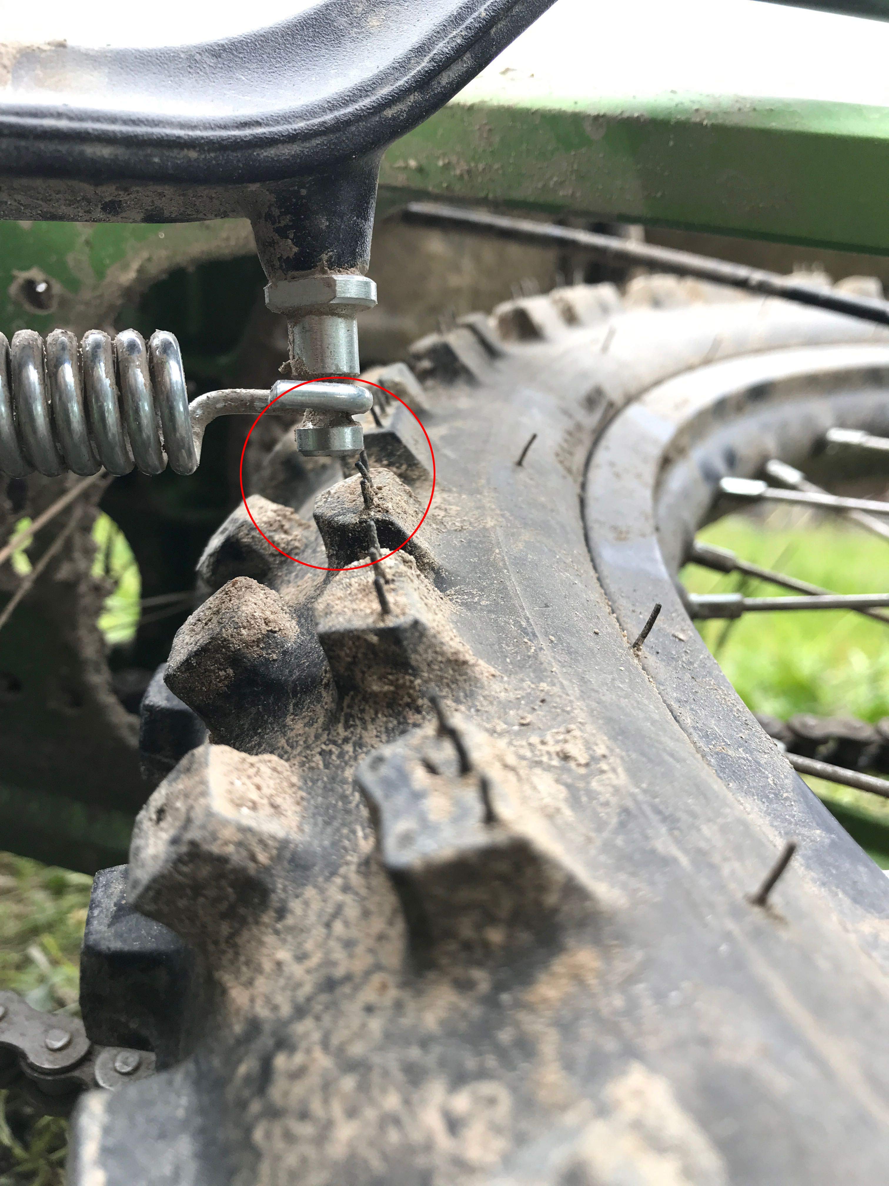

artisanstone wrote:
Apr 30 2018 3:40pm
Can you just modify your spring holder? That's what looks to be rubbing. Seems like you could cut it off shorter and grind a new area for spring to mount. Or possibly a different one would bolt on?
Yeah, like I said that would be the most elegant fix - but also take considerably more time and effort. For instance just getting the spring off by hand proved impossible.
But in literally less than five minutes I got it fixed by adding 3 washers to each of the two bolts. Seems like plenty of meat in the threads still, though I would prefer to get bolts 5mm longer to make up for the washers. Anyone know what size the stock ones are?
