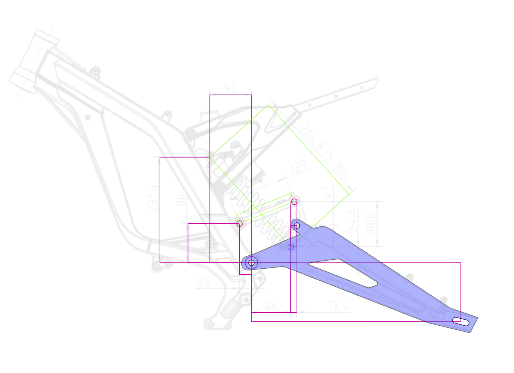

Post by 3DTOPO » Jan 06 2019 10:06pm
Note I pretty much have the stock swingarm worked out, which of course is what I need to base a new design from. Just need an idea of forces involved. :?

Post by motomoto » Jan 07 2019 12:00am
Nice drawing.

Re: Sur-Ron - New Mid drive Bike
Post by 3DTOPO » Jan 07 2019 12:16am
motomoto wrote:
Jan 07 2019 12:00am
Nice drawing.
Thanks!!
