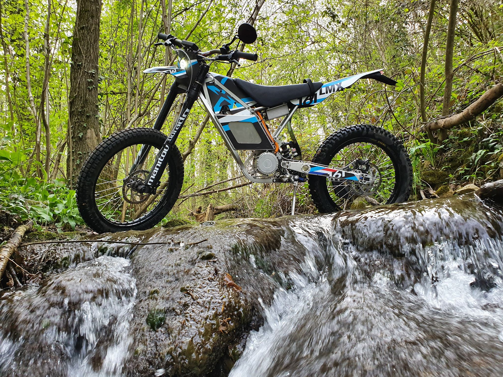

Offroader wrote:
Apr 27 2019 11:02pm
What size C-755 are you going to buy, the 3.5 or 3.0? Can you please weigh the tire when you get it and post the results here in the thread. 3.5" is just heave and unnecessary in my opinion.
I also avoid mud and wet weather, I try never to ride in those conditions, so harder to justify mx tire or even a hybrid, especially if the hybrid is a heavy tire.
The trials tire isn't bad off-road, maybe because I only ride in dry conditions and hard packed dirt. I really like the trials tire because they wear slowly on pavement since I do at least 50% riding on the street. Just to get to my locations to ride off-road takes lots of street riding.
yea i weight all time everything =)
as i ride it on LMX and not on the surron i have 12Kg/26Lbs of air for making this bike heavy like a surron :D
you rode a 17" fat ass hub like me. the diff between a 2.75 and a 3.0 was huggggeeeee.
now as we can jump easy 1m in flats or riding stairs UP, even doing bit of trial stuff every piece of rubber between rim and rock give you additional
plush ride. My bike has now streetlegal 43.5Kg/96lbs. the 3.0 bicycle front saves another 2.5kg. i think i will add 2.5 to the rear. maybe it will work
and you dont feel it until you lift the bike over trees.
Heres a pic from another LMX guy who hast 3.5/18 on the rear and 2.75/19 on the front.
does it look bad? i dont think so.
another (surron)guy has a really heavy monster on the rear. 100/90/19.
this thing was above 100mm width and he must shave the outer profile knobs. every time i rode behind him seeing that his tire eats every rock flawless made me envious. :D
that what i was searching what maximum fits until it touches the chain.
