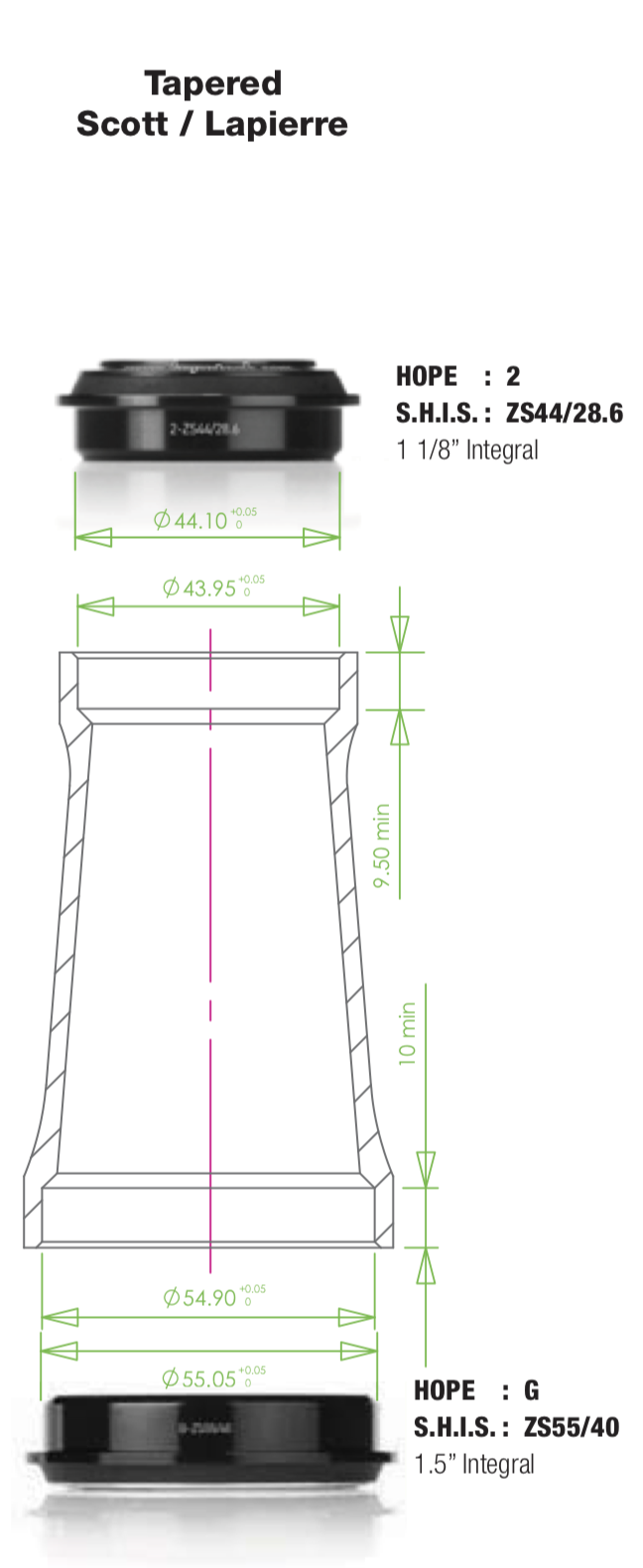

Did you remove the forks and inspect the headset prior to retentioning?
We have found that the lower bearing carriers crack and continue to wear the lower outer bearing race which is alloy.
The headset is a cheap open ball bearing with minimal grease.
The headset is definitely a weak spot but easily upgraded with a quality sealed bearing kit and alloy top sleeve instead of plastic.
I posted pics a while back along with the worn secondary gear and belt after hitting a gritty track.
I did not remove the fork, thanks for the tip!
May I ask what the specs or a recommended product is for replacement bearings/sleeve?

Post by Aebrennan » Jun 20 2018 12:04am
You should be able to use any Integral headset with a 44/55 bearing set.
Top inside diameter is 44mm
Lower inside diameter is 55mm
We have used FSA and Hope brands so far.

Thanks! I assume the bottom bearing also 44/55? Its not tapered either, right?
Edit: I see you gave the diameters for both the top and bottom - should have read it better first, thanks!

Re: Sur-Ron - New Mid drive Bike
Post by Aebrennan » Jun 20 2018 1:14am
3DTOPO wrote:
Jun 20 2018 12:56am
Aebrennan wrote:
Jun 20 2018 12:04am
The headset kit is called a 44/55
The top bearing cup is 44mm and needs to suit the 1 1/8 steerer
The bottom bearing cup is 55mm and also needs to suit the standard 1 1/8 steerer
The headset is designed for tapered headtubes but using straight 1 1/8 steerer.
I will have to post some pictures

Sorry, should have read your post better before asking. So it looks like one of these would do?
Thank you!

Post by Aebrennan » Jun 20 2018 3:24am
Yes those are the main 2 parts from Hope
Top part number Hsc2 and bottom part number HscG
You will also need a reducer for the lower from 1.5 to 1 1/8
Name “Tapered 1.5” reducer (crown)
Part number HS136S
