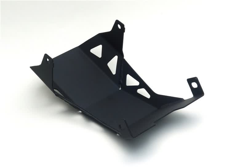

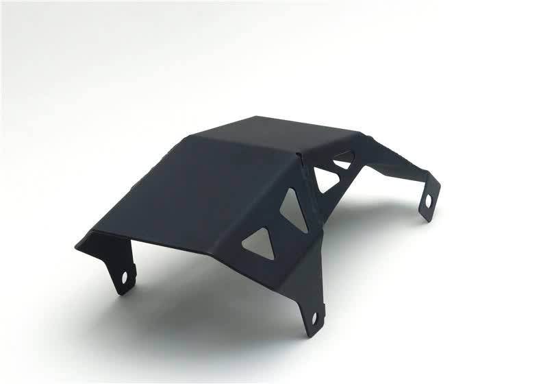

The engine cover on the Sur Ron is quite weak as many have noticed.
I have a company in China since 10 years ago, i let my metal factory make a 100% copy of the engine protector.
Im thinking of making a steel version and a thicker aluminium version.
What thickness do you guys is the best for the aluminium one?
Hi, there! I think it should be 5 mm at least, to be able to jump through logs etc.
Please let me/us know ASAP as it ready I will buy one immediately, cause my stock one is like a peace of paper.

according to Eric at luna, as posted on the facebook group "Sur Ron Owners" luna has recently made an upgraded heavy duty skid plate for Sur-ron light bee and will offer them for sale on their site soon .. so contact Luna for pricing and availability if interested ..

That thing does not look very nicely made. Hopefully it's first prototype. I'm not saying I could do better myself though.
We are just being seeing a picture of the skid plate being form fitted, it hasn't been welded and/or anodized yet. It will look much better when completed.
