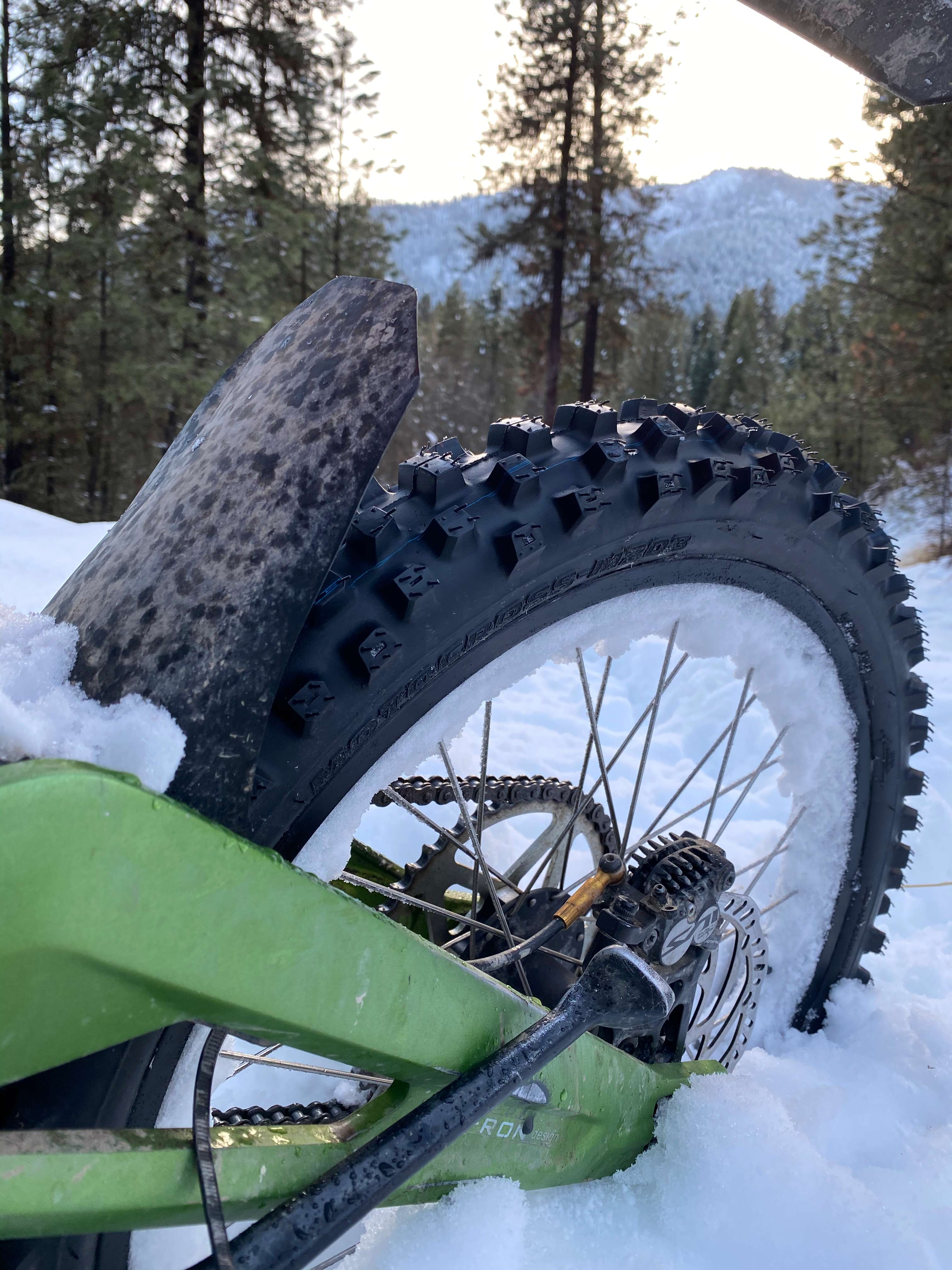

3DTOPO   1 kW
Posts: 427
Joined: Apr 11 2018 2:21am
Re: Sur-Ron - New Mid drive Bike
Post by 3DTOPO » Jan 05 2021 7:48pm
Sup y'all!
So after over 2,300 tubeless miles it was time to replace my trusty Bridgeport M403 with the newer M203.
The first tubeless conversions I had to use a strap around the tire to get enough of a seal for the tire to inflate. It really was the most pain-in-the-ass task in the whole procedure.
Welp, this time I removed the the spoke protector rubber and used a narrow strip of gorilla tap in the U-channel. I then added another slightly narrower band in the U-Channel over that to kind of fill it in. Then one more band on top of that the full width of the rim.
This gave me a good enough seal to eliminate the need for using the strap! Filled right up with just an air compressor. It's such an easy process now I could not recommend going tubeless enough.
