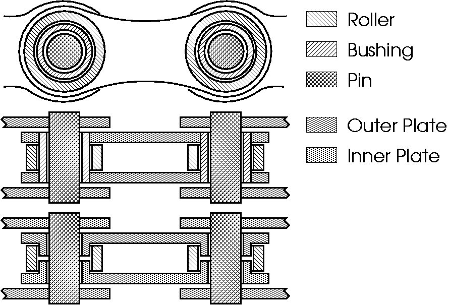

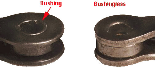

KMC Kool Knight is half link chain, which is weaker than normal roller chain. Theirs is made for bashing and grinding on, which I hope you don't have in mind.
If you're only using regular 8-speed sprockets, then there's no advantage to using some special chunky chain. If you're abusing the sprockets, they'll wear quickly, and wear the chain to match. I recommend KMC X8.93 if you use a derailleur, KMC Z510HX for single speed.
If you use the Z510HX, you can switch from nominally 3/32" sprockets to nominally 1/8", which offers better longevity all else equal.
Far more important that trying to find a mythical stronger chain would be to use the largest sprockets-- highest tooth count-- that will fit your bike and give you the ratio you want. Larger sprockets mean lower chain force, more teeth engaged at a time, smaller angles of articulation.

If half link chain was even as good as, let alone better than, normal roller chain, industry would use it. They don't. They only care about results, not fashion.
I can tell you four $10 chains will outlast your $40 chain by at least 4X and probably more. That's decades of bike shop experience, not theory.

Micro drives have way more leverage and torque than regular bikes. I have snapped the best single speed chains from kmx, sram, and wippermann.
That's one of a few reasons that it's better to run 53/19 or 44/16 to get the same ratio as 25/9. Less friction, less noise and vibration, and dramatically longer lifespan are others.

I was working on a basket case of a bike within the last couple of days, and it was equipped with a half link chain. I was reminded of one distinction of half link chains: all of them have full bushings. So they do have the same advantages and disadvantages as traditional bushing chains, just with less structural integrity due to their bent sideplates.
In a bushing type roller chain, which is the old/industrially standard kind, the inner sideplates are held together with small tubes (bushings), and the chain pins run inside these tubes. That gives a chain the maximum possible load bearing surface, which is good.
Such chains have been superseded by bushingless chains for most bicycle applications. These have inner sideplates that are formed with protuberances on them that serve the same function as tubular bushings. They have less load bearing area than traditional tube bushings, but they allow lubricant to flood the entire chain from wherever it's applied, and they allow the chain to flex sideways much more freely than traditional bushings do.
Bottom line is, bushing chains (like Kool Knight and other half link chains, along with industrial style roller chains) tend to have longer wear lives, but are trickier to lubricate, more likely to develop stiff links, and unsuitable for use with derailleurs or with poor chain alignment. You don't have to use half link chain to get full bushings, but that's one way to get them.
