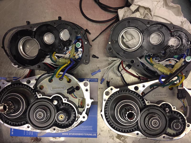

Daxxie   10 W
Posts: 68
Joined: Feb 14 2017 9:35am
Re: Bafang Ultra Discussion
Post by Daxxie » Jun 04 2019 11:49am
El_Topo wrote:
Jun 03 2019 5:06pm
I just found the manual for the Bafang Ultra but wasn't able to determine what the bottom bracket equivalent of the motor is (please excuse my layman's phrasing), could anyone chime in regarding this?
I am asking because I am contemplating a custom fat bike build where the Q-factor is lower than with the Luna Cycles spindle and cranks.
How can I help?
There is around 17cm distance between the ends of the crankshaft.
The end of the Bafang cranks (pedal side) are around 23cm apart.

Post by El_Topo » Jun 04 2019 1:17pm
Daxxie wrote:
Jun 04 2019 11:49am
El_Topo wrote:
Jun 03 2019 5:06pm
How can I help?
Merci Beaucoup for posting these images, Daxxie.
So the Q-factor is (give or take) 230mm, this is way too wide for my sensitive knees but what I expected based on the photos from Luna's site.
What I was looking for seems to be the "spindle length" of the motor, according to this document (which seems to be the official ISIS specification).
If I am not mistaken, spindle length determines the chain line (though you can move it around with a spider and/or spacers) and the spindle length + the cranks (meaning how wide they are and how much sweep they have) determine the q-factor.
Taking your measured 17cm from crankshaft to crankshaft, I would assume this about the same as having a 73mm bottom bracket (with the corresponding spindle), but I haven't been able to verify this with my limited knowledge and therefore lack of knowing what to google for exactly.
Again, please excuse my lacking terminology.
PS: Those green tires look rad on your bike!

El_Topo wrote:
Jun 04 2019 1:17pm
Also found these:
Fatbike spider:
Normal spider
El_Topo   1 W
1 W
Posts: 53
Joined: May 30 2019 3:28pm
Post by El_Topo » Jun 05 2019 1:58am
Daxxie wrote:
Jun 05 2019 1:04am
Also found these:
Thank you very much, if I read this correctly this means the motor has a 150mm spindle. That motor bulge might prevent running very narrow cranks if you look at this photo. So a Q-factor of 183mm and a tire clearance of 4.6" as described here might be be out of the picture, though with right cranks one might still be able to achieve a 195(-ish)mm Q-factor with the added bonus of being able to widen the chain stays and therefore run slightly wider tires.
