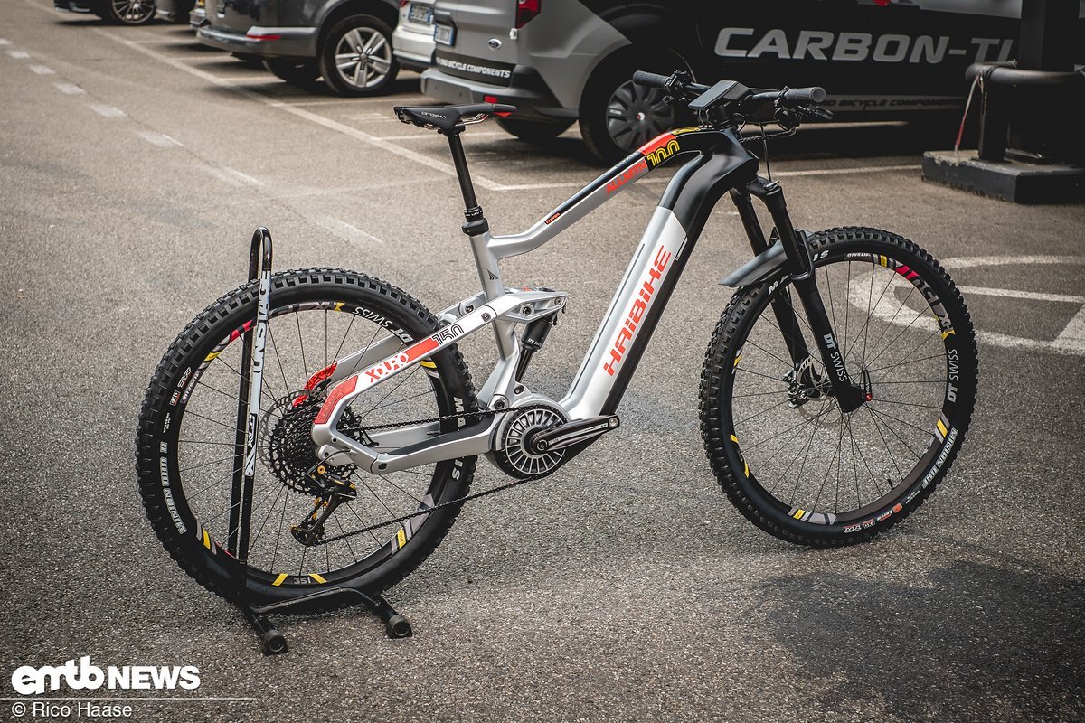

still cannot find a suitable open frame to get the HD drive inside the triangle, but there seem to bee more and more integrated drives appearing..
this is the Haibike flyon , 750W, 120Nm torque..$$6k+.??
https://www.emtb-news.de/news/en/haibike-flyon-2019/
