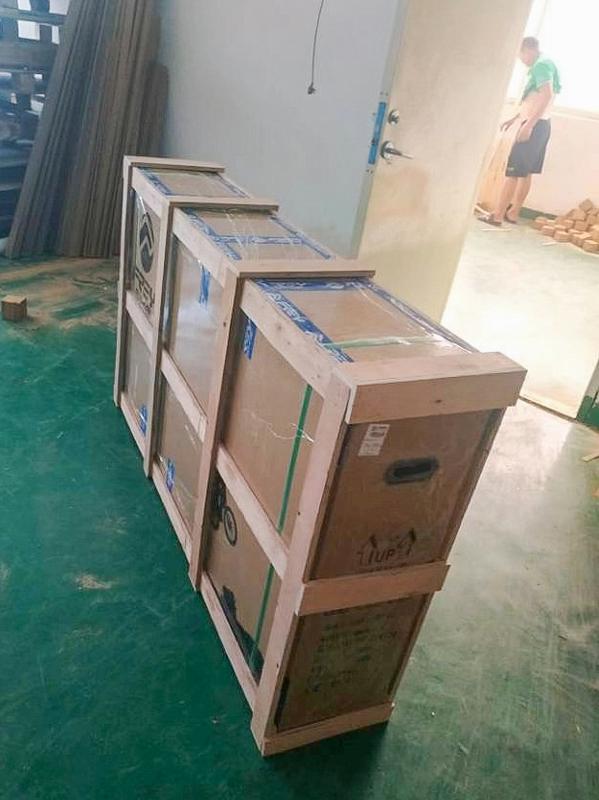

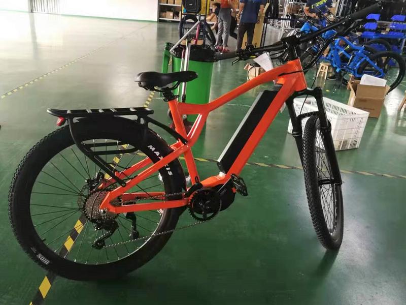

Here is the box, reinforced with a wooden crate for additional protection.
It was shipped out of Shenzhen yesterday, note the gentleman in the background sporting a "Beijing bikini"
FREY lifestyle: Free Ride Enjoy Yourself!

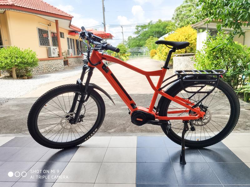

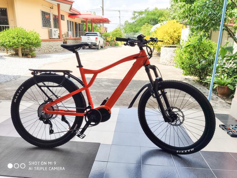

The Frey HT arrived today, but the battery not yet.
It was very well packed, keeping the box if I have to ship it again
Quick assembly today, next week to busy...
