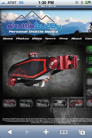

I've always thought the shuttle buddy was cool. I wonder if it freewheels. Probably not since it's only intended purpose is to get you to the top of a mountain.
One thing I found funny in their video was watching people use the drive to get to the top and then pulling it off and sticking it in a backpack right away. Wouldn't the motor be too hot to do it that quick?

I met the guys the built it at a local mt bike race, they do all the work themselves. It's really a neat product, the only thing is, it's loud and gassy. Two things that are a total turn off to ALOT of the mt bike community. Can you blame them!!?? It really polarizes people like no other on the local my bike forum. I have even asked to buy the drive spindle, "no way, not unless you have bought the whole system!"

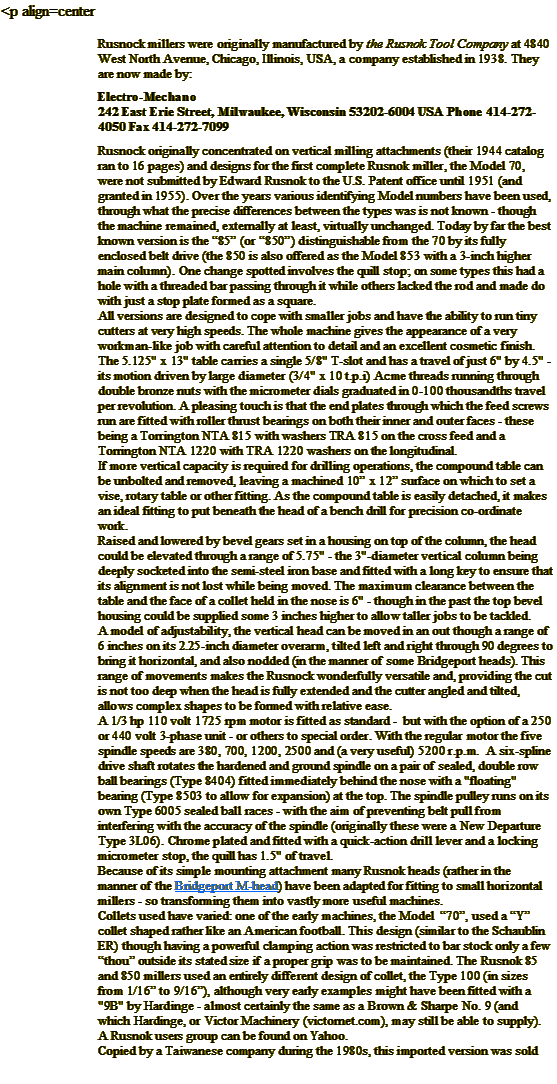

What's a desktop CNC mill? Is it like this:
Cuz, I just picked me up one. :mrgreen: No, CNC here baby!
How are you coming on your drives Todd? Are you still planning on producing a couple?

etard wrote:What's a desktop CNC mill? Is it like this:
Nice Rusnok mill. You need to convert it to cnc! :)
The one in my photo is a highly modified MaxNC 15. Just like friction drive a lot of people talk crap about MaxNC but I've had great luck with them. I'm a firm believer that if you're making small parts a small machine (set up correctly) is fine. I currently have 2 small cnc mills, a larger Chinese mill, 2 cnc lathes, and a manual Chinese lathe. Fun stuff!
As for making a couple of drives... I have 3 sitting in front of me right now. One is my girlfriend's and I'm going to make one little change to the other two. Not quite sure what I'm doing with them yet. lol
