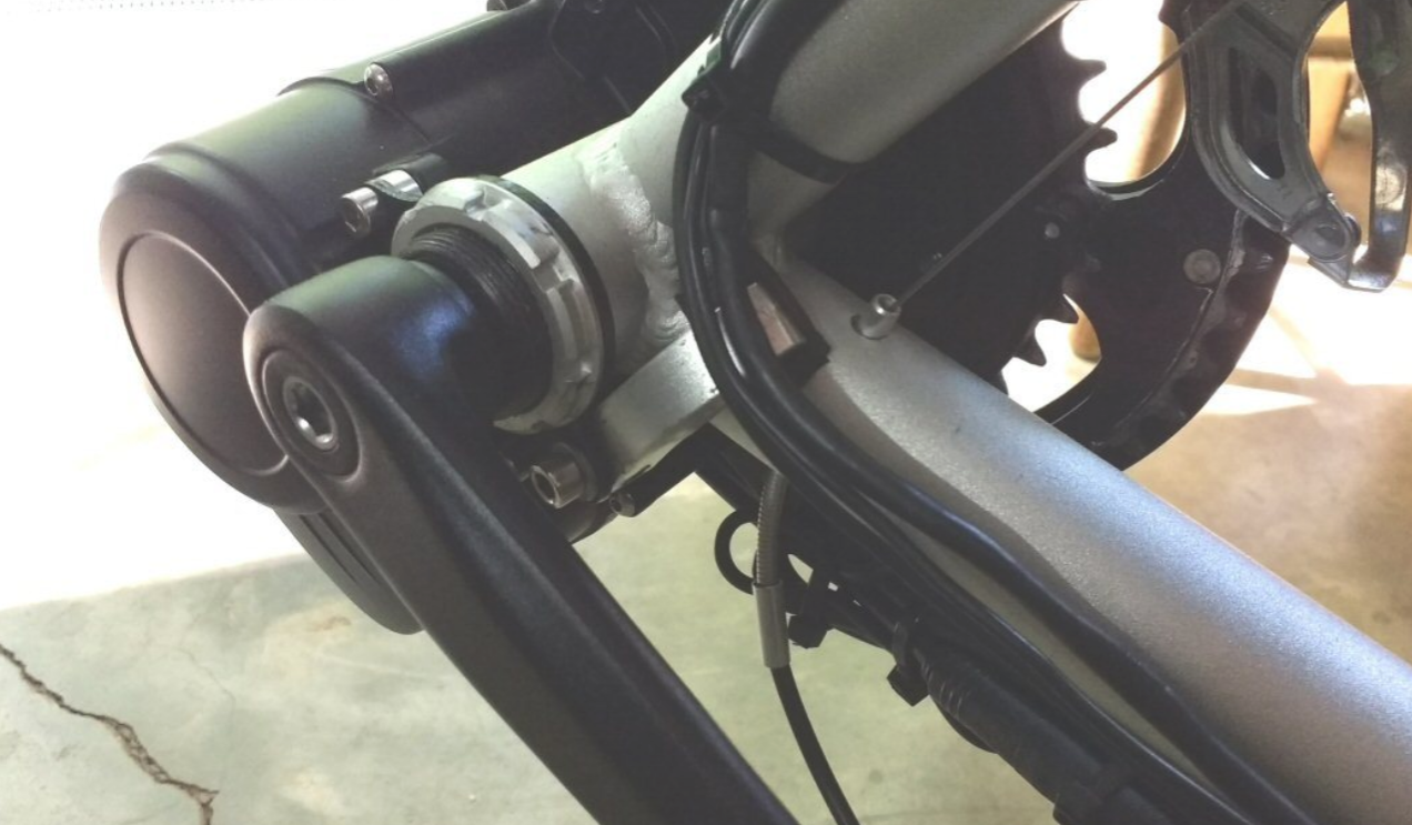

Hello,
I seem to have lost the lock ring on my tsdz2. Ive mounted it without this silver ring screwed on but I would prefer to have the support of a lock ring. Anyone know where I could get a replacement? Or do you know another solution solution to keep the motor secure?
The lock-ring I am referring to is the silver ring screwed on in this photo.
Have you tried the vendor where you bought it? If that doesn't work member eyebicycle may be able to help, or the bafang bbs ones fit also, lots of vendors for those
I tried the bafang lock ring, but it was too small. Are there other options out there? A double setup like the bafang seems ideal, as the single backs out even after threadlocker and heavy torque on the nut.
