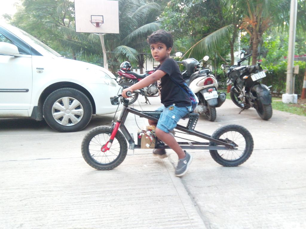

the design of the frame was inspired by the post by adam on lmx bike build
the first bike I built. custom frame 350 w motor

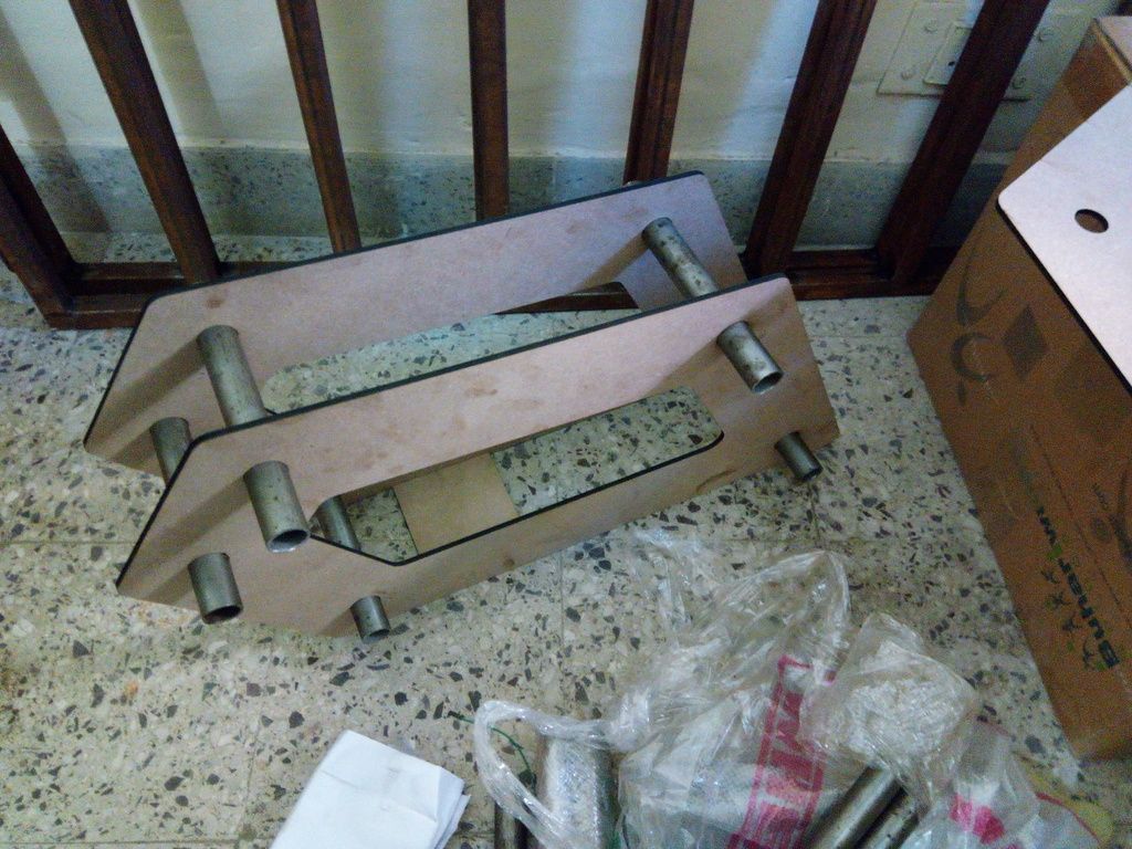

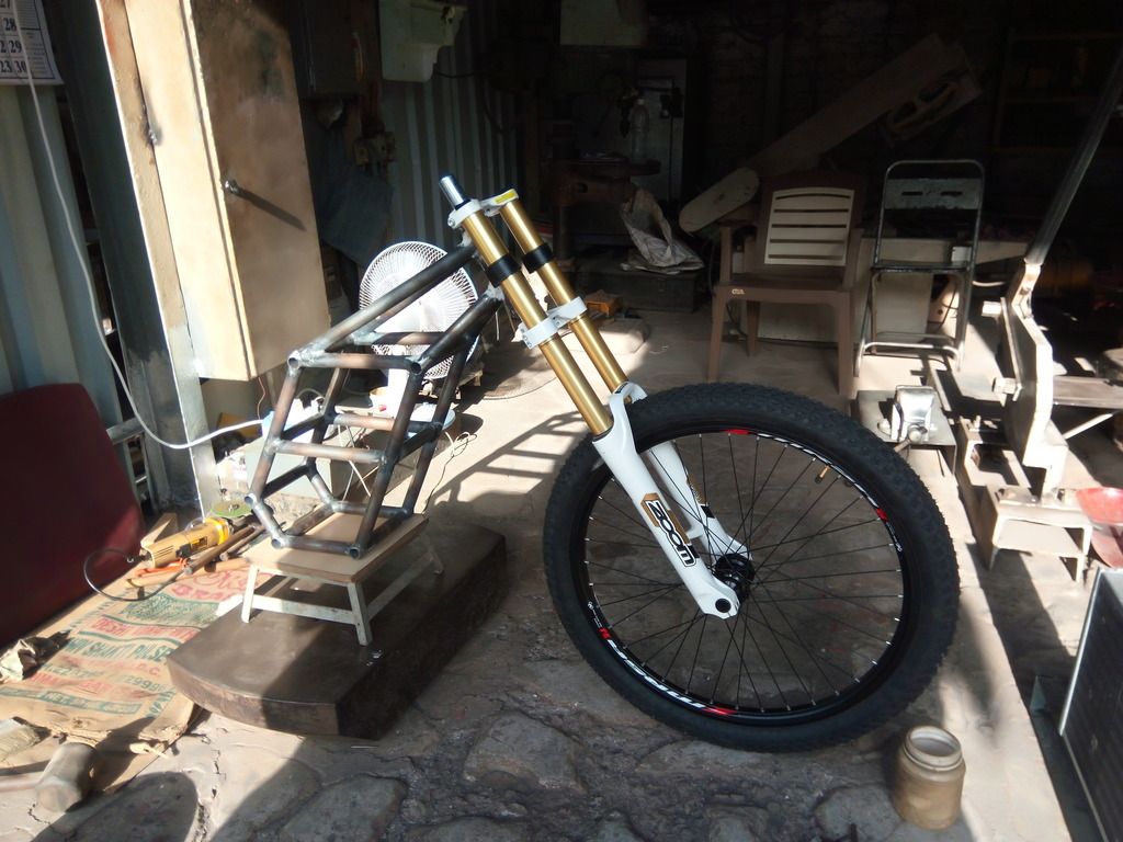

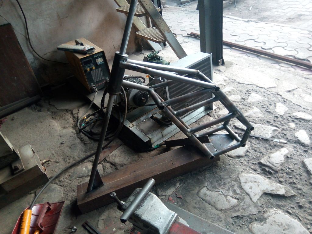

the free ride frame in the making
jig for steering neck alignment
laser cut jig for main frame welding
mock up . tyre was the wrong choice so scrapped it

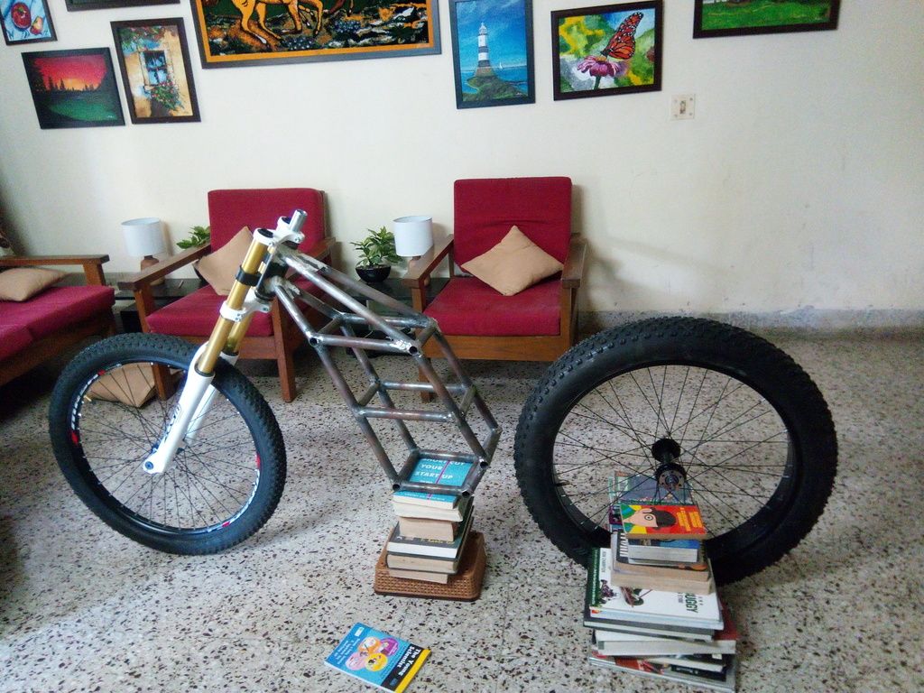

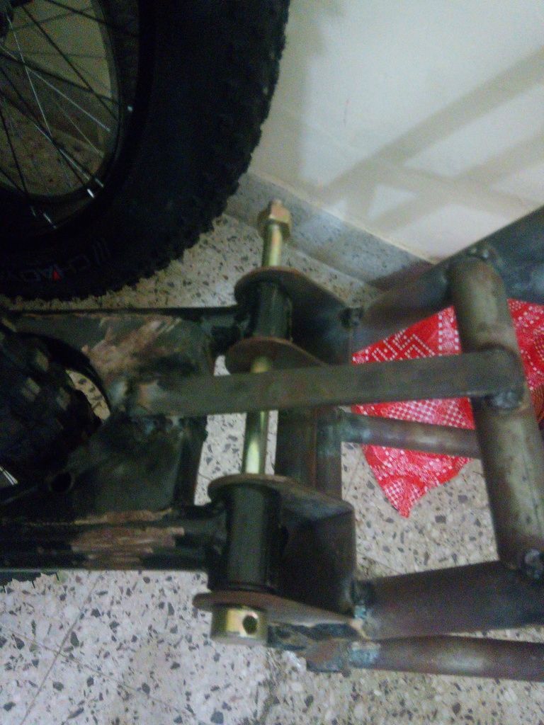

In the meantime the rear swing arm fixed in place. A rod welded just to keep it in position wrt the frame till I get the rear shocks

No the swing arm and everything about it is temporary. I had a couple of days leave and wanted to see the bike with the rear wheel fitted so modified a Yamaha rx100 rear swing arm to accept the rear wheel

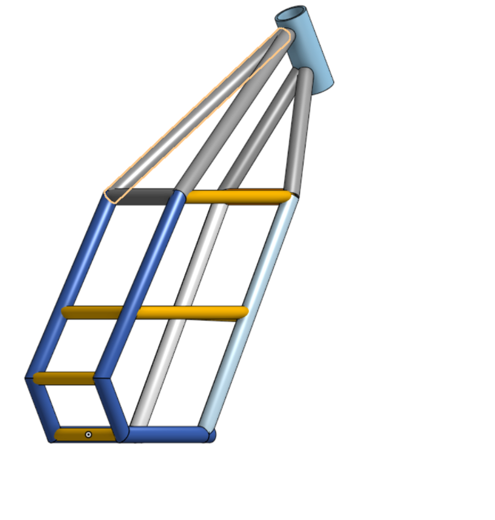

I really liked your swing arm design . Made some CAD models none in agreement with my weight target
I used normal bicycle wheels for rear as of now. Even I want to have something stronger in the rear.

Made these brackets from 3mm mild steel. But I need to make that also properly. Did this kind of a mock up because I was dying to see the bike on two wheels . I've just welded a steel flat bar because the shock hasn't arrived. I have ordered a " Do not move" shock :lol: but not the burner an AOY 36 for rear
Is zoom that bad ???? Found a little on stiffer side actually . Will progress with this one as of now and when I have sufficient funds I'll look for a better model like yours
