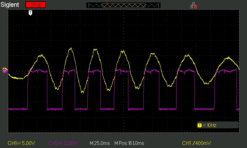

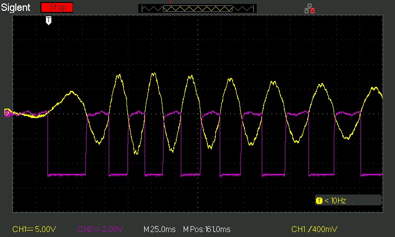

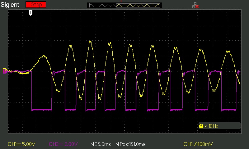

So I've done some measurements with a scope, and here are the results:
I measured between phases on CH1 and between +5v and Hall output on CH2 (I get nothing when I measure between Gnd and Hall output...)
On the last measurement, I think there is something wrong with hall signal.
I had to spin the motor manually, hence the bad shape of the signal. Sorry for that.
That indicates there is a problem with the ground, if you don't get the inverse of the same signal as measuring from signal to 5v.
This could also cause your system to be unable to run the motor correctly.
