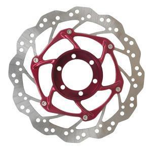

Is it worth paying 60 to 80 dollars for a 203mm Shimano? Or would the 15 to 20 dollar ones be as good? Im not trying to compromise safety to save money but im wondering if there is a huge performance advantage to justify the price or are you just paying for the name?
Looking to get some 203mm rotors.

You are paying a premium for the Shimano name, Tektro's are fine.

what's the $80 shimano? icetech freeza? those things have heatsinks for better heat dissipation
but if you're comparing plain shimano rotors like RT66 they're drilled out too much to save weight. i prefer these
https://www.aliexpress.com/item/32540715682.html

When price is no object, I pick Hayes rotors. And when I need a cheap trash-able rotor, same choice.
Thick, lots of meat to take the heat. they don't bend easy or warp.
And like $22 on Ebay

Are you using regen too? I put on cheap floating discs, 203 in front and 180 rear. I tested on a 17%-19% hill by my house, 3/4 mile descent, then less steep after that, only using front brakes and regen. Rotor was warm but not hot. I ride on a lot of hills, but don’t think I’ll really have situations of staying on the brakes without letting up for long enough for any heating issues, especially if I use the rear brake too.

Some calipers require thicker rotors (Magura, Hope, etc... then you have no choice because buying a thinner rotor night damage the caliper pistons seals when the pads are getting low.
When 1.8mm standard is OK you can buy any without compromising braking performance. It will only affect how long they last and how easy they can be bent. In fact some cheap, softer steel rotors are braking better with some bi-metal or ceramic pads. Then you might notice that, instead of wearing pads, you are wearing the rotor. :roll:
