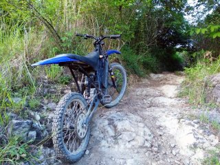

Post by Overclocker » Jul 09 2019 11:18pm
well i built this bike which is similiar to the surron. it's even a bit lighter and holds more cells. total cost was still LESS than the price of a surron even if you include the cost of welding equipment and other tools.
but it sure took a LOT of time :lol:

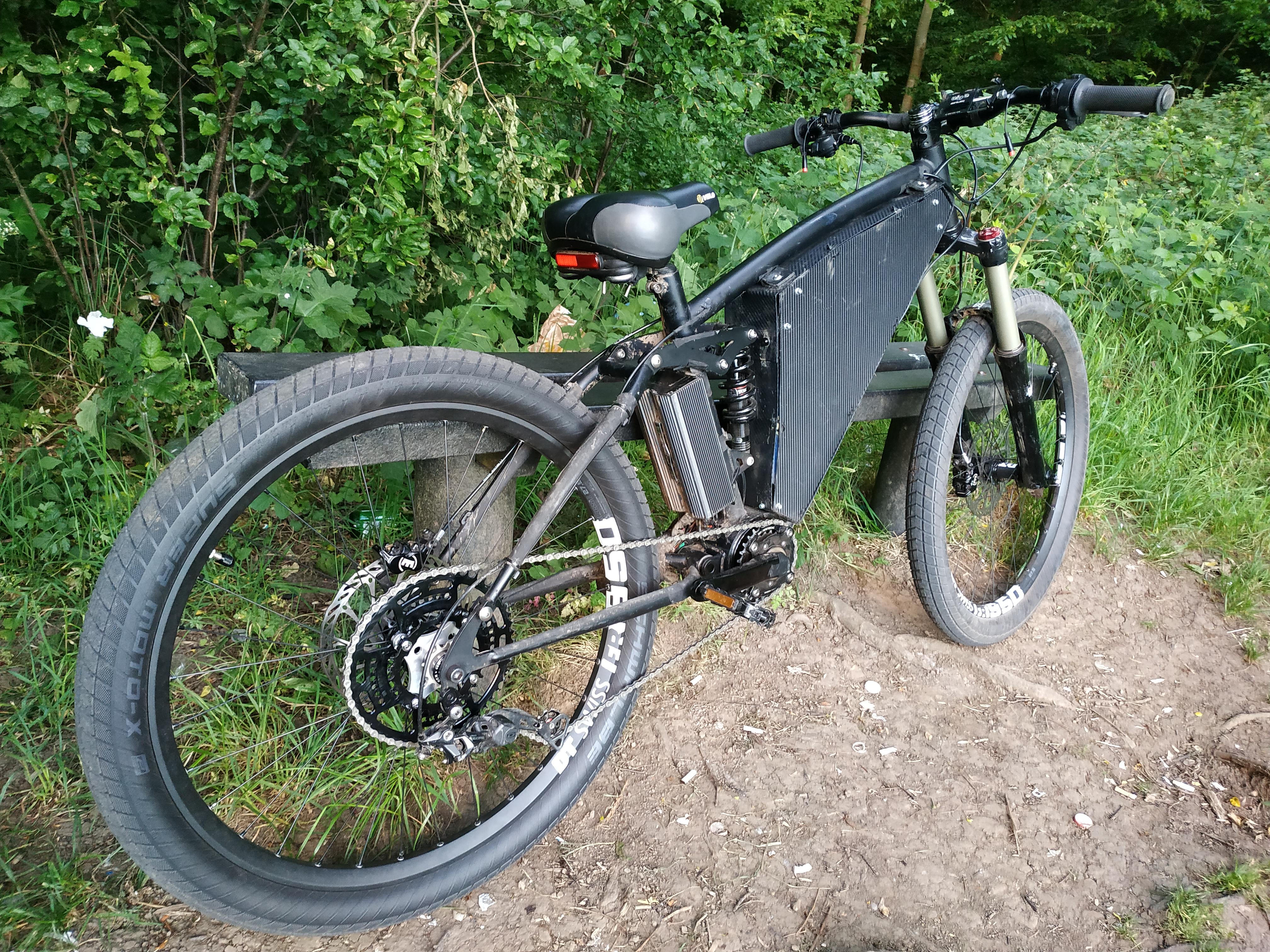

brumbrum   100 kW
Posts: 1356
Joined: Oct 30 2010 3:29pm
Location: Wales U.K
Re: is SUR-RON overpriced/overhyped?
Post by brumbrum » Jul 10 2019 3:32am
This cost me less to put together than a Sur-ron. About 12kg lighter and 10kw peak on 16s. Though i did have some bike parts and a CA knocking about in the garage.

Tommm wrote:
Jul 10 2019 8:09am
Mine also cost less and is ~33kg, about two-thirds the weight of the sur ron. A bit more power too (~6.2kW).
Much more stealth, I commute every day, put it on trains and trail ride every weekend. They even let me in some mtb bike parks (after giving the owners a few joy rides :lol: ).
to be fair though, i don't think that'd be as good in the rough stuff as the surron, nor take the same abuse (frame wise)... thats the cyclone.tw mid drive though right? I'd considered their bikes vs the surron but wasn't sure on the frame quality/strength/ergo, and came in ~5k for one of their complete bikes too (delivered).
