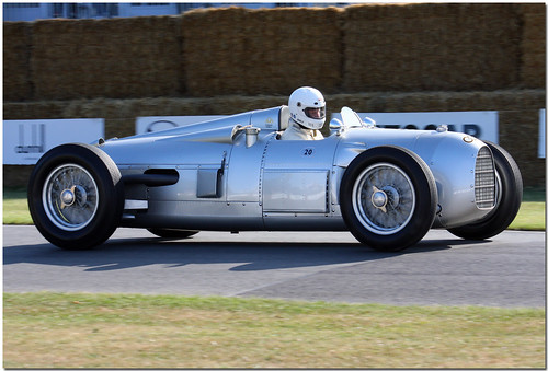

If you are using an aluminum frame, perhaps use part of the frame tubes as the radiator? Drill two holes and have threaded bosses brazed onto them. Un-needed parts of the frame can be plugged off before the brazing. The 1934 Porsche/Auto-Union had a mid-engine, and they ran the coolant through the tube-frame to get to the radiator in the front. They were suprised at how much heat was shed by the steel tubes, and they were able to reduce the size of the radiator.
