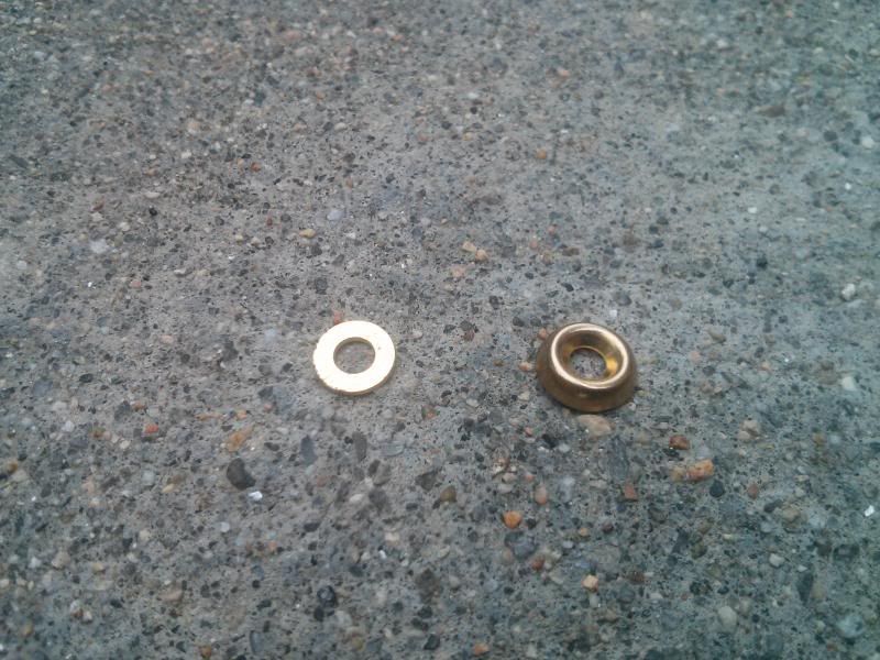

I need washers to put between 12ga niples(4.95mm OD under the head) and an aluminum rim that will be drilled out to 5mm at the angle the spokes will be laced. The rim is double walled so the washers need to have an OD of 8mm or less to fit past the first wall of the rim... (I doubt it would be better to drill out the outer wall of the rim)
Either I hunt for the ideal hardware store brass washer/auto store aluminum washers in the area or I get proper rim washers real fast... I just want the strongest, lowest maintenance rim, for low cost. noise and weight aren't of much concern.
Any sources for specifically 12ga rim washers in the north east or Boston? Or anywhere for that matter?

here are some potential candidates. The finish washer on the right is a bit bigger then the hole in the outer wall of the rim. Both washers have an ID that's a bit too small

Regarding sizes of washers, #6 is just small enough to not have typical spoke heads pass thru them, but not small enough to actually use--under tension the heads will deform the washers and pull thru anyway. They *might* work for some spoke nipples though.
#8 would probably be too big for the nipples, and is definitely too big for the heads.
#4 might be small enough for the heads but I think they'd still be too big.
#2 is probably a perfect fit, but I haven't found either #2 or #4 locally to try them. I dunno if the odd# sizes exist but if they do maybe they would work even better.
(I tried the #6 on a Crystalyte HS3540 hubmotor, using the Grin Tech Sapim spokes, because the flange holes on the HS are HUGE and can pass the whole spoke head right thru them. :( With the washers it's a little better, but I can only lace the wheel with the heads out on the flange, not heads-in like I wanted to for a "wider stance" of the spokes for what should be better side-loading ability.)
Oh, also, stainless washers bend pretty easily, so I'd recommend heavy duty ones, like the Grade 8 or something.

hmmm... I think I ended up using #10 SAE washers because the inside Dia of them is 5.5mm and the shafts of my 12ga nipples were 5mm. The wheel is built and looking good, MAC hub, 100mm Wide rims, 12ga spoke in a 1-cross pattern and crossed over from left to right. All black!

I was just over at your other thread, and yeah some of those washers under the spoke heads look a bit iffy.
Maybe you could double up on this type of countersunk washer. That way you would still maintain the same bend in the spokes leading up to the head, but you would still have thicker material holding onto the spoke heads.
