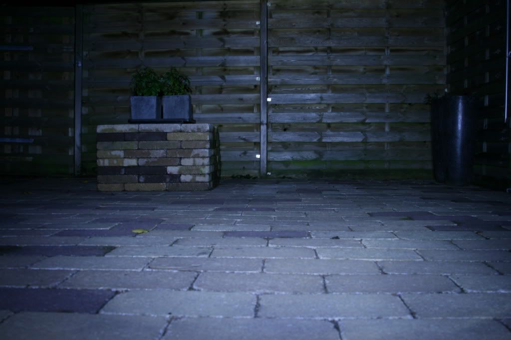

I have a good reference fo you guys.
picture 4W cheapy led same as mr16
and my MC-E 700lumens powerled
both pictures are taken with a Canon 450D with he same exposure ,ISO Aperture values

Mr. Mr Kang, are you sure you're using the same globe that I am, my results seem much more optomistic to my eye in real life than your pictures seem to convey with the 4 watt. No offence and with all due respect (I enjoy reading your interesting post's).
I wonder if the output from the p7 LED drops off after some use, I don't know anything about LED age vs output. I've been using mine for over a year now on high beam.

thewmatusmoloki wrote:Hey, no worries Blackarrow. :D
You didn't offend me at all and I was actually pretty happy that at least someone responded to my thread (cheers too Grindz145, Oldhaq).
I bought those MR16 at dealextreme 8.02$ a piece http://www.dealextreme.com/details.dx/sku.30208
If you power your p7 with the normal current of 350 or 700ma and give it sufficient cooling then it will last as stated it the specs.
I use 2 MC-E leds which are connected in series and then powered by a DX buck convertor. it is powered through my 4S lipo and it gives 1A to both leds.
The MR16 are good for riding in streets with lights above you. but wen you drive completely in the dark..than they are insufficient...at least for me they are.
