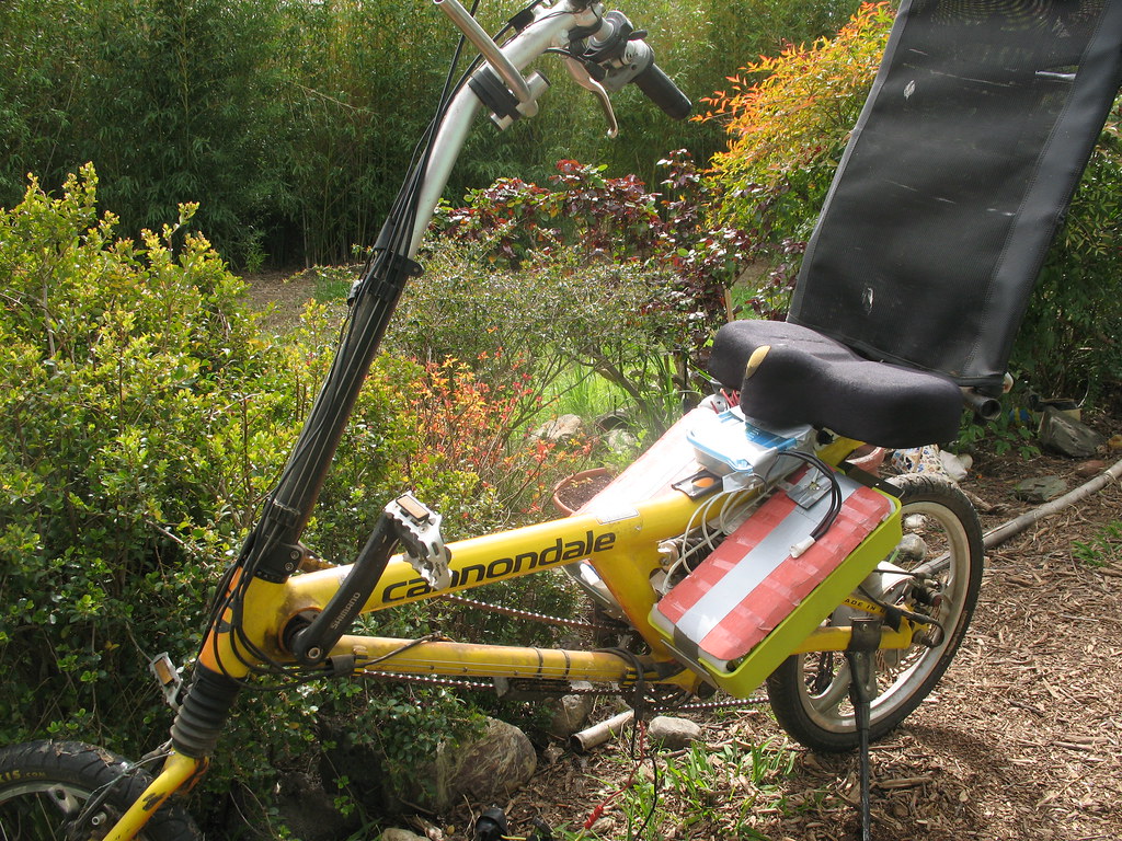

Post by jmygann » Dec 03 2010 10:05pm
48 volts ...20 amps ... 24 mph

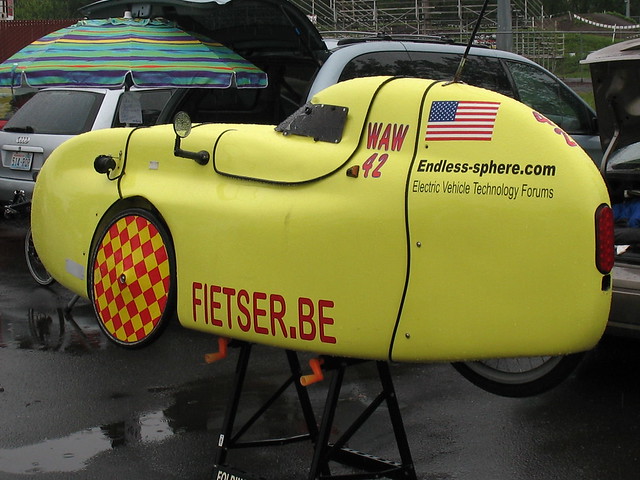

Post by mi7d1 » Dec 06 2010 1:50am
In 2008 I raced in the ePower Challenge with four 12v 18Ah SLA batteries (48 lbs) and a C'lyte 406 hub motor in a 26" wheel. The track had two feet of elevation gain and something like 12 corners that killed time due to wheel scrubbing of a tadpole trike. My race results were as follows;
4 12V AGM 18Ah
23.4 miles race distance in my category
34.2 mph/max speed
31.1 mph/avg speed
335.7Wh--->14.28Wh/mile
The following was the readout of my Cycle Analyst at the finish of the race;
20.51Ap
44.86Vm
969.2Wp
6.951Ah
50.5V resting voltage at end of 23.4 mile race.
Race time was 45 minutes 10 seconds.
In 2009 and 2010 I used a 36V Headway LiFePo4 pack (20 lbs) with a 408 C'lyte motor driving the bottom bracket and my race results improved in efficiency but dropped 1mph in over all speed. The biggest difference was that by using a bottom bracket drive I could climb any local hills in the area now.
