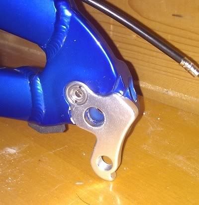

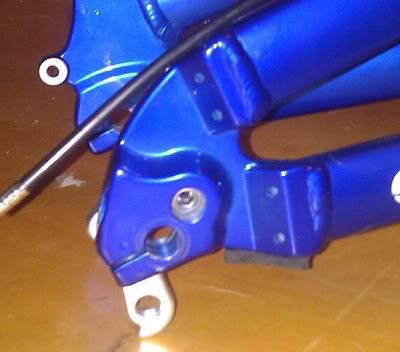

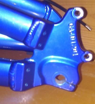

I've noticed the dropouts , it's actually a 12x135mm maxle, only the 2005 model and replacement swingarms are 12x150mm.
It's the same design as the 20mm front maxle.
I'm not shure what I'll do with the dropouts.
This one http://endless-sphere.com/forums/viewto ... =6&t=15439 has welded dropouts.
Doc's DH-comp has custom made plates with dropouts glued(!) to the swingarm.http://endless-sphere.com/forums/viewto ... 3&start=60
I would like to have clamping dropouts , so I guess I'll have to get two plates machined.
The left side is easy , just mill down the elevated area on the outside and put a steel plate on the outside. the right side however..

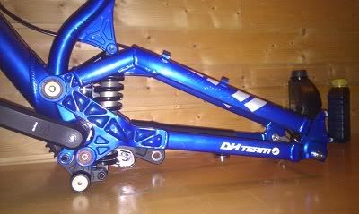

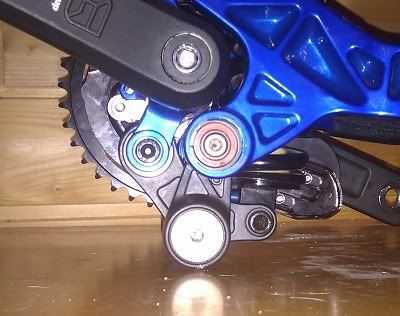

Post by manitu » Apr 23 2011 12:36am
Still not shure what to do about those dropouts. Would prefer not to weld , as the frame is made from aluxx sl , basically a 6000 alu , with added copper. It's supposed to be heat-tempered and quench-cooled after welding , wich would mean a new paint-job.
Pictures: The frame and swingarm design.
Image Image
Here you can see the linkage wich drives the shock. Nice and progressive through the first part of the travel.

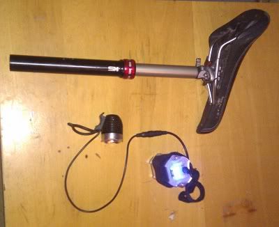

The telescopic , remote controlled seatpost is genious . just adjust it for pedaling in the top position , the drop it for offroading.

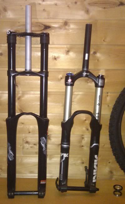

Forks.I'll use the 888RV for the mock-up , but I'll change to the 888RC2X wich is currently on my nomad, when it's time for test-riding. I'll be testing the bike with the RS Lyric too , just to see how much the high-speed shimstack improves the handling. If it's significant , I'll drop a AVA cartridge in that 888RV.

@Mark_A_W :
You mean , you welded the axle holes and clamp? Not the steel to the aluminum?
I've been thinkin about either welding the axle hole and clamp and grinding 10mm vertical dropouts , or grinding out vertical dropouts from the axle hole , 14mm wide. either way , I'll use steel torque-plates on the outside.
But those dropouts are like 12-13mm thick! + the gearhanger on the right side.. So:135mm wheel + 25mm dropouts + 6mm gear hanger + 2x5mm torque plates + a shim to make space for a 7 or 9-speed freewheel an maybe load-spreading shim on the other side to , say 3mm total.
That's 179-180mm of a 195mm axle.. Something has to go , at least 5-10mm.
The torque-plate will have a torque arm up between the chainstay and the seatstay + two bolts into the plates around the axle. I think..
Thanks for the input , Whithout the people on this site , I woldn't have started this build at all.

Yep, the axles holes and clamp are welded, the torque plates bolt on. I didn't do it, a bloke named Kurt did it for Voicecoils - read through my thread (link in signature).
And yep, you need a wide axle motor. Crystalyte or BMC/MAC. And with a 205mm MAC axle, I can't fit spring washers, just the nuts (I HAVE to use Locktite).
