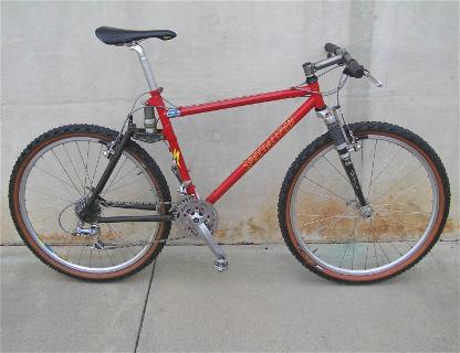

HAS ANYONE HAVE A GOOD IDEA FOR A SUITABLE (MEANING LOTS OF FRAME AREA FOR BATTERIES) FULL SUSPENSION FRAME?...I really like the Pivot Firebird but batteries must be placed on rack which is not ideal

The lack of space because of the rear suspension is a real problem. I have been unsuccessful in my search for such a frame. On Friday I ordered 2 of these;
Today I bought a used one for $60 so I won`t have to cut up a new bike to satisfy my brain fart. I am going to move the suspension shock/spring, behind the seat post, so I have the entire triangle for a battery. This means moving the pivot points for the swing arm and rear suspension, back @ 10". What can be the downside of this?

Gordo,
Lengthening the wheelbase is great. There are some issues though.
Moving the pivot point is likely to create chain issues. eg The length of the chain required will change as the suspension compresses. The extra length could cause the chain to bang or rub on the chain stay.
The biggest issue will be in handling. Moving the location of the saddle reward will probably cure most of the issue, but allow for a lot of adjustment because it's a bit of a shot in the dark. Since that also changes the relationship to the pedals, you'll probably need to lower the saddle too.
Once you get the weight distribution and distance to the pedals how you want it, you may still not like the handling because you've changed the geometry of the bike. With the steel MTB that I added 16" to the wheelbase, I ended up hacking off the headset to decrease the head tube angle. I probably went a bit too far and created too much trail at just over 4", which makes the bike a bit sluggish and awkward at very low speeds, but at anything from 10mph to 60mph she tracks like on rails. I also went with a motorcycle seat, so I can fine tune the ride by moving my position on the seat slightly. This comes in handy with the various loads I carry. It's also nice to change positions for ass relief on long rides.
I know you can pull off whatever mods you want, so I look forward to what you come up with. If you have second thoughts though, I see lots of room for batts without changing anything. Batteries mounted saddlebag style over the top tube works surprisingly well. You also have some room in the triangle and below the down tube, so don't feel obligated to hack into the bike just yet.

You can easily lengthen the rear and not alter anything else, there' s a
young French chap that's done a great job with lengthening one of
those 4 pivot point rear ends AND in doing so moved the shock
behind the seat post (apologies his nick alludes me dammit, I read all
his threads too) .. plenty of room in the triangle for lipo, some nice side
covers and she would be stealthy looking e- bicycle. ... best of luck with
it Gordon

John;
Tomorrow I'm off to the shallow end of the swamp we call Canada and hope to visit with DocBas. If I have time in the morning, I will take some quick measurements of this frame so I have something ebike good to occupy my mind for 10 days. I know dam welll I should just pull a Timma and do it right the first time, but I will hack and fux up the first try, as usual. Too old to start doing things correctly the first time. I am kicking myself for giving away my 4' x 4' x 3/4" thick steel table, because I will now have to build a jig to keep things straight. I'm also going to get my 16 Ton tube bender back asap.
I will take my battery packs apart and see what I can do for fitting them in the frame. This takes all the fun out of watching Aluminum twist and bend as the heat goes in and out or it.
I will definitely ask you about angles and spacing, when I get to that point.
Kim;
This post stuttered and while it was bouncing around, I got off the couch, found a pencil and ruler and did some measurements. I would leave the seat post where it is and only have to move the pivots back 6". Even 5" could do it if I had to.
I will go looking for the guy in your reference.

I just took it like a dog, and resorted to saddlebag style battery boxes attached to the side of the frame. Various reasons for it, particularly the abilty to swap to fresh charged batteries in about 60 seconds.
While riding along yesterday, as usual wishing the boxes were just a bit narrower, I realized that a different lipo pack would make a narrower box possible. Instead of 5s or 6s packs, you could build from 3s packs. Then turn them so the narrow side is parallel to the frame. Vilola, the box would be longer, but at least an inch narrower for the two boxes and the frame.
Frome what I see, none of the full suspension bikes that still have a large triangle have one big enough to really hold enough battery for long rides. But if you only want to carry 5 ah, then it's a much different story. It just depends on the situation. Long ride to the trails, or short blasts around trails that ar more like a track you do laps on.

I'm also looking for a full-suspension frame. Since batteries should be down and center, I looked for frames where the rear shock is at the top of the triangle. Bottom of triangle would then be free space. Even this configuration won't suit those who need the entire triangle for batteries. But like dogman said, you should be able to fit 5 Ah of batteries below the shock.
Cube AMS
Ghost AMR 9000 (except Lector variant)

if looking for a frame, i would also suggest looking for a frame with STEEL dropouts.
i'm looking for a downhill frame, but can't find any. all of them i've seen so far have a very "compact" frame to better withstand the forces i guess.

Only the cheap mongoose blackcomb has steel rear dropouts, and it's an old school y frame.
But John in CR fabricated a very nice extended length rear swingarm for his cannondale frame. That's pretty much the best option, if you really want a steel rear end on a DH mountainbike. Build it. Once you are getting into high quality, high wattage builds, the cost may be less than you think to get a rear swingarm fabricated. Nothing compared to what you are about to spend on batteries and fried motors.

The swingarm is steel.Gordo wrote:The lack of space because of the rear suspension is a real problem. I have been unsuccessful in my search for such a frame. On Friday I ordered 2 of these;

Just took a close look at the CCM bike. Looks OK, but it's no DH bike. Same basic rear suspension geometry as the blackcomb which is good. The 4 bar link really helps improve the ride given the same cheap pogo stick shock. The rear dropouts may be steel, but they aren't as wide and flat as the mogoose ones, so slightly harder to install a pinch dropout. The CCM I looked close at had rim rear brakes, but there may be disk mounts. I was looking at a poor video of one on y tube.
All in all, a suitable FS with steel rear drops for most riders, but not suitable for somebody wanting real suspesnsion performance, and like the blackcomb, it likely has a lot less lateral stiffness to the frame than a real DH or quality crosscountry FS frame. The vid I was watching mentioned an MSRP of $400.

Our MSRP is $449 and with tax bcomes $503. The sale was $180, tax in. This is why I ordered 2 and Arlo ordered one. The used one I bought had rim brakes, but the new ones have disks. The bracket for a caliper is on the front forks of the used one and I got the parts with it. The purpose of this bike is road riding in comfort. No death defying leaps into space. I just need some more suitable tires for the road.
Arlo has a nice flat plate with pinch clamp designed and it is easy to weld onto the rear dropouts. Doing this may also reduce the amount of stretch needed for the suspension.
