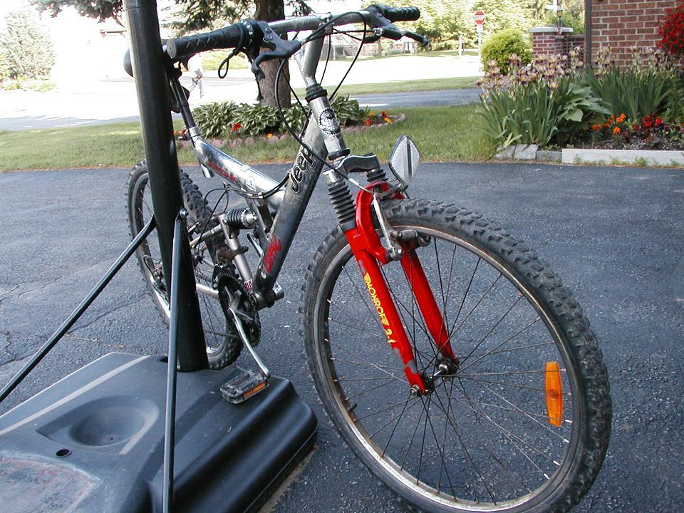

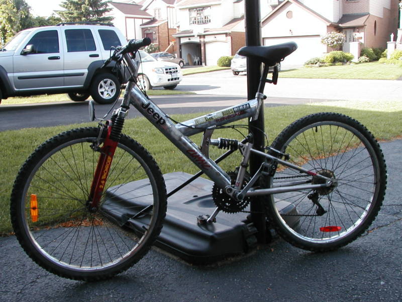

Considering electrifying my old bike - it was cheap I know, only cost around $100 almost 10 years ago from Sears - it's only slightly rusted. Would put on a 48V 20Ah LiFeP04 pack for longevity. Need to find a rear rack that would fit it. Not sure where or what controller to get - also not sure, do I really need to worry with a custom build about the 500W limit? I'm in Ontario...
Similar bike seemed to be doing ok at 36V 500W here:
[/quote]
I believe it's a steel frame - I'm hoping to do around 45kph to match the speed of an Interceptor but with a custom build.
