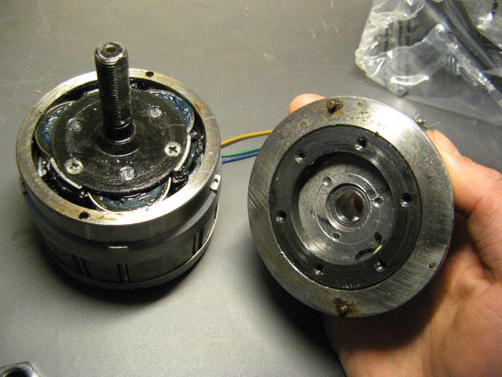

Has anyone ever seen a gearless friction drive planetary except the NuVinci? Opened up a so called "geared" sensorless hubmotor a Q126-SWX, reated at 36V, 210 rpm and 6.1amps
The ratio is about 1:10 I guess
I'd like to see how this performs at 72V
I ask myself if a KU123 100V caps can handle 72V??

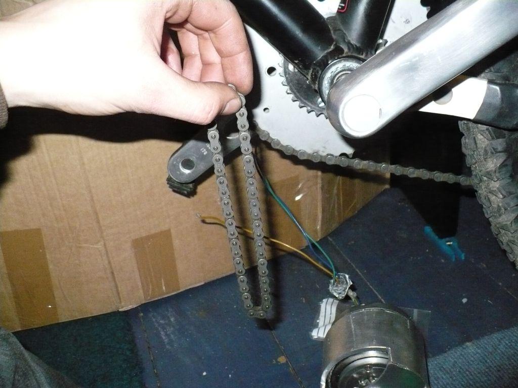

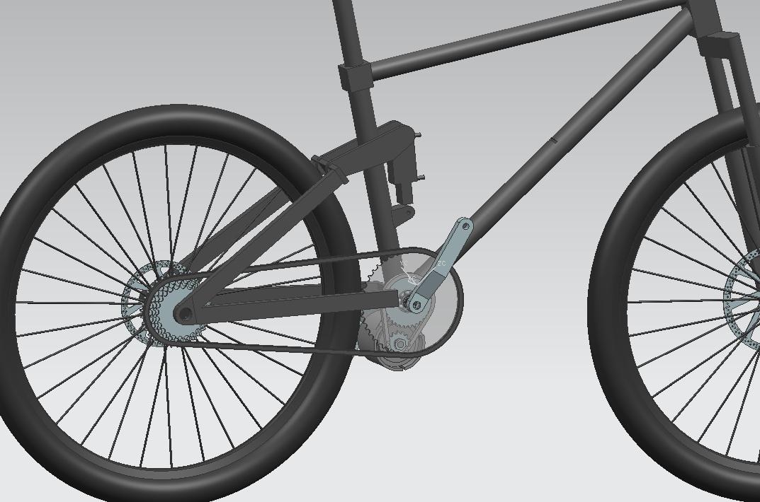

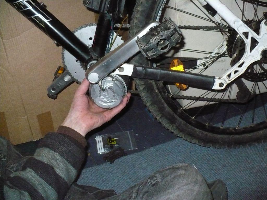

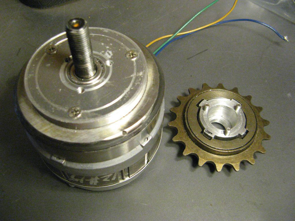

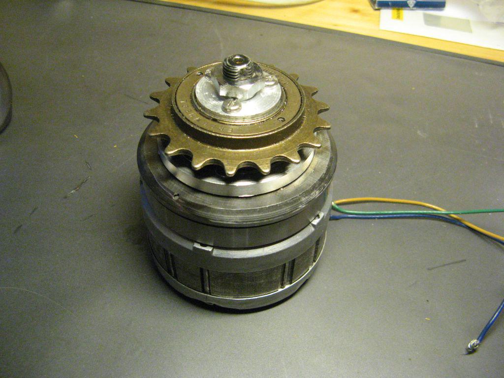

Post by crossbreak » Feb 02 2012 6:42pm

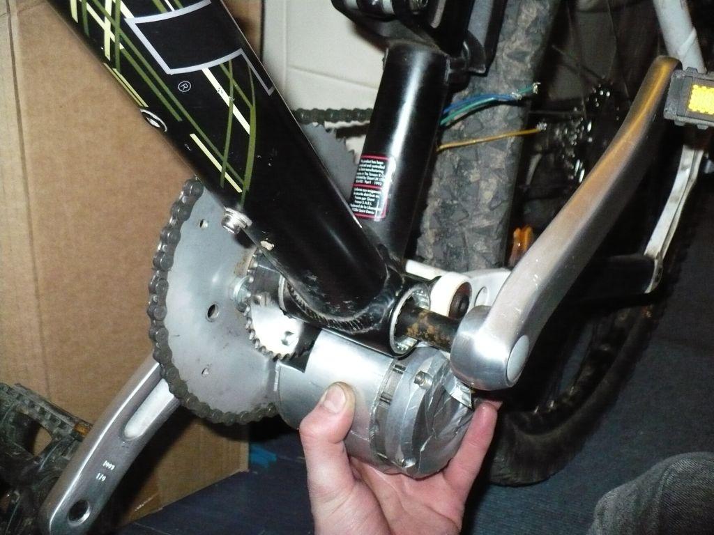

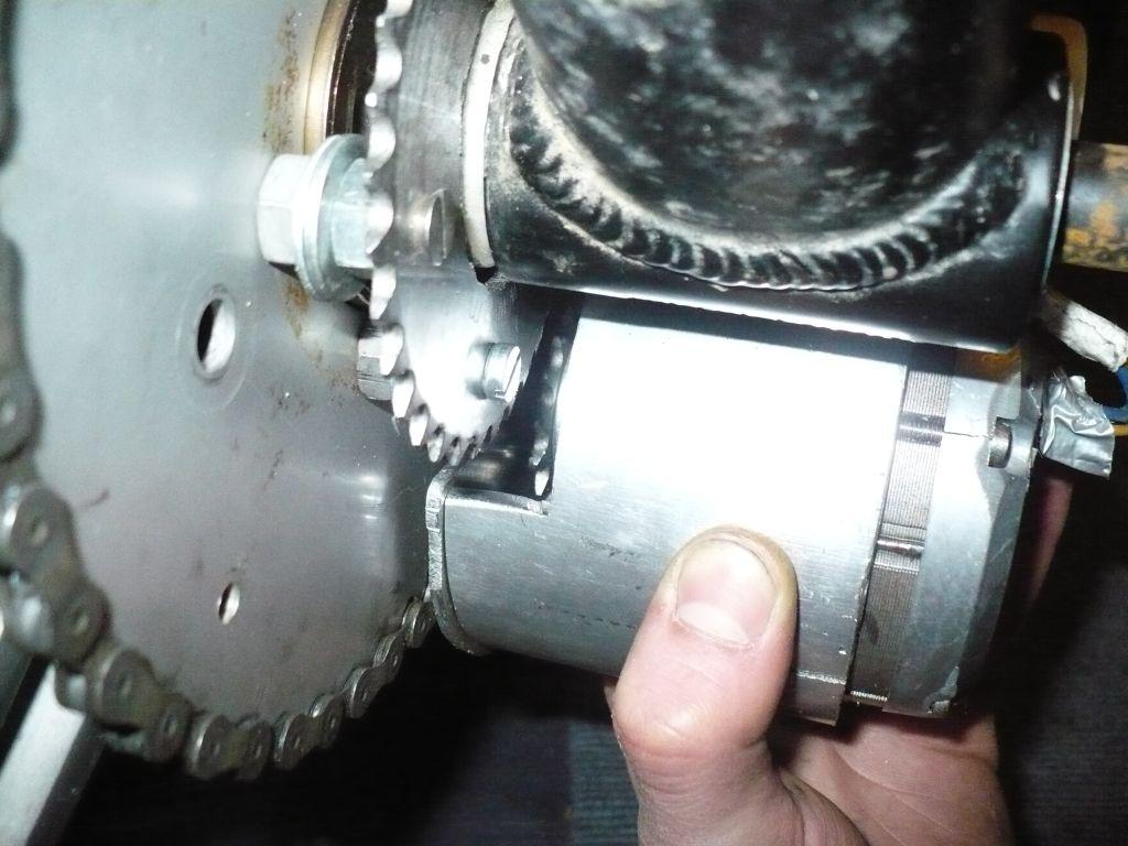

Hey docnjoj !
Thanks for the TongXin MidDrive tip! It's just like I imagine, also thanks to y amberwolf who tried to build that:
amberwolf shows us a 24t sprocket on the motor
I think the sprocket is too large for my purpose
The motor does 190rpm at 36V. I want 100 at the crankwheel. I have 38t on it. So I calculate t=38/190*100=20
I guess I will be lucky with 18.

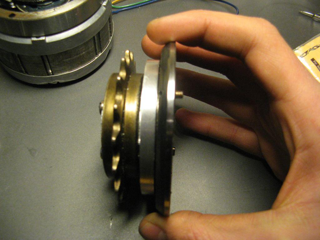

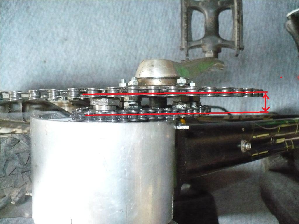

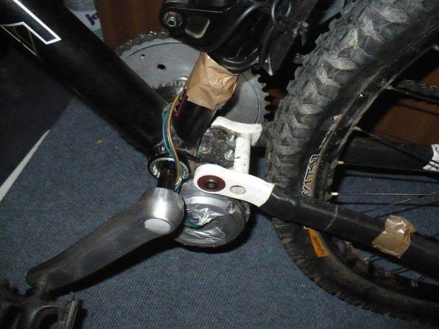

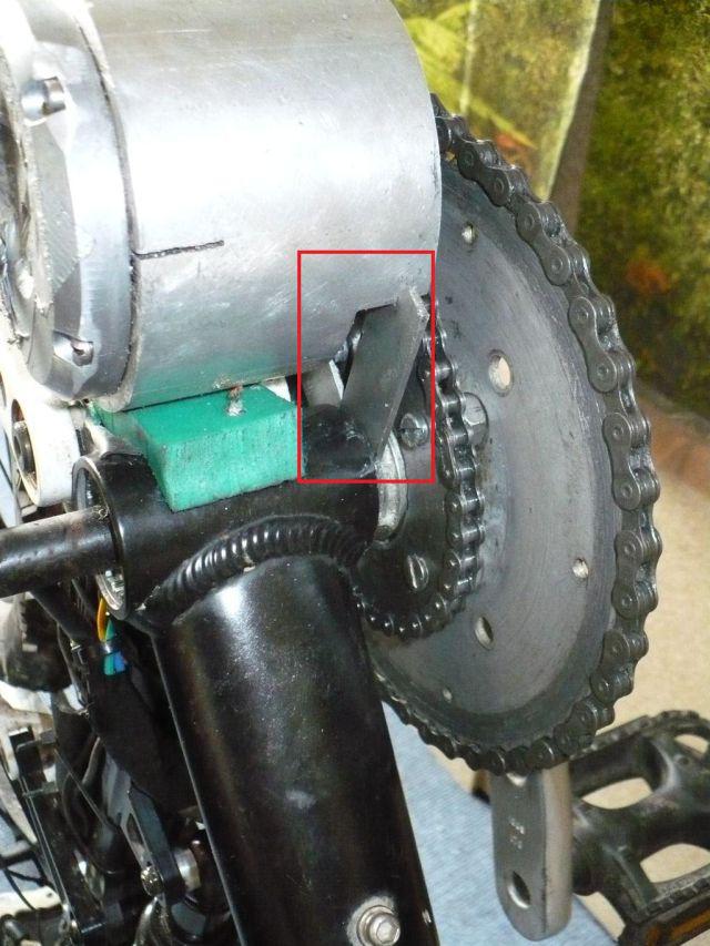

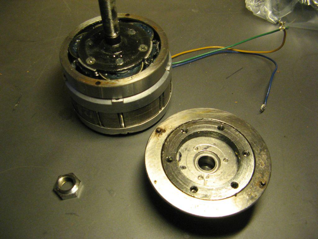

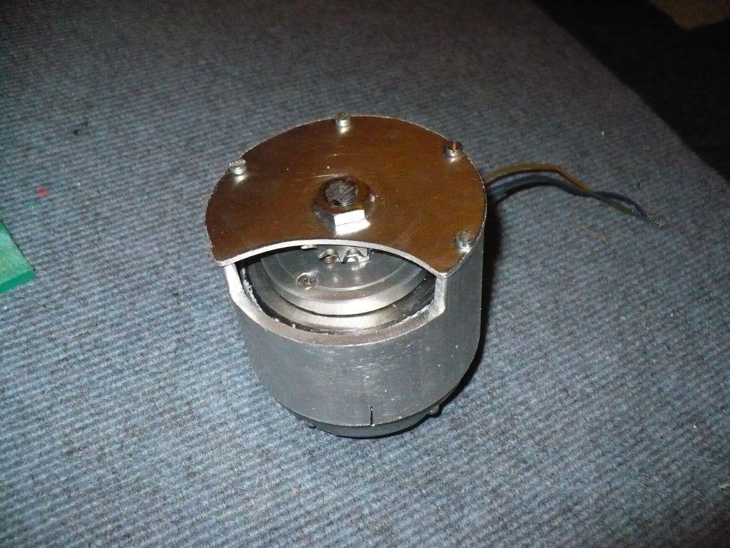

Post by crossbreak » Feb 05 2012 6:45pm
Notice that one bearing is missing. I had only one 12x21x5mm one, I have to buy a second. It should be pushed into the right part in the picture below. Also a bushing which should be between the bearings isn't manufactured jet.
I know that a second freewheel doesnt make much sence, but the one I used has much less drag than the originial one still build-in.

Post by docnjoj » Feb 07 2012 3:51pm
That looks very professional and sanitary, Crossbreak. I will subscribe mainly to see how well that roller motor holds up!

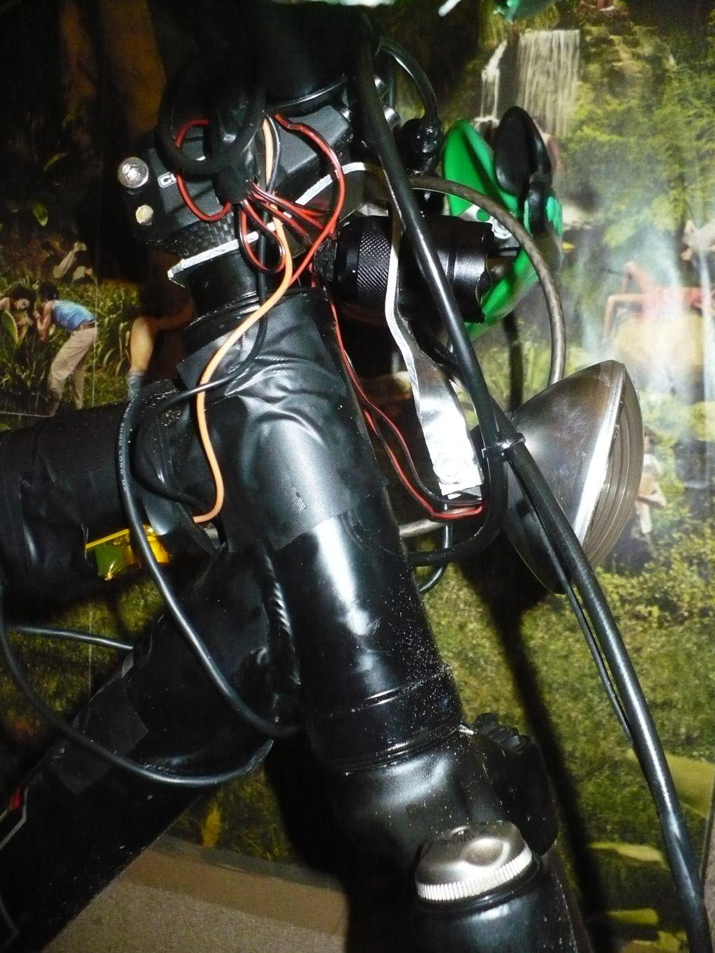

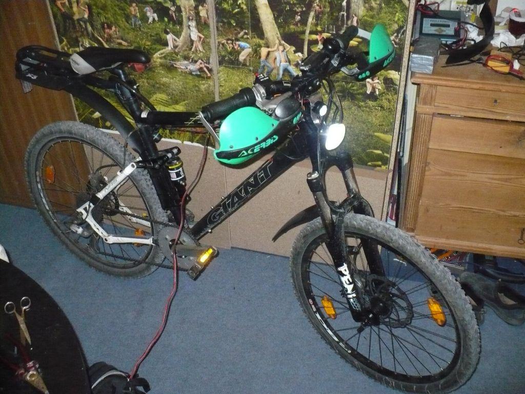

OK! Now you got me :D
I will test this motor in my black mountainbike first, just like the Conhis motor ;)
i mean this one (note my new 130mm fork and 203mm brake rotor :D )
The fork was 40 bucks from the bay, the disk about 10 with shipping from china
I can also recommend the upper head light ( an Cree XML T6 Flaslight front end ), for about 15 bucks with shipping from the chinese bay.

Finished the tongxin motor today (bushings etc.) , next sundays comes the housing. Sry for no pics.
I also started a tutorial thread about the delta to star resoldering for getting 75KV out of the 80-100 KV130, which I hope will be finished next sunday also:
http://endless-sphere.com/forums/viewto ... 30&t=36767

I threw away my primary concept. Not really stealthy. The new one is more :mrgreen:
I exchanged the 18T 1/2"x1/8" frewheel sprocket for a 15T 8mmx3mm sprocket. That way the motor can be mounted below thebottom bracket.
Sadly I couldn't write the WYE tutorial, since I had too much to do. But here's the finished Tongxin motor, sadly I had no time for a mount yet :(
You can hope for next weekend :D
Notice the slots i sawed in to make it possible to push the motor into the extruded 90mm (100mm outer dia) alu alloy tube. The motor measures 91.05mm in diameter (edit: the upper cast piece is only 90.5mm). It was too hard to push it with the bench wise without the slots. I can pull it out again with a puller.
Notice the rather short chain
The sprocket has 15, the chainwheel 35 teeth.
Iknow that this is really thight, but it saves so much place. Let's see how long it will survive ;)

Post by crossbreak » Feb 23 2012 4:08pm
the green mount is made from polyethylen, which was first rasped and heated to 130°C (it gets flexible at 100°C, it melts at 150??) in the oven then squeezed by the srews. Makes a perfect fit.

Post by crossbreak » Feb 29 2012 9:49am
The mounts bend too much, thats why the chain makes noises and sporadicly jumped off. I fixed this problem by adding 2x20mm aluminium bars between the housing and the bracket to keep the distance when the motor pulls on the chain. It's a kind of a chain tensioner, it's not final, but it now works completely silent, the noise from the wheels is louder :D No cyclist or pedestrian I pass recognizes me first if I don't bell
another bar on the tension side of the chain:
The last problem to solve is the load on the front freewheel. It sometimes stalls, it''s bended to hard. the distance between it and the chain ring is too large (I marked it in the picture below). Another bearing between the shaft and the chainring could take this load (it's also shown in the cad picture below)

Post by crossbreak » Feb 29 2012 7:16pm
here you can see the bearing between the chainring and the bottom bracket that i meant.
The 8mm chain was waste after about 90km :( I'll try a 3/8 x 7/32" chain with 13 to 32T now.
the swing arm isn't where it should, but it shows the principle.
