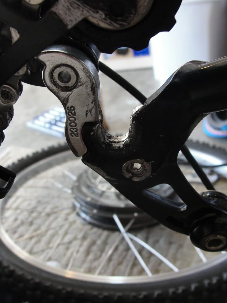

I took a quick ride around the block and noticed how much lighter, smoother it was. The walmart bike I had was a beast, suspension sucked and took up the entire frame. Enough pedaling, time to dismantle it.
I took off the wheel and removed the rusty chain (will need to replace). Here is the picture of the dropouts.

I will be removing my hs3540 motor and placing it on this bike. Batteries will consist of 66v 20 ah lipo pack in a Falcon EV frame. Any thoughts on which Torque arms I should use. I have used some of Doctor Bass's torque arms and although they seem extremely durable, it sort of messed with the rear derailer. Of course I may have implemented incorrectly but was looking for alternatives. Any thoughts?

you could always cut the dropout hanger off the Doctorbass torque arm

I think im going to try a set of e-bikekit torque arms. I cant figure out how I can use the Pair of Doc's that I have.

You said Doc's interferes with the derailer? I'm guessing you are putting them on both sides of the drop outs? I would only run one before I trusted the one you linked. Torque arms follow the ol adage K.I.S.S., Keep it simple stupid. In other words, the more points of failure you add the higher the chances of a failure. At your power levels, one torque arm on only one side should be enough. As long as you are under 72 volts, I wouldn't sweat it.
Now to Doc's torque arm. Can you not grind down the part that gets in the way? Or is it not that simple?

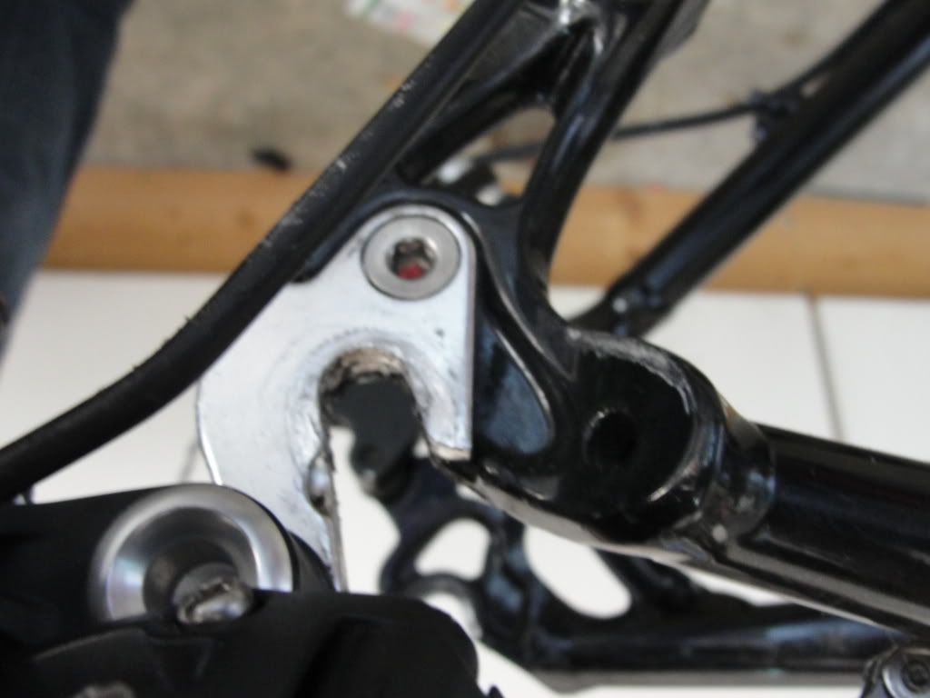

The dropouts on the new frame arent flat like the old set I had. There are dips and curves which does not allow Docs to sit flat. I dont believe I can get enough surface area to mount the TA. I thought about bending the arms out and mount it on the inisde of the drop outs instead of the outside. Is this the way to do it, or perhaps order a new torque arm.

Heres a few pictures of my drop outs.

I ordered the epoxy dp420 from ebay.
