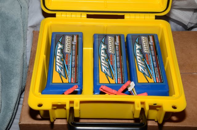

Post by Alan B » Feb 15 2012 4:38pm
Here's a SeaHorse SE300 case:
So how much Lipo will fit?
Above shows one layer of four 6S 5AH plus one 6S 2.6AH, two layers will fit for a total of 1.2kwh
Then with another brand of Lipo:
Above shows one layer of three 6S 8AH, two layers will fit for a total of 1.1 kwh.
In either case the boxes are fairly full but there is some room for wiring and LVC/HVC boards.
It would really be nice to have a setup that would hold either one or two of these boxes on the bikeE. The 100 mile ride would need two, the rest of the time one would be sufficient, perhaps even one that was less than full, or had a charger in there as well.
But how to carry them?

Post by liveforphysics » Feb 15 2012 5:21pm
That's a nice case Alan. Good rigid waterproof package that holds enough LiPo to get around just fine.
Alan B   100 GW
Posts: 7740
Joined: Sep 11 2010 7:43am
Re: ebikeE Recumbent Testing - it's alive!
Post by Alan B » Feb 15 2012 5:46pm
Thanks Luke. They are pretty cost effective too, much lower cost than the nice Pelican cases, and a little lighter though it is hard to compare that. Almost hate to drill holes in them they are so pretty, but that will happen soon enough. :)
