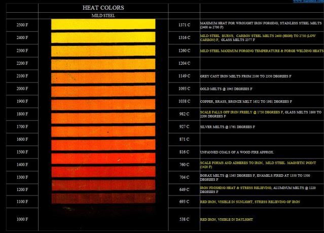

Any possibility of finding a friend who has an oxy welding rig? I really doubt if mapp gas will get it hot enough to allow the steel to form to new shapes easily.
I'll still lobby for the threaded rod and hot heat approach. And i worry that the length of the stays beingso short that the generalized bending approach of the lever or jack might not produce results that you are hoping to avoid.
With the threaded rod - You can work slowly and with lots of control. And you can thus tailor the shape of the assembly so that it is not necessarily symetrical from side to side (which it looks like you will need here in order to deal with the chain line issues.). You could use those big holes just to the side of the axle dropouts, get 1/2" threaded rod, some nuts and some big bearing washers.
If it were me doing this job, i'd go ahead and lace up the wheel and have it standing by while i was doing the job so i could constantly fit and refit it, and explore all the issues that presented themselves. Chainline, brake fitting, & for 25+ mph I'd certainly want an 11t sproket on there.

I definitely agree with you Joe. But I don't have a friend with oxy welding rig. And I don't know if there are workshop in london able to do that.
My solution for now is to use butane torch and car scissor jack. It's steel so it should be ok.
I've seen some butane torch at 1300C. It's quite hot. How hot should that be to bent the metal?

1300 Farenheight is all you need for heat relief.
Do the threaded rod for more control over the bending process.

Can I use this one?
http://www.ebay.co.uk/itm/Jet-2000-C-Bu ... 500wt_1413
It says 2000C but seems to be a bit small for the job
