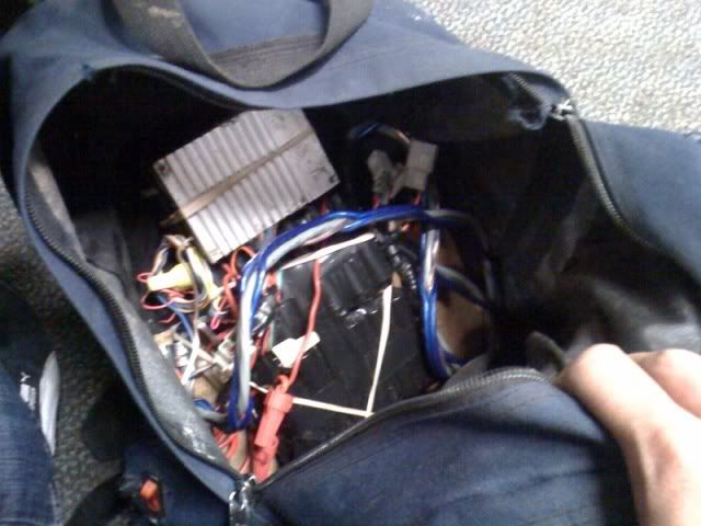

Post by neptronix » Mar 15 2012 2:27am
def215 wrote:Image
Looks like something they'd call the bomb squad on, hehe.
The higher up the weight, and the more weight, the tippier the handling gets. A backpack battery is good in some unique situations, but having the battery weight in the middle of the frame triangle ( well, if you have triangle space! ) is really the best place, IMHO. Feels very natural and balanced.

Lol... I got asked by police (with canine unit) to open my backpack full of LiFePO4 batteries on a commuter train before.
Everyone's eyes grew wide (thinking BOMB :shock: :shock: :shock: ) when I pulled out the packs and mess of wires. Fortunately my battery packs were actually labeled "Battery" so I was able to explain it easy enough. :mrgreen:
