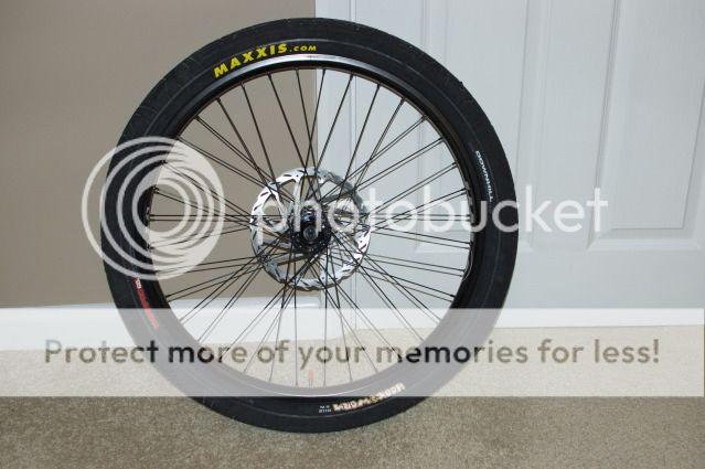

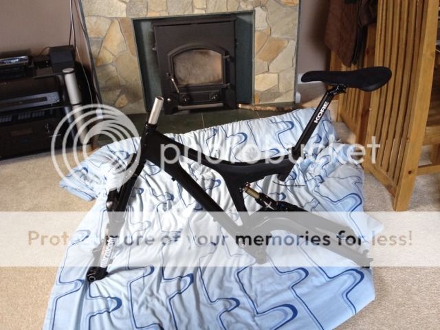

Postby kudos » Mon May 14, 2012 3:31 pm
My first front wheel built!
Halo rim tape, maxxis freeride tube, hookworms.

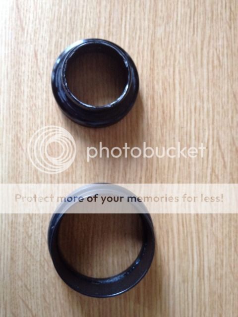

Postby kudos » Mon May 21, 2012 2:19 pm
Well, after weeks of looking for the perfect headset I finally found what I was looking for, a crank brothers opium c direct set in black with a red topcap.
The site i bought it from stated it is sized 1 1/8.
So then imagine my surprise when this turns up:
The smaller one is the cane creek 1 1/8 I took off my frame originally.
The bigger one is the opium c.
So after much searching and measuring, it turns out this is the reducer version presumably for a tapered steerer which is 1 1/8 at the top and 1.5 inch at the bottom. The straight 1 1/8 is only available in silver, no good.
If this weren't annoying enough, the headset came without any seals, I got on the phone to the supplier who has sent me another one, but I only found out about the sizing issue after the no-seal issue.
So soon I will have two headsets I can't use :?
The never ending failures of bicycle part suppliers, I've never known anything like it......

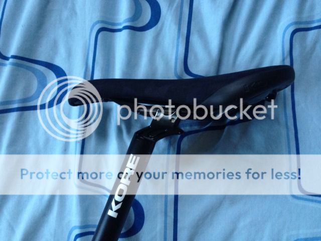

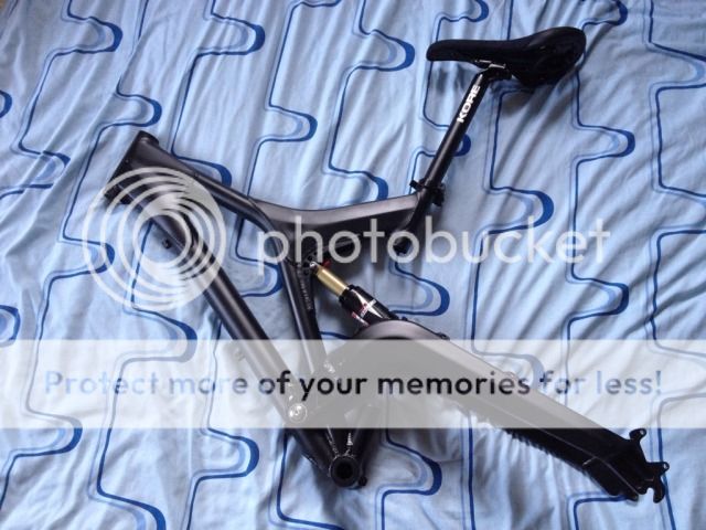

Postby kudos » Wed May 23, 2012 2:07 pm
Kore comfort saddle turned up today after a two month wait. The t-rail is silver so I sprayed it black.
Ordered a Chris King headset today, supposed to be the best.......

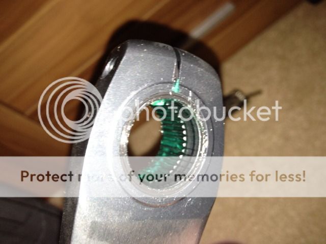

Postby kudos » Sat May 26, 2012 5:25 am
OK I have a question for you expert bike builders out there....
I got my Chris King headset and I'm trying to determine the best way to install it on my frame.
I bought a headset press, I've just ordered headset press adapters which are required to install this type of headset.
My question is about reaming and facing the head tube and if I need to have this done.
The frame came to me with a Cane Creek headset installed, which I then removed. It was in pretty tight but it's the first one I've ever removed one so I don't know what's 'normal'.
I have measured the width of the Cane Creek cup and it's 34.05mm, I then measured the Chris King and it's exactly 34.00mm so half a millimetre smaller.
The fitting instructions say the head tube should be reamed and faced to 39.9mm, I would have to have this done at a pro bike shop, but I'm wondering if I actually need to do this seeing as I know a slightly larger headset already fits?
It would be a bit disappointing after having bought all the tools I end up asking a bike shop to fit it for me, however, as they say, if it's worth doing its worth doing right.
Any help/advice much appreciated...
EDIT : I think I answered my own question with my last truism. I gave the bike shop a ring turns out reaming and facing is a quick and easy job. 10 quid and an hour later and my headset is installed.

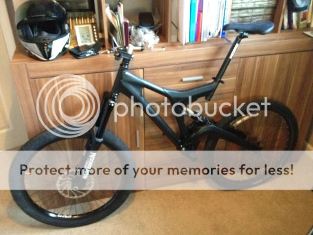

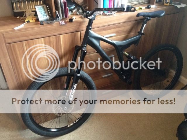

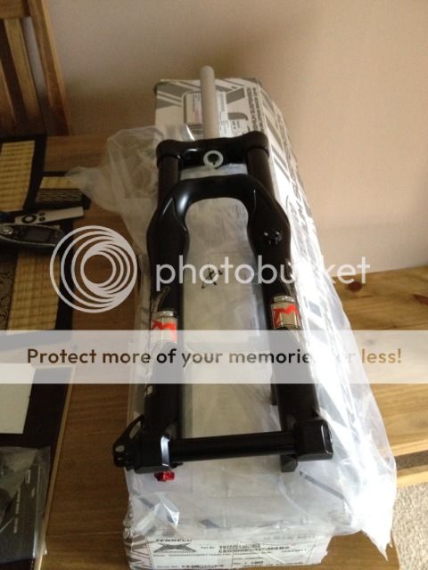

Postby kudos » Wed Jun 13, 2012 6:18 am
Well my 55's finally turned up.
The never ending failure of bike parts suppliers: ordered with 48 hour delivery, turned up TWO WEEKS later :evil:
Considering removing the decals for that all-black look.......

Re: Kudos Build II
Postby 3nslav3 » Wed Jun 13, 2012 9:48 am
Perfect!!! this will badass :twisted:
this fork should be able to take a load of beating ;)
I'm glad you didn't go for a 888 ATA WC from 2008 / 2009 , I used to own 1 of these when I was doing some downhilling a few years back and they are cr*p,
leaking air cilinder after a flat drop, buttons that broke off, they need a load of servicing :( once it start to give problems, it will never end until you trash it
but the 55 is perfect! :D

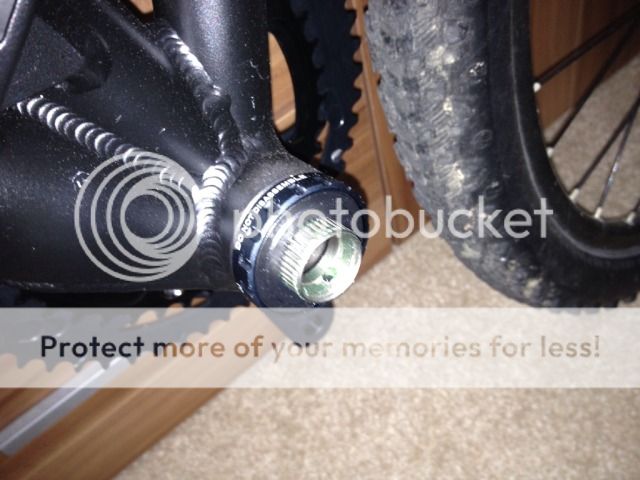

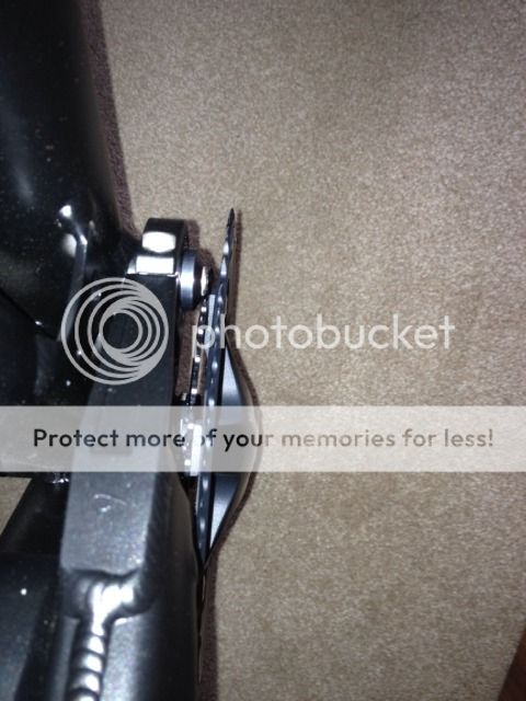

Can anyone help please, I just received my Shimano 105 5700 53T crankset and tried to install it on my bike but it doesn't fit :evil:
A bit difficult to see but the outer 53t chain ring fouls against the bearing for the swingarm if I try to push it all the way in.
What is left on the other side:
This isn't enough spline to attach the pedal because the splines on the inside of the pedal dont start at the edge:
I don't know what I've done wrong, I presumed I could install pretty much install any crankset, but maybe there is a limit to the outer chainring size I can use with this frame?
Looking at Mountain Cycle's site, there were two suggested specs for building up the bike and the cranks listed were SRAM 1400 2x10 and Aerozine X-12, having checked these it would appear the largest tooth count is 42T on both. Can I take from this that I cannot use a crank with greater than 42T ?????
Is there any way I can get my current crankset to work in this situation???
Any help gratefully received !

I've given up on the large 52T chainring, it's not going to fit, I've just ordered a Shimano Saint single speed 42T
http://www.chainreactioncycles.com/Mode ... elID=12907
I hope this fits, these parts are expensive!

HombreNeuvoElectro wrote:Kudos, great build
Like those wheels, did you build them yourself? What guage spokes and hubs?
I see you could not get the larger cranks installed but will a 42T not dramatically reduced the speed at which you can have meaningful peddle input?
I wouldn't have a clue how to make a wheel I'm afraid, bought the wheel ready built from a supplier:
These Halo SAS wheels look bombproof.
http://www.wiggle.co.uk/halo-sas-pro-26 ... mtb-wheel/
They have really cool hubs which are hybrid quick release and 20mm axle.
Yes 42T will have a massive effect but I don't have much choice with this frame. If the Saint unit fits OK, I might also try something larger like a 45T, even though that will probably mean changing the BB aswell.
I'm just going to pedal less by the look of it!
