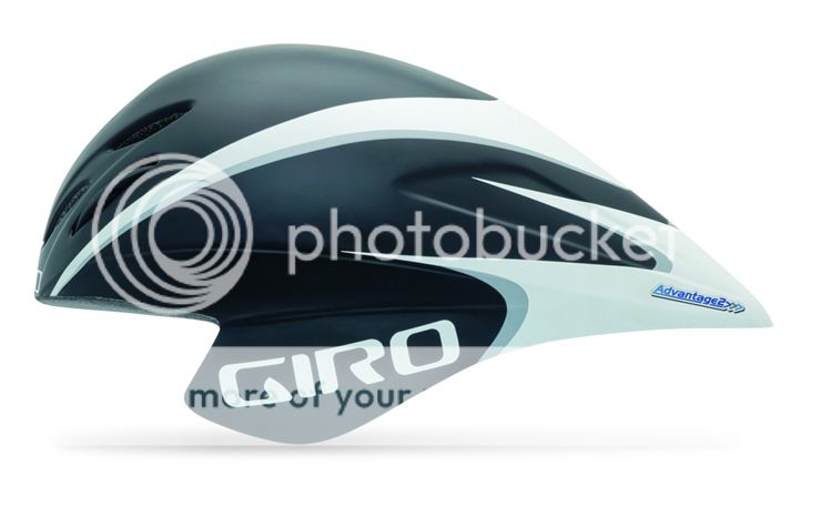

One thing I still want to address is wind noise around my ears. Even with my normally-for-motorcycle-use -35 dB Westone molded earplugs in place there's still a lot of it, no doubt due to the aerodynamics of my head as it goes away with my head turned.
Something Iike this would work but would be ridiculous:
I think a few years back I considered half faced scooter type helmets in this very thread, but then at that point why not just wear my Shoei QWEST full face? Hell, I could wear my hi-viz yellow mesh moto textile armored jacket while at it. Hmm. That seems even more ridiculous...
Toshi   10 kW
Posts: 840
Joined: Apr 08 2008 9:33pm
Location: Denver, CO
Re: Seattle commuter e-bike: 9C 2806, 48V 12Ah Li, 35A Infin
Post by Toshi » Aug 26 2012 3:51pm
Toshi wrote:One thing I still want to address is wind noise around my ears. Even with my normally-for-motorcycle-use -35 dB Westone molded earplugs in place there's still a lot of it, no doubt due to the aerodynamics of my head as it goes away with my head turned.
Just slightly less ridiculous: Giro Advantage 2. $123 at REI, which may not be the cheapest but has a great return policy and a local store...
http://www.rei.com/product/809816/giro- ... ike-helmet
My god, I'm a nerd... :o
