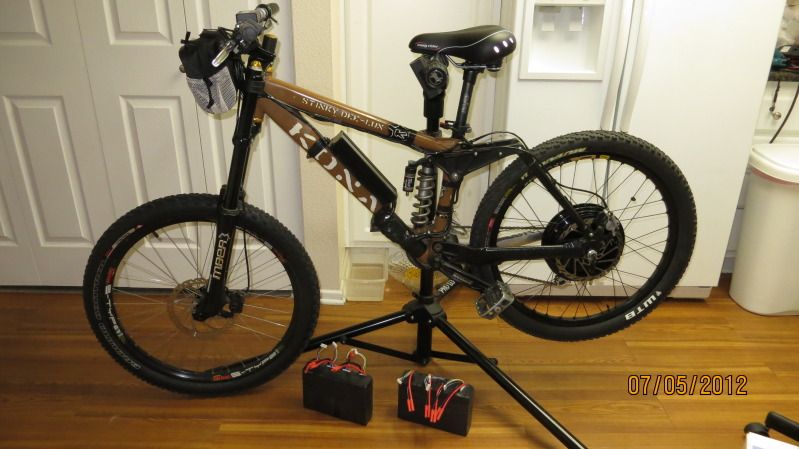

I bought the 18FET 4110 overclocker read Lyen controller for my E-trike. I want to add Lipo and they system I'm looking at is 24s 2P or 24s3P.. Am I asking for issues with this controller? I'm not ready to modify the controller - what's the highest voltage/amps I can go with this controller? Do I need to keep it at 20s for it to be reliable? I was thinking I'd run 40-50 amps. Thoughts?
This is going to be used with a HS3540 mounted in a 20" wheel on a KMX trike.
