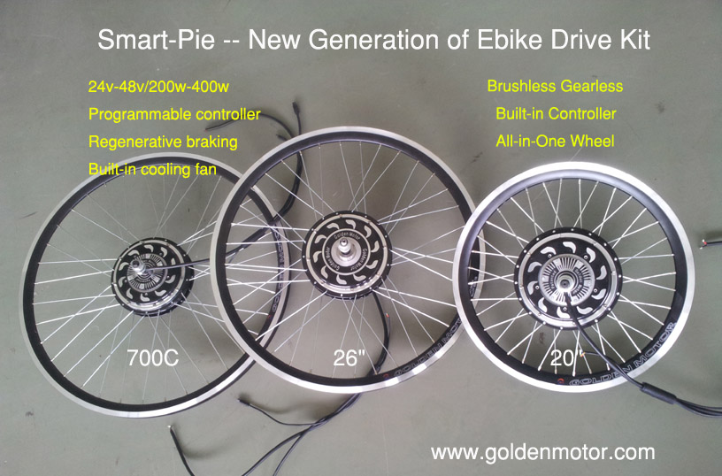

Hello everyone! Just did a search to see if anyone has bought one of these yet. The new Golden Motor Smart-Pie looks smaller and claims to have regenerative braking, built in cooling fan?, be brushless and gearless and also have a built in controller. Sounds interesting but too good to be true. I don't know how long this has been out but have any of you seen this or bought one?

Yep, saw them, they are bit pricey compared to the original Pie though.

Wonder how they will go for peak loading with an external controller versus a MP2? Seems smaller, not sure how much heat a small internal fan can dump....

"No easy broken plastic gears inside"
is not advantage LOL.
4.6kg its like same directdrive mini-hubs from conhismotor.com
This type of motors have less efficienct than DD. Big heat value, so of course cooler needed.
No thanks, goldenmotor, geared minihub is better.

Yeah, if they are quoting 200-400W range for these on their website, and they are quoting 200-1000W for the MPII on their same site, I guess this one is designed for low power and smaller size than the pie....

Sounds too good to be true. I can't even imagine that internal fan lasting more than a year of real riding. Any early adopters buy one yet? I'd be curious to hear some real world test stats.

They look great, but it is just look can be deceiving.
Just to give comparison point you must have such comparison .
TF and Eplus USA-designed motors have both internal controllers.
They do not need any internal fans and have true 1000W capability.
You are right, those fans will not last long.
The last time I read about MPie itwas about overheating.
You cannot overheat TF or Eplus - it is called thermal protection.
And if MPie can be overvolted - that is bad design.
BTW do not see point of paying for motor with internal controller and buying external one. No sense to me.

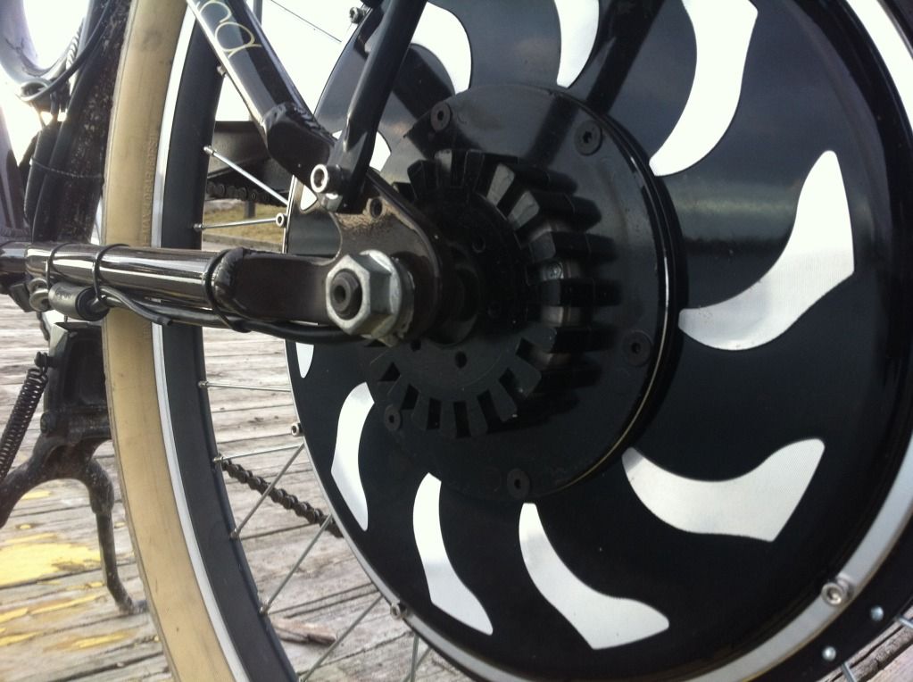

One misconception I would like to clear up is the "built in fan"
There is no fan inside the motor. Please take a look at this picture of my back wheel. The Smart pies and Magic Pie 3 both use the same controller. You can see the back of the controller through the slots in the cover. This part of the controller is the actual heat sink. If you notice there is a silver screw you can see through one of the slots. This screw is one of six that hold the controller to the wheel. As the motor turns the controller is stationary and this screw will always be in the same place. The slotted cover spins with the motor and this is what GM China calls "Built in fan". Is this a fan? I suppose. One thing for sure, it is certainly an improvement over previous Internal controllers for dissipating the heat.
Gary
