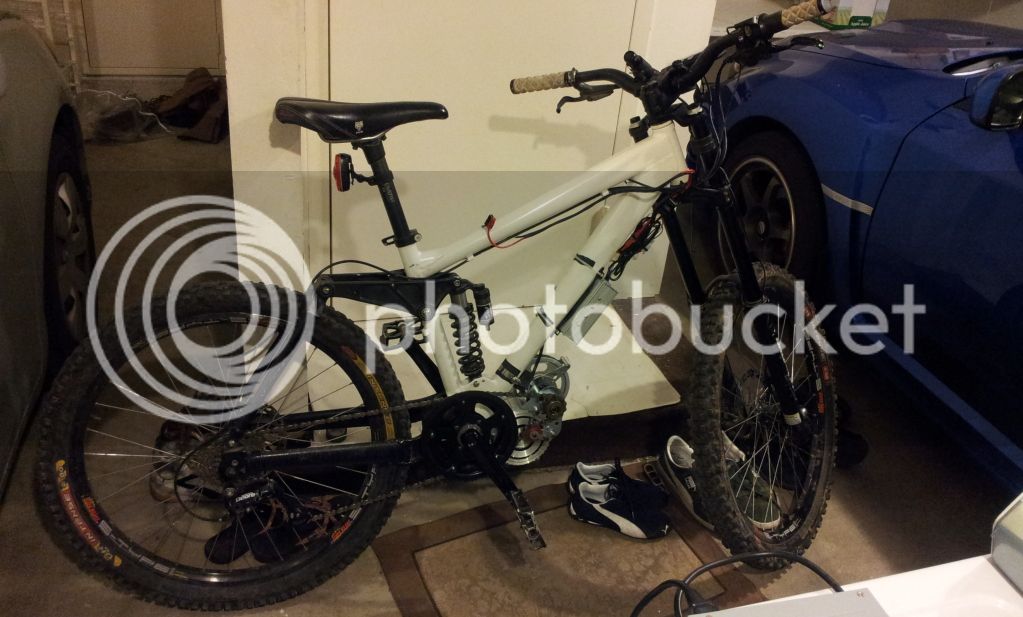

Decided to go with the GNG 450w brushless mid drive.
At first, stealth was a concern, but my bike already attracts a whole lot of attention. This will probably be a lot more, but I'm willing to deal with that.
Anyhow, I've gotten everything working except I managed to strip the threads on the crank arm that goes into the front freewheel. :( I still have engine power, but zero human power. I ordered a new freewheel crank, bb, and crank arm. If that can't hold up to my pedaling like this previous one, I may just use the mid drive as a pedal assist and run no front freewheel.
Pictures to come...

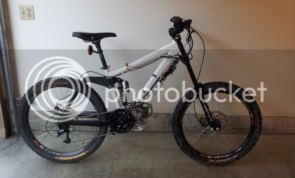

This is pretty much what I started off with.
Initially, I wanted to go with a hub mounted motor for the stealth aspect; however, a handful of things made me more curious about mid-drive systems. Stealth was pretty much thrown out the window shortly after I started taking my bike on the train. Random people would just ask me questions about the bike most likely due to it's dual crown tripe fork. Also, e-bikes are allowed on MetroLink trains. Anyhow, after seeing a handful of GNG builds, it seemed rather affordable.

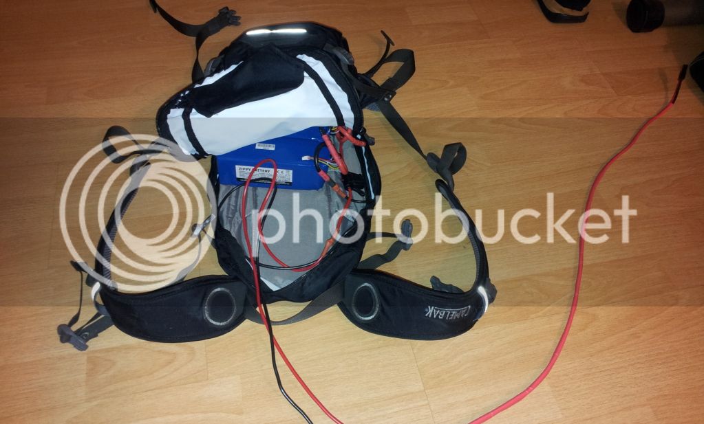

I never decided to go with this battery set up (5S1P 4200mAh x3).
After further research, I should've gone with two LiPo 6S batteries run in a series as Dogman had recommended. Unfortunately, I had already ordered 5 8400mAh LiFePO4 batteries with a Turnigy Mega 400 V2 Charger
I will probably end up getting LiPos later and running a pair in a frame bag.

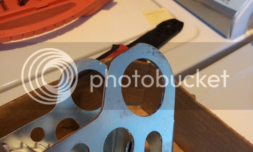

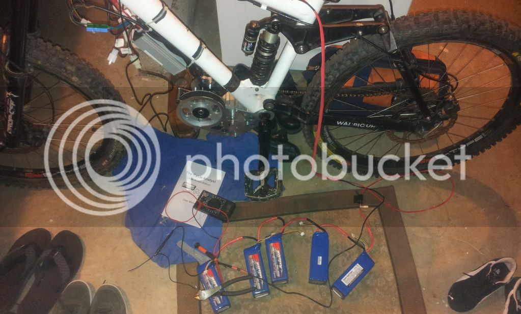

Install was pretty straight forward. I had to modify the mounting bracket to clear my swing arm.
After modifying the bracket, I noticed the motor was actually hitting the frame and there was a little over an inch distance between the front mounting bracket and the frame. I remedied this by using the chain guide from my Black Spire chain guard/guide wrapped in some inner tube. I used pieces of intertube to keep any clamps or ties from directly coming in contact with the white powder coat.

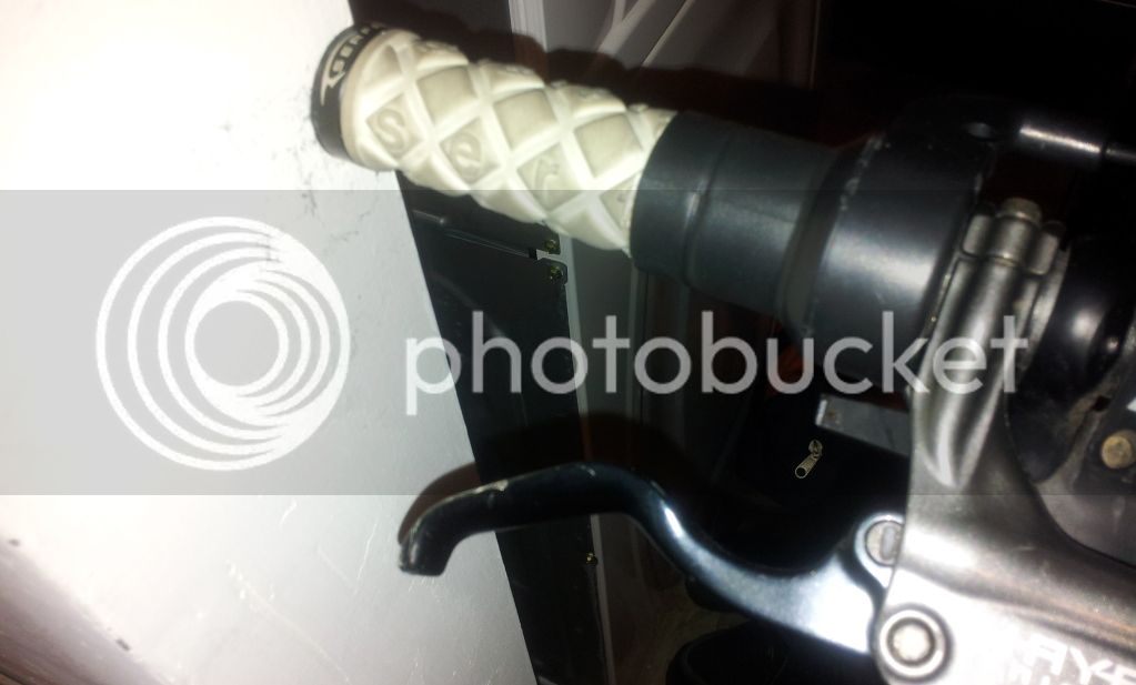

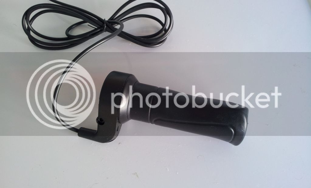

The kit came with a POS grip throttle that wouldn't clear my Shimano Deore Rapid Fire shifters unless it was upside down. I decided to make it into a half grip throttle, and I cut the index finger shifter to clear the throttle housing.

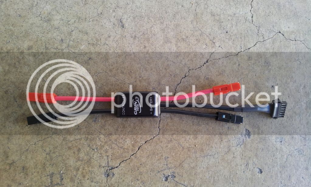

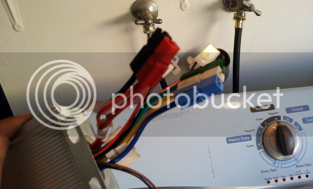

Since I'm only running 20A max, I decided to use the 15-45A Anderson Powerpoles. I was going to use the 5.5mm bullet connectors at first, but soldering them was taking forever.

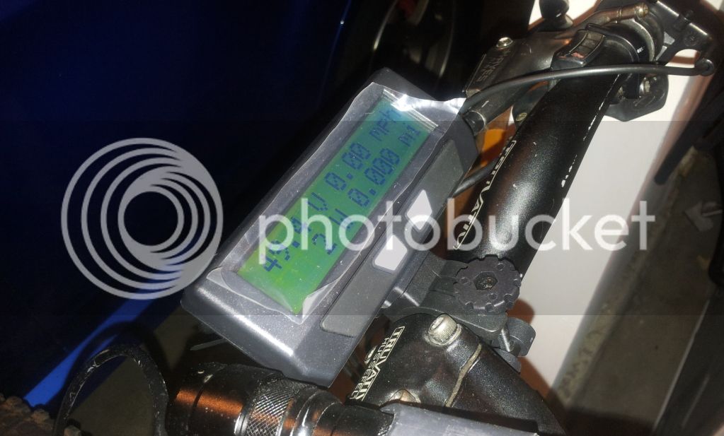

Though a bit overkill, I really like the features of the Cycle Analyst, so I picked up one of the stand alone models. I set the low voltage cut off at 44v which is on the high end of what they recommend for 48v systems. I've read up on too many conflicting low voltage cut offs for LiPo/LiFe set ups, I just wanted to be on the upper end of the spectrum. I also have it limiting my max A at 20 since the controller's max is 22A.

The reason why the crank is off is because earlier that day I was riding around on just human power and managed to shear the threads off the drive side freewheel crank arm (-_-!)
I can still ride under battery power, but pedaling does absolutely nothing right now. I already have a new freewheel crank, bottom bracket, and crank arms coming. I hope this doesn't happen again.
For now, I'm running the batteries from my CamelBak with an umbilical. I have a 20A fuse on the harness I made for the battery pack. I'm using 10 gauge wire which is probably overkill for the power my system is putting out, but it's always better to be safe than sorry. I'll probably end up running LiPos in the future off a frame bag.

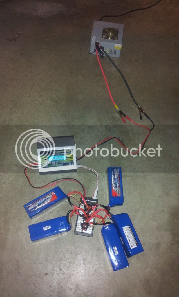

dnmun said:
how can you balance those cells without a balancer or a BMS?
Doesn't that charger in the pic have a balancing board and leads coming from each cell? Kind of like a LIPO setup for LIFEPO4?
My parallel charging board has ports for the balancing leads on each battery.
It would have been way cheaper to convert all my batteries to the Anderson connectors and buying a parallel charging board with stripped leads.

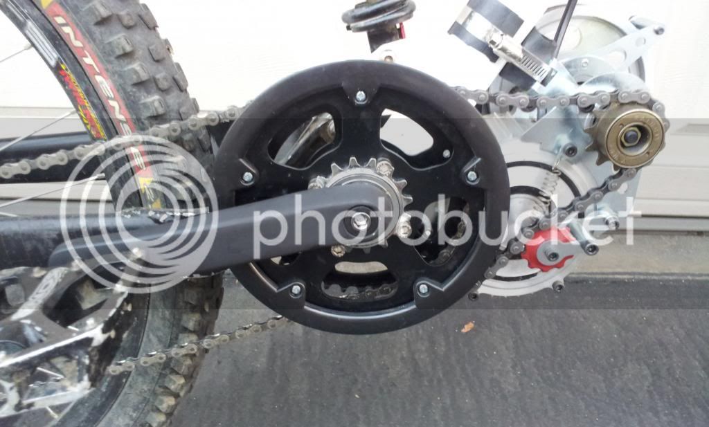

Now here's where I ran into some issues. The new crank arms, beautifully beefier than the GNG ones, sit out much further on the bottom bracket spindle (7mm about), so the chain line is waaaaaaaaay off. I was able to line up the chain by putting the freewheel on the outside of the chain rings and using 6mm x 16mm hex bolts and flat washers.
(pictured w/o washers on the hex bolts and w/o chain tensioner spacer replaced with washers, but you get the idea)
Even though the chain line matched up with the motor, the chain still fell off. I noticed that the chain tensioner, when torqued down wasn't aligned to the motor sprocket freewheel (opposite side of the belt). This may have been when I torqued down the sprocket a little, but I doubt it. I removed the spacer for the tensioner and replaced it with 3 flat washers, and now everything runs smoothly. I've even been able to take it to work. :D
I'm curious if anyone else has had issues with the chain tensioner not lining up with the motor sprocket. :?:
Now here's my dilemma: This set up ^^^ is more than likely going to fail. :x That cheapo freewheel mounted on the outside is not destined for greatness. I suppose I will use the replacement GNG crank arm and freewheel when it arrives, but I'm not too thrilled about doing that. Others with GNG kits seem to be looking for alternatives. I may order the sickbikeparts freewheel, 44t freewheel chain ring, and 4 arm freewheel spider and make my own set up. I've been emailing Jim from sickbikeparts, and he states the standard freewheel is probably a better option than the heavy duty one:
Looking at your application I think actually our standard freewheel is a better option. The HD freewheel is much better in that the pawl mechanism is superior but it only has one bearing and due to your application of the motor in front and rear wheel to the back that will create a nasty twist on the freewheel. Because of this the HD freewheel is not the best option. Our standard freewheel works better in these applications. The only time the pawl mechanism is in play is when you are pedaling. When the motor is running it is only acting as a bearing. That is why you don't need the better pawl system. We need it because we use the pedals to start our gas engines and that puts a lot of force on the pawls.
skyungjae said:
Now here's my dilemma: This set up is more than likely going to fail
Yep. Your next problem will be the bottom bracket spindle bending. I've ordered Truvativ Hammersmidt BB and will get ISIS crank arms. Already got WI FW. Will let you know if it works.
Nice build BTW

That sounds awesome. I saw some ISIS cranks... then I thought about how the whole point was to keep this project cost effective. The "buy once, cry once" has already gone out the window in my build. :lol:
So I'm thinking about pulling the trigger on making my own freewheel setup with sickbikeparts parts.
As in my original post, I'm looking more for torque/climbing power and not necessarily top speed.
The basic set up (from what I've gathered here and not literally counting) is a 12t jackshaft freewheel (motor), to a 44t (outer chainring), mated to a 38t inner chainring, to my Shimano HG-50 Cassette on the rear wheel (most likely the 11-34, but could be an 11-32).
If I go with a 48t outer chainring from the 12t jackshaft freewheel, and use my 32t Blackspire inner chainring (since the GNG 38t is proprietary) will that take some stress off the motor and potentially give me a better torque set up?

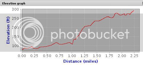

I haven't done any flat terrain range testing, but I don't see the point in doing that. The heavy downhill bike itself; the soft, full suspension; and 2.5" wide downhill tires take up so much of the energy. Getting to work and back isn't a problem depending on how I ride. I haven't done the entire Fullerton Loop yet (just the fun parts), but I'm not too sure if the battery would last the entire 11-12 miles of it.
(Before the the incline at mile 1, I am riding on a dirt path where the terrain can get kinda rough.)
This picture is the elevation changes on my way back from work. Going to work is mostly downhill, and if I use the motor, it's just for speed. I do plug in the battery to log miles though. If I ride conservatively, I can stretch the pack to last me three days. That means I'm only using the motor on steeper inclines with very low wattage and a high torque gear. I don't get home any faster, but I'm not dripping sweat when I'm opening my garage door.
On the other hand, if I'm riding like a bat out of hell to and from work (using the bike on the flats and hills and maintaining a good pedal assist speed [10+ mph], I will go ahead and charge the battery when I get home.

Charging my pack is pretty quick. I love my Turnigy 400w and 550w power supply. The power supply is a bit weak for the charger, but I can charge at 10A without the power supply shutting off. From the low voltage cutoff to full charge at 10A is only 30 minutes, pretty good for those 5 batteries in parallel. When I'm doing the balanced charge, I charge at 5A and it takes about an hour. Regardless at what rate I charge the pack at, the performance remains the same. Pulling the pack off the charger and hooking them up in a series will always read out about 49.5v (+/- 0.3v). By the next morning, it's always showing 48.5v.
As for the crank solutions, as many have stated, the double chainring freewheel supplied by GNG doesn't rotate true, so there are loose spots in the chain on the 12T freewheel to the 44T larger chainring. The bike is operating... more or less... consistently, but the way it's rigged up still bothers me. I ordered the Freewheel Spider - 4 Arm 104 mm, Freewheel Oil, Chainring - Freewheel - 48 Tooth w/chain guard, Front Freewheel, Freewheel Removal Tool, and a Single Speed chain from sickbikeparts.
I also pulled off the 12T freewheel on the jackshaft and took some measurements. There was a bit of confusion regarding the diameter (some people saying it's 10mm). It is 14mm in the center, but the keyed part the freewheel attaches to is actually 11mm with a key nub. The length of the output shaft is about 22mm long. I decided to pick up an adapter for 11mm keyed jackshafts from BikeMotive to use a 30mm x 1.0 BMX freewheel, and also ordered an ACS Crossfire 13T to mount on it. The gear ratio from motor to chainring is the opposite of what I wanted to do, but it'll give me more freedom with the chainline (motor to chainring). There's also the added benefit of readily accessible replacement parts.
This setup should work if I decide to go with ISIS cranks down the road. Though the bottom bracket spindle is super long, I'm not to worried about it bending as my cushy suspension takes a lot of the force.
