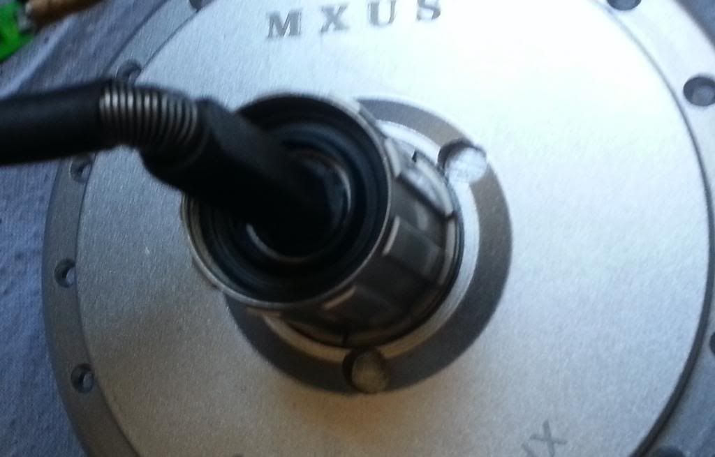

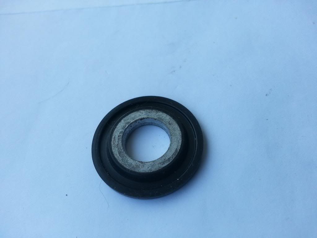

In the photo of the two motors, it looks like the Q140 is wider, but the clutch is away from the side-plate. Were there actually any differences other than the side-plate. It also looks like the stator is narrower on the Q140. Is that just an abberation of the photo?
I have cassette versions of the 350w MXUS, and to me it looks like they messed up a bit. They included an extra seal over the cassette outboard bearing, but they didn't provide the correct spacer for its inner lip. The resukt is that the seal's lip is trying to seal on the nut that half sticks out of the cassette spline. It caused drag like in your video. Given that these Chinese companies all copy from each other, it might be worth looking at yours in case it's the same. Here's a picture of the seal and the missing spacer (18 x 12 x 3 mm), which I took from a BPM motor. You don't need the seal because the bearing is sealed:
lollandster   10 W
Posts: 86
Joined: Sep 15 2012 1:50pm
Location: Norway
Re: New Cute Q100 replacement? The Q140 CST
Post by lollandster » Aug 07 2013 7:38am
d8veh wrote:In the photo of the two motors, it looks like the Q140 is wider, but the clutch is away from the side-plate. Were there actually any differences other than the side-plate. It also looks like the stator is narrower on the Q140. Is that just an abberation of the photo?
[pictures]
It doesn't look like they've done that here:
After having a second look at the motor with the chain rings on it I can see that I'll need a washer at about 1.5mm thickness for it to work without having to adjust the dérailleur.
For the build I'm doing now I think I'll just use the front Q100 to keep the weight balance center until I find time to build a frame mounted battery. It will be good wall decoration in my garage until then.
The motor is 201rpm@36V, I can do a no-load rpm reading if anyone needs it.
