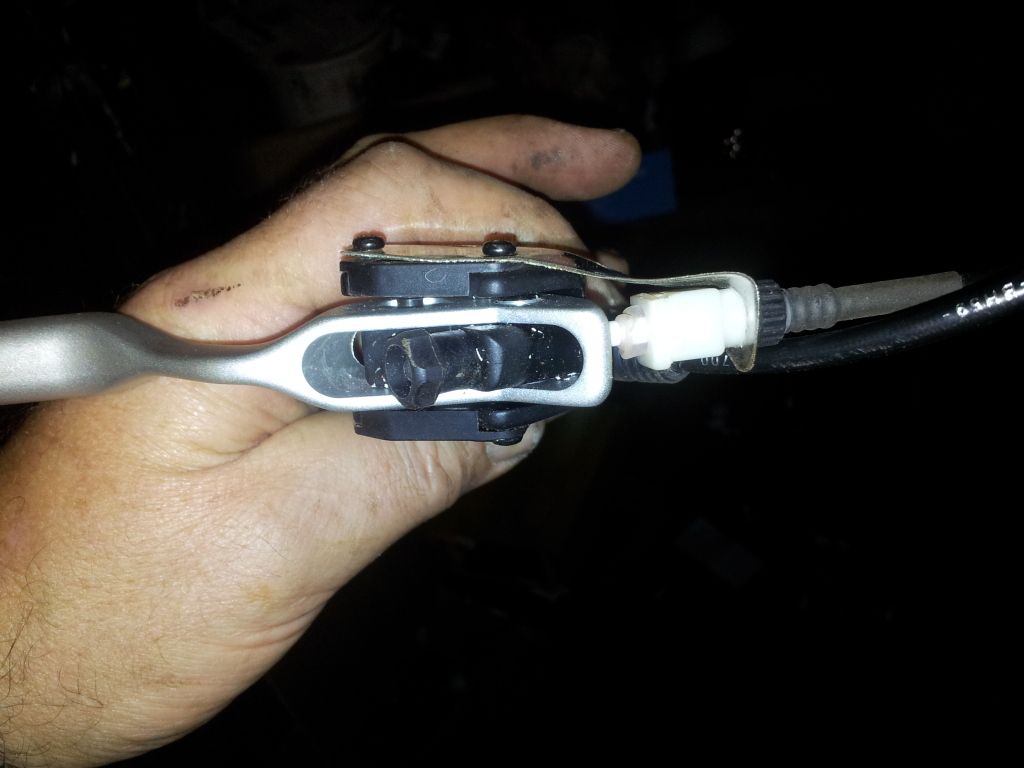

Hi, I have hydraulic brakes on my bike and want them to be used as cut-off brakes, but don't want to pay so much money on production brakes (they are about £50 each), and I refuse to switch to mechanical.
So I was wondering: Could I take the switch out of a cheap pair of e-brakes and glue it to the bottom/inside of my existing brakes? A sort of E-Brake conversion?
If anyone has any ideas/images of the switch in an E-Brake/has done this already, please post it here.
Thanks, Matthew.

Inline switch, magnetic switch, independent momentary switch, all easy ways to fit regen to your hydro brakes.
Then, Tektro are making a switched hydro brake lever for a good price. Even easier. :wink:
I have the Magura bionx pressure switch and they work well.
You can get them from the EU. I have one that I could sell since I bought 5 last year. $55 shipped in the US. PM me if interested.
The chepo ebrakes just use a small push-to-break switch. I took one out and used it on this hydraulic brake by making an additional bracket, but it doesn't fit most. Click on the photos to see the whole thing:

I think d8veh has the solution I was looking for; I was getting a kit that came with cheap ebrakes, and wondered if there were a free solution since the elecronics were already there.
Thanks d8veh!
